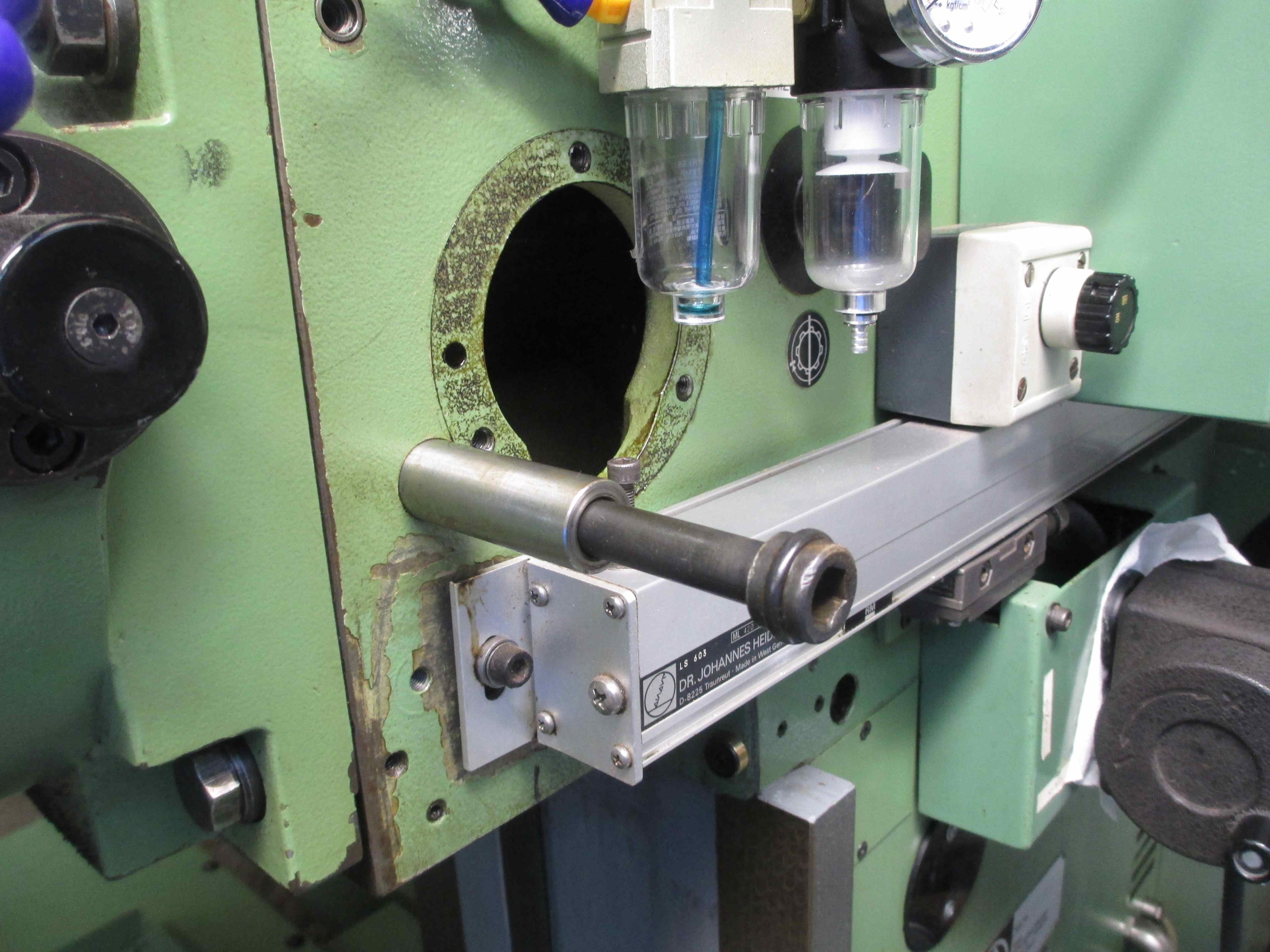

There is a black round side plate on my machine that allows access to the horizontal quill clamp.See attached. I some cases they have another quill handle there which would be handy for manual use. I unclamped mine but the quill is stuck with what looks like old oil varnishing.
I'll have a look, if I get time, to see where the hydraulic hose goes. I suspect it will have the same rotary joint as the Z quill. It will need disconnecting there. There will also be an anti rotation/ travel stop pin somewhere.Then the whole quill will need to come out.

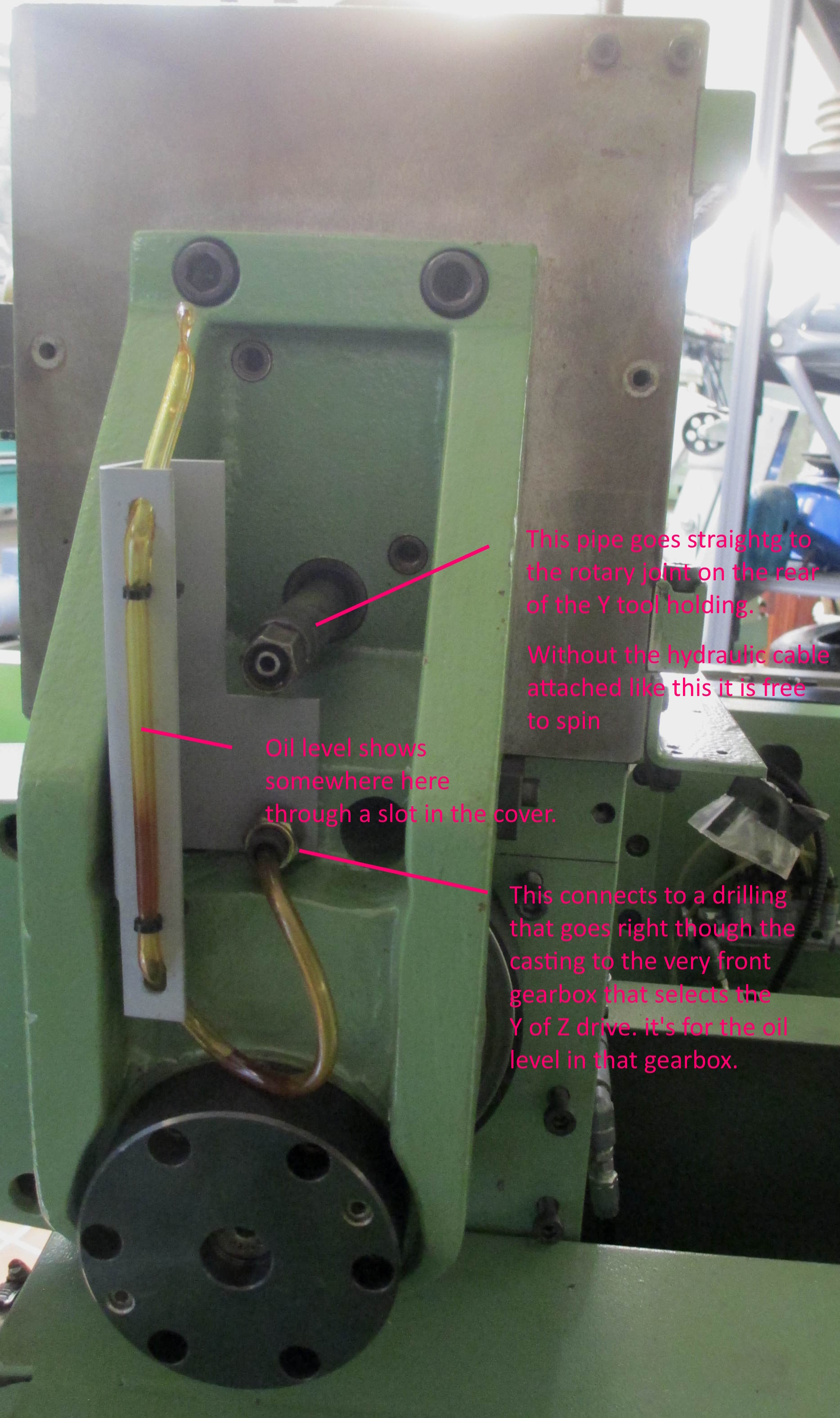

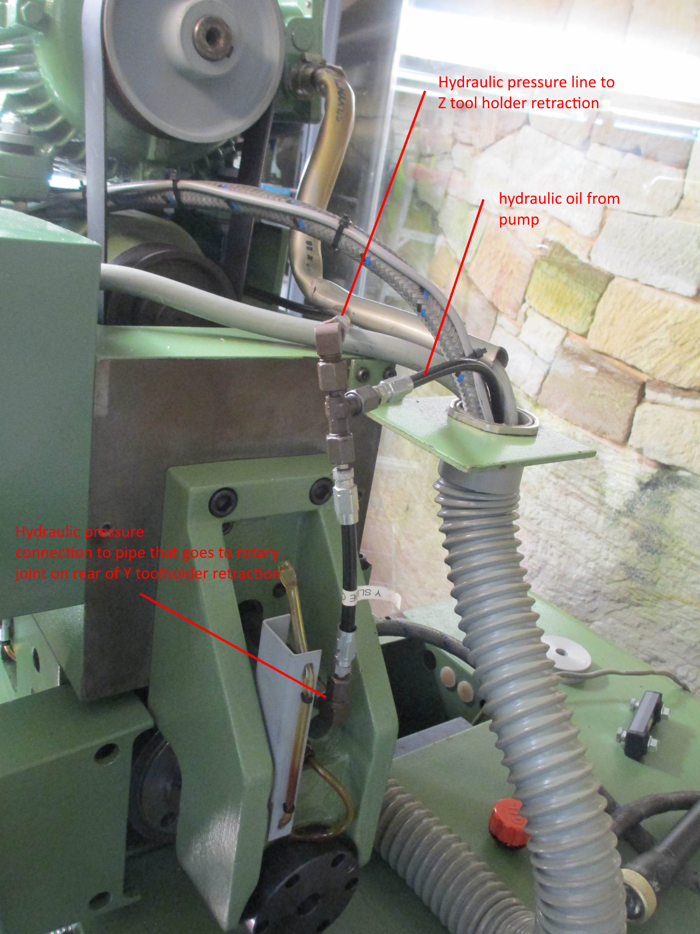

Here are a couple of photos of how it connects. I had them in my archive. You need to take off the rear spindle motor covers. The incoming hydraulic pressure hose comes up the rolling conduit. Then you get the birds nest shown. You can see how it splits to the Y and Z tool holder retraction. The pipe you see sticking out of the casting when you have the hose disconnected is free to spin easily. You can see the drilling hole through the top slide is big enough for the pipe fitting to travel through. So I'm fairly sure that if you disconnect like this then you can just pull the whole quill assembly out through the front as I described previously, being careful not to break that pipe. It looks like the long length of pipe simply cantilevers off the rotary joint in the Y quill. I remember thinking it feels like it when I turned it. The hoses hanging around there are all that holds the pipe from spinning when the hoses are connected!
I don't know how to pull the Y quill out. There is nothing to grip on. I could fit a tool holder perhaps, but pulling on that pulls on the retraction claws. Maybe a gentle pull to see if it works.
The other small tube is a sight glass tube for the very front gear selector that engages the Z spindle. So it isn't anything to do with the hydraulics or the Vogel lube system. That gear case is filled via the front orange filler plug. On mine the very long drilling to the sight tube was clogged and it took a lot of rodding out to fix. It's hard to read through the sight hole on the cover when fitted, and a small tilt on the machine would make it misread. I would simply drain and refill the gearbox with the amount in the manual. If you take it's top cover off you can't see the oil. It's down below the gearset in a cavity, but the lower part of the gear dips into it.
Cheers,
David

Sorry, this photo didn't attach to the previous submission. It was a bit big.
Cheers,
David
Cheers,
David

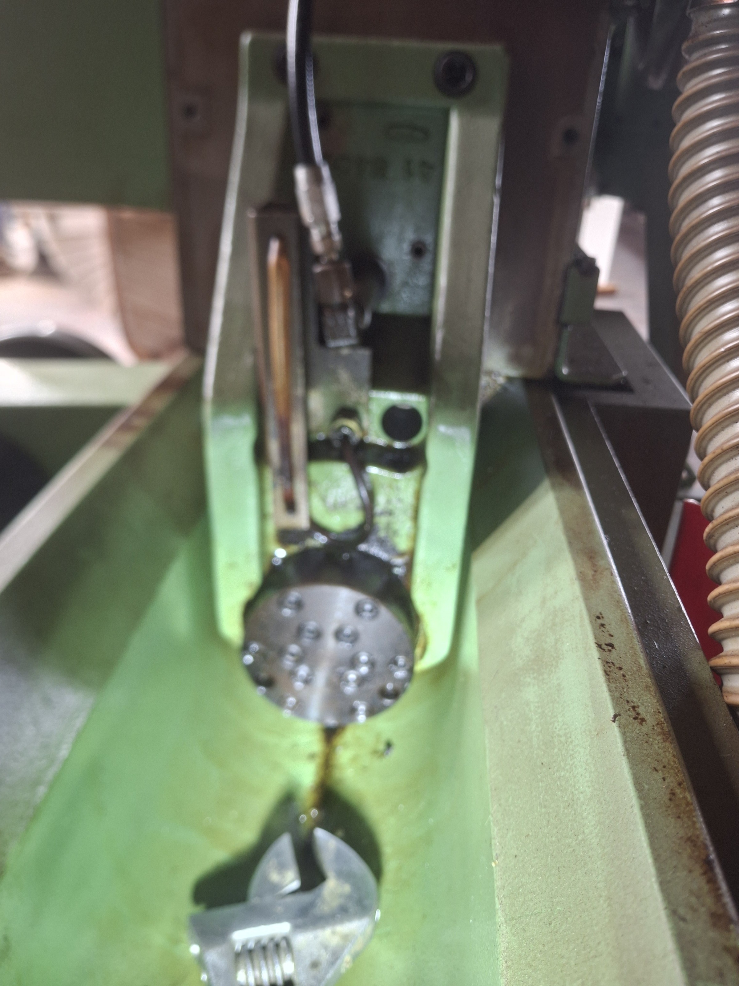

Trial photo Kind regardsChris

Focus is a bit off but it's exactly the same as mine. If you disconnect at the elbow you will see what I mean about the tube going to the rotary joint being free to spin.
The way they are set up means you couldn't extent the Y quill for a special machining set up as the elbow would jamb on the rear of the Y slide.
Maybe you could shine a torch down the hole to see if there is anything else stopping the tube pulling out with the quill.
I haven't had a chance to figure out if there is an anti rotation slot and pin on the quill. You have to remove the one on the Z quill to remove that quill.

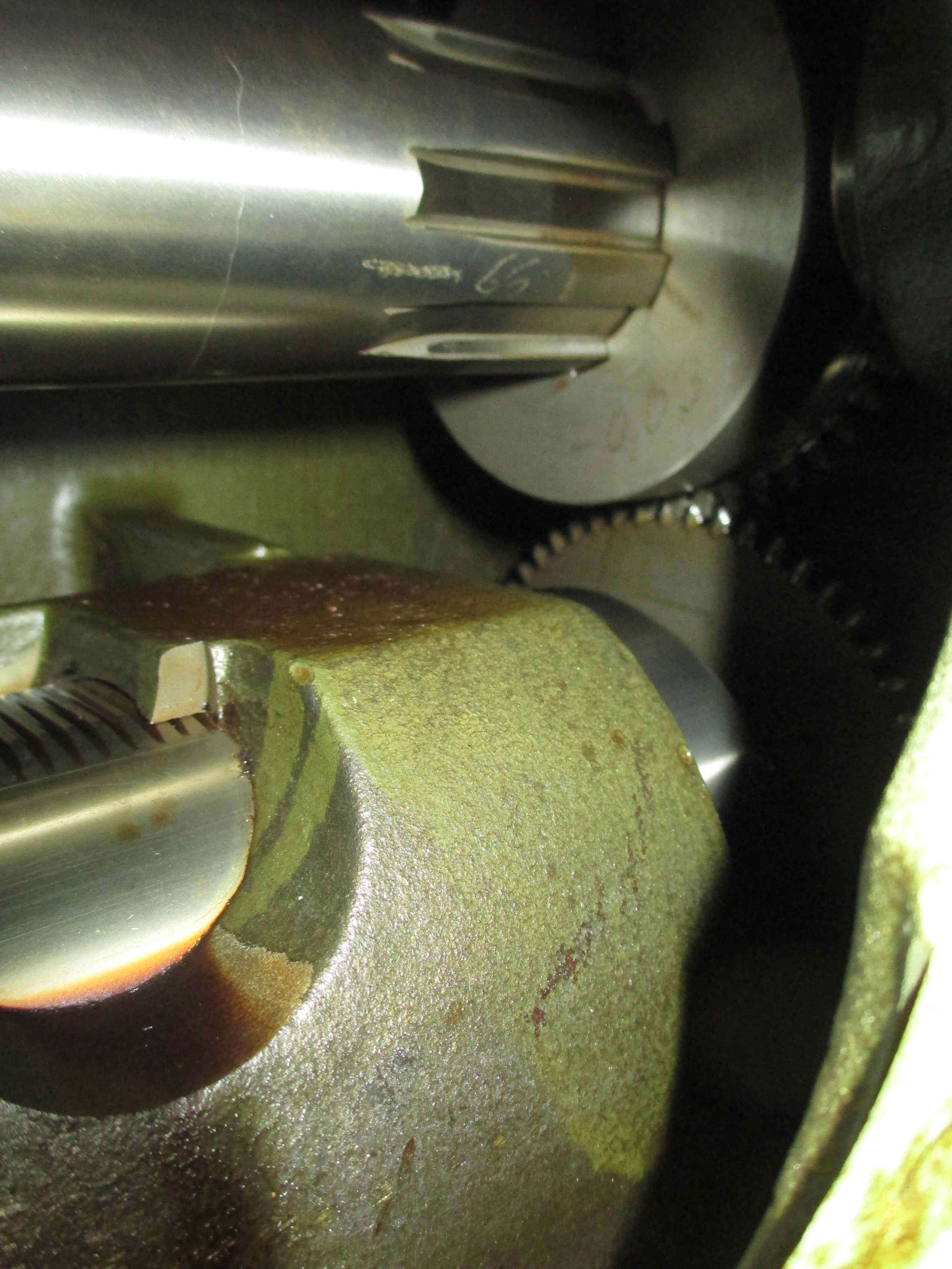

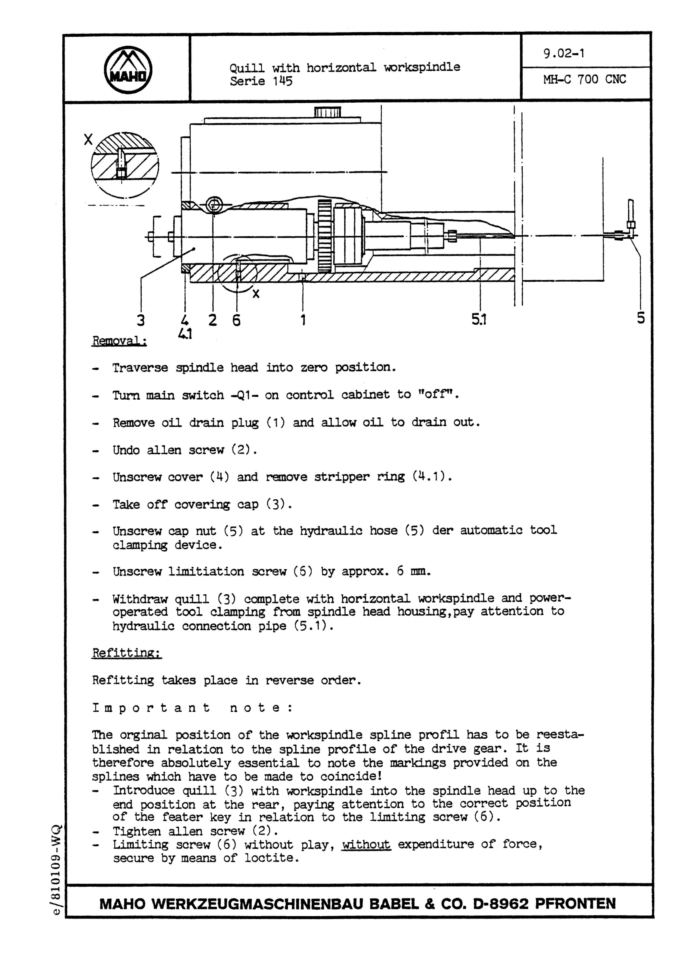

Big note here: Philips and Maho named the axes differently to the current standard, so your manual may have Z and Y swapped. On My machine with the Heidenhain controller the top slide is the Y axis. I redid my manual to show that, but I may have missed a few places.
Looks like we are on the right path. Here is the page out of my manual for it. It looks exactly as I have been saying.
The feather key is item 6. I'd pull it right out in case it catches just retracting it 6 mm in the instruction. That holds the quill from spinning and sets it's maximum travel. It looks like you will have to set the Y axis full forward to get to it. The drain screw is also visible under there.
I'm not sure about Item 2. Mine has a clamping bolt somewhere there. Take the round black plate (from a previous photo) off the side to look in.
I think you will find the quill assembly nearly identical to the vertical assembly.
David

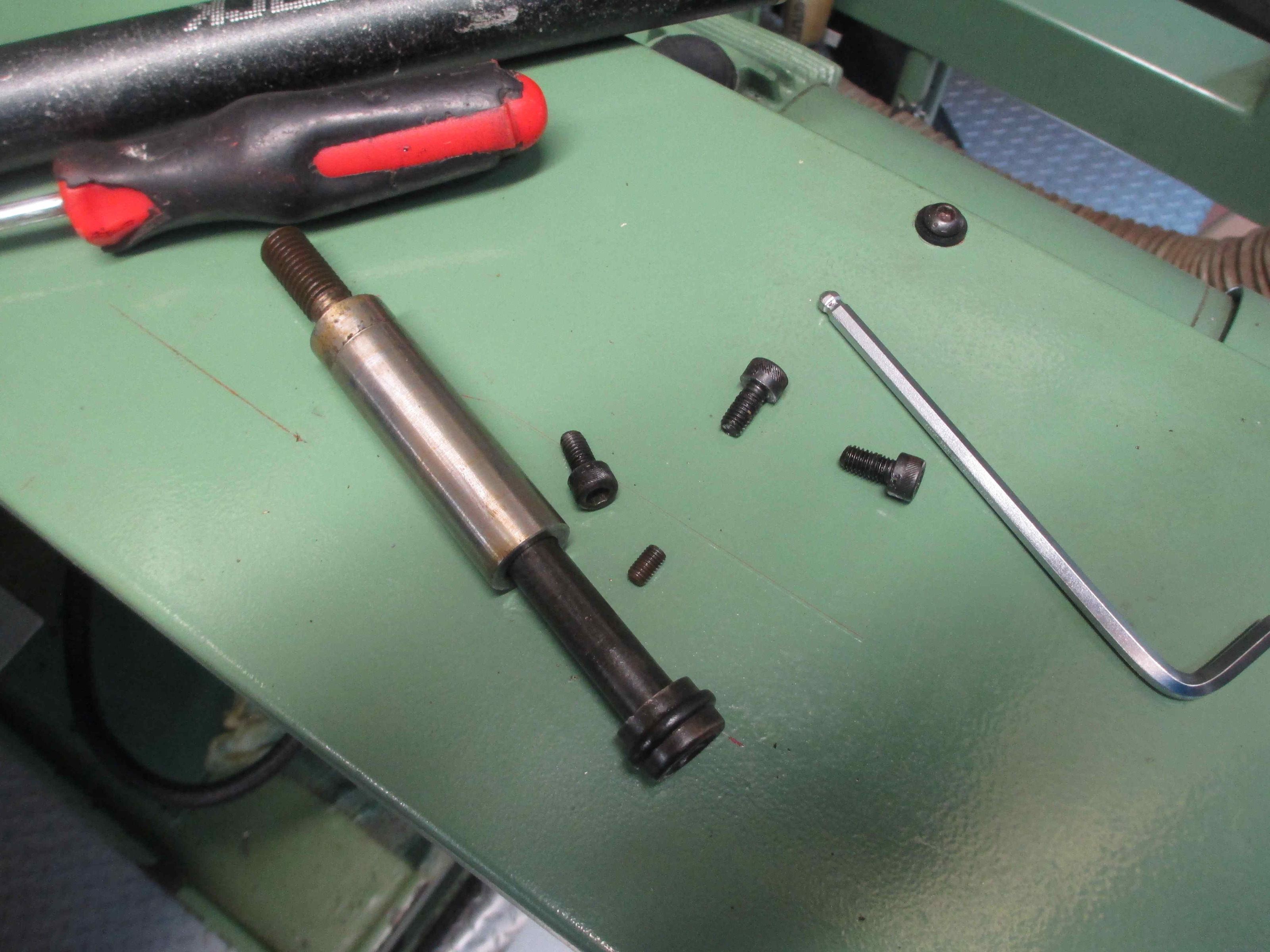

Hi Chris,
I've opened mine and I can see how it works. I suspect the vertical and horizontal quills are identical enough that we could swap them.
The bolt with the sleeve is item 2 on the drawing. If you replaced the head of the bolt with a Kipps handle it would work like the vertical clamping handle. So that sleeve will push on the 2 arced pieces like in my photos on page 171, and clamp around the quill.
You have to remove the cover plug to get to the bolt head. Take out the 5mm grub screw and use a normal 5mm bolt to pull it out.Once loose, the quill should be free. Remember to disconnect the hydraulic elbow item 5 at the rear and the feather key underneath the slide item 6. I would think that the quill would slide without removing the front seal system item 4, but it may be full of dirt like mine.
If you look closely you can see the type of markings on the spline they talk about for reassembly. That's on a different spline though.
Looks pretty easy.
Good luck with it,
David
