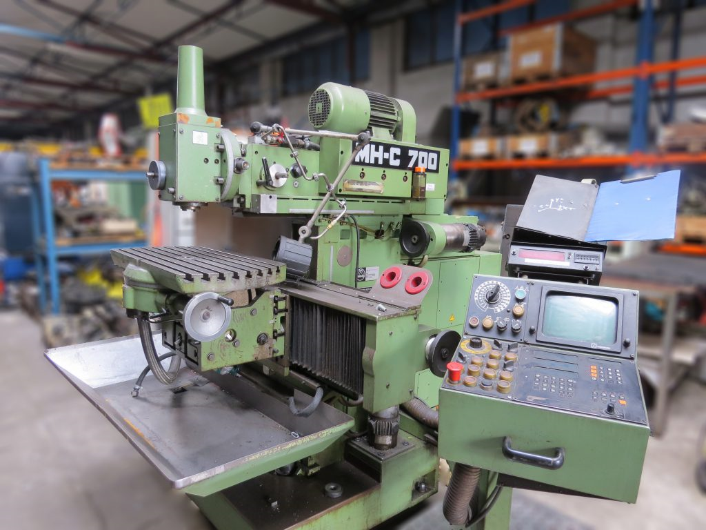

Hi Chris,
I think this completes this:
You can see another build like ours with the hand adjuster on the top slide and the Kipps handle on the quill clamping assembly
Cheers,
David
Cheers,
David

Hi David
Sorry I have been away for a few days
Thanks for the photo and the description of the Z hydraulic pipe work .Now I am back on the job. I am reluctant to dismantle the Z hydraulic spring loaded tool gripper as I simply don't know what I am doing and risk damage to the unit. I will have another look tomorrow. I can remove and adjust the gripper but I cant get to see the spring washers and they could be the problem. Further the Z tool changer worked before I renewed the spindle grease so it has to be something I have done.

Hello David
Yes I have had the spindle our several times and lubricated the bearings with the special Kluber grease. The hydraulic unit comes off no problem but I cant get to the spring washers
On mine the very long drilling to the sight tube was clogged and it took a lot of rodding out to fix. It's hard to read through the sight hole
I will check this out. Thankyou
Cheers Chris .

Replied by D Jensen on topic Retrofitting a 1986 Maho MH400E
I did recall you said you would be away.
I'll have a quick try on mine by simply loosening that clamp bolt. I didn't realize before that is all it takes.
With the hydraulic pipe elbow removed the assembly should come out whole.
Then the only tricky part was warming the thread on the hydraulic ram so the Locktite came free.

David
Yes and mine has the hand adjuster on the top slide same as the one in the photo
Makes it easy to adjust the Z spindle.
A photo would be nice. If I pull the quill in my top slide forward, it would break the hydraulic pipe at the rear elbow. It would be nice to see how your one allows movement. It's too blurry in your photo.
Before you remove the hydraulic ram you have to remove the screw in the clasp claws and unscrew the claw assembly. The when the hydraulic ram is removed all the springs come out with the ram. Maybe you draw rod is broken?
I'm wrong again. It occurred to me that if your one has the hand wheel on the top slide then you will have to pull that whole assembly out before pulling out the quill as the rack teeth don't go the full length of the quill. I don't know how you do that on your version and my manual for the vertical quill didn't have an explanation that there was a scotch key retaining it.
