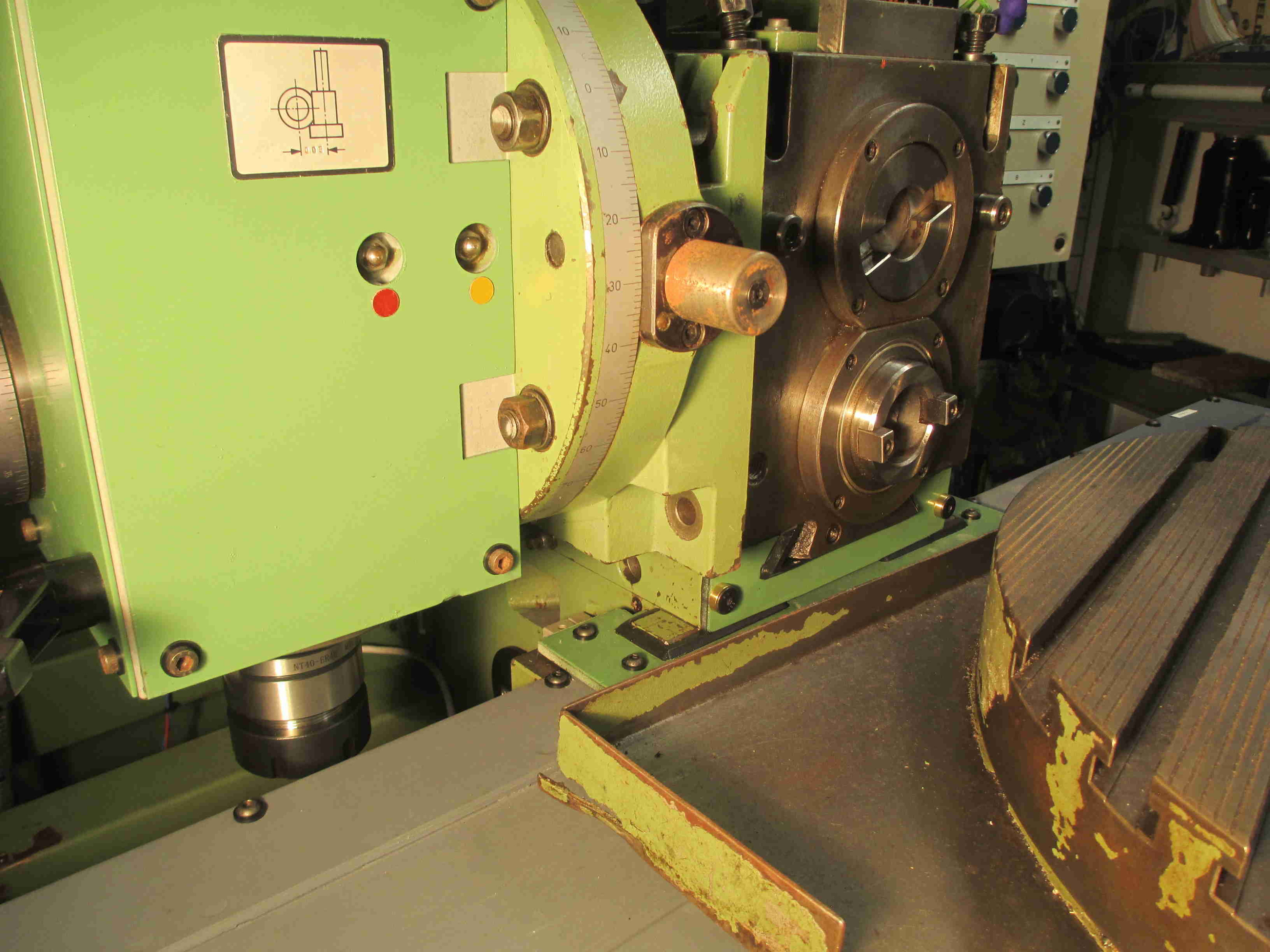

It's and area that makes my head swim. But it seems to me that the method is really just about making the quill square to the table. The vertical head on our machines only rotates around the Y axis, but on many Bridgeports it can also  rotate around the X axis. In that case you could use the device to make the quill perfectly square to the table. But you could also tilt their table to any angle (some can do that) and tilt the head to be perfectly square to that using  your device. Then you could use the quill to drill nice holes. You might do that to fit an oversized object perhaps? But it would do nasty things to the drill if you moved the knee while drilling. An extreme case example. Feel free to call me and idiot if I'm seeing it wrong.
My machine has that nice taper roller grinder style quill, which has a slight preload. So no looseness, but it will still have non repetitive run-out errors due to the various manufacturing errors in rollers etc.
On my machine you can see there is a detent knob on the head tilting. It clicks home at zero degrees on the tilt dial. When I put my dial clock on it then and swing it I get almost perfect alignment in the X direction. Big surprise! The head rotation clamps just like yours but with 4 bolts. You can see they scribed the zero mark on the head after they did the alignment by the missing paint.

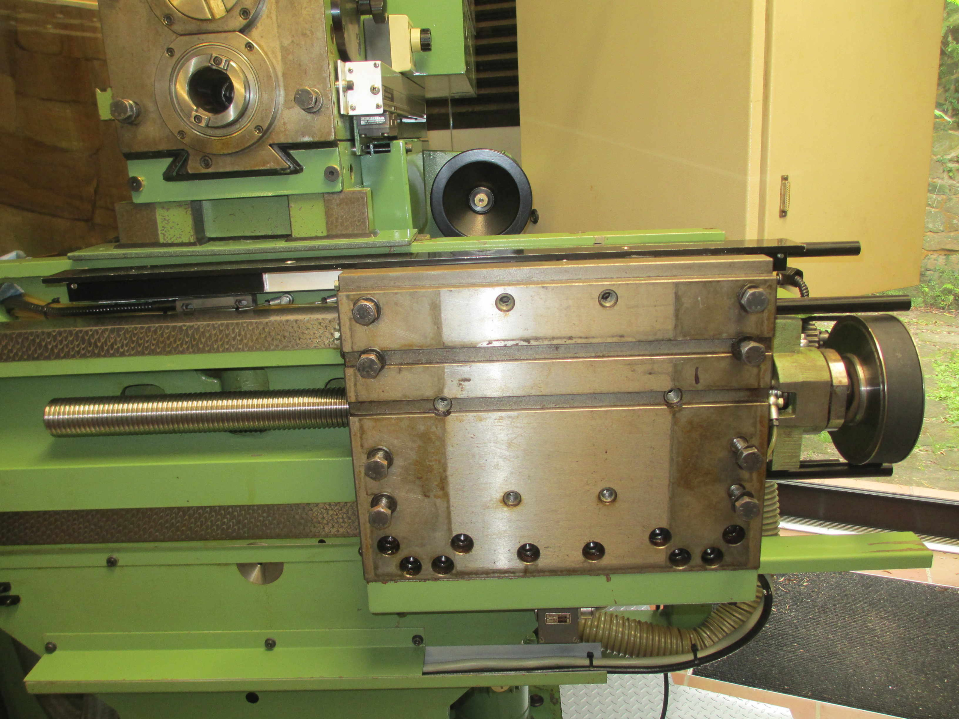

I've added a photo of when my rotary table is removed. You can see the 8 bolts that clamp it on (so I don't misplace them). There are keys on the rotary table that fix the tilt when it's assembled. You can see it's not a dovetail system. I suspect I could align the table sag by removing that array of bolts along the bottom and putting shims between that X slide and the bearing rails.
