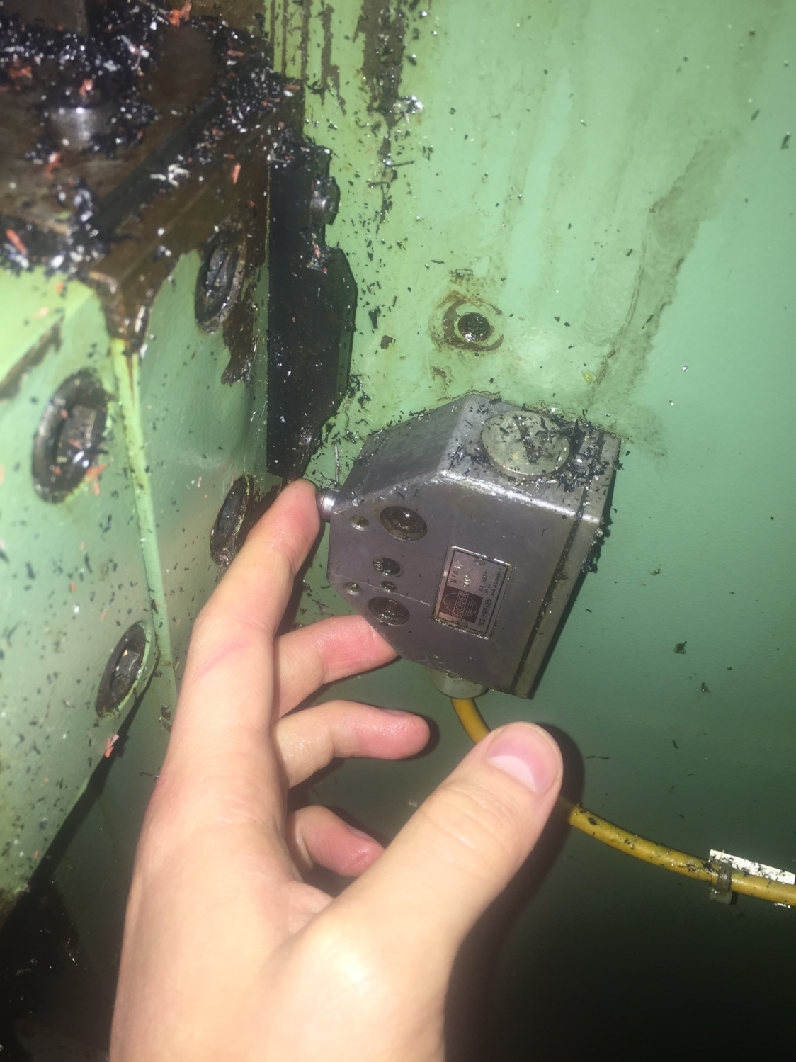

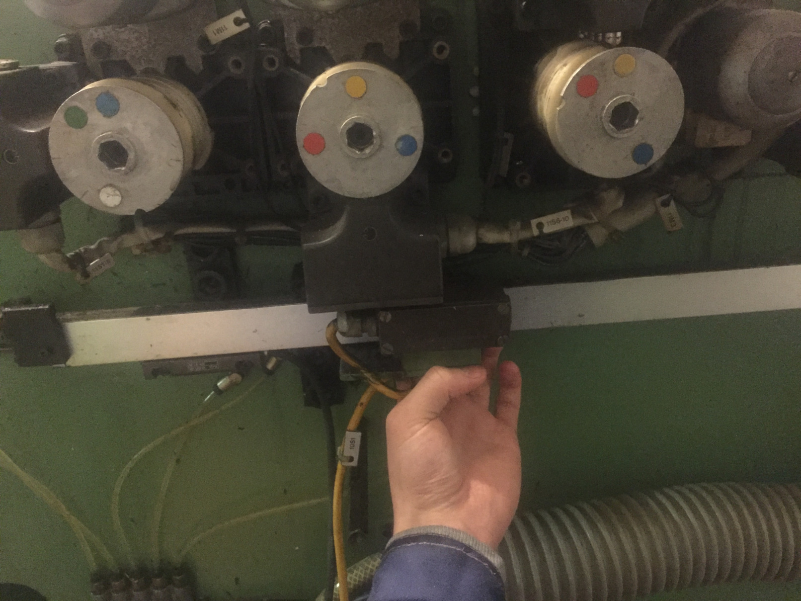

14 May 2019 18:08 #133781
by Glemigobles
Replied by Glemigobles on topic Retrofitting a 1986 Maho MH400E
If anyone else ever wants to test the limit switches on their MAHO MHXXX, mine has travelling push-button types of switches which physically press when they reach the axis limits. So instead of actually moving untuned axes around, it's far easier and way less stressful to just take off the covers and push the button with your finger. In my case, all three estopped correctly. I'm attaching pictures.
The X axis switch is located to the right of the X motor, under the cover for the ballscrew. The button faces up.
The Y axis switch is below the gearbox, its button faces towards the machine. You need to remove the cover with the holes that show the gear positions.
The Z axis switch is behind the largest cover that houses the two hydraulics pumps. It's the easiest one to reach with your finger.
Just press the button to simulate it hitting the axis limits, as far as the machine is concerned there's no difference.
