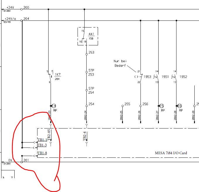

Do I measure it with ground on TB1 (like I would power on TB1)? If so, an enabled empty output pin reads 0V.

Yes measure from TB1.8 ( note you should remove the I/O connector to measure 7I84
outputs as the screw does not reliably contact the output pin unless tightened )

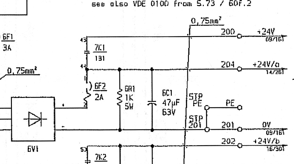

Why the Meanwell 24V PSU? The MAHO has three 24VDC buses?

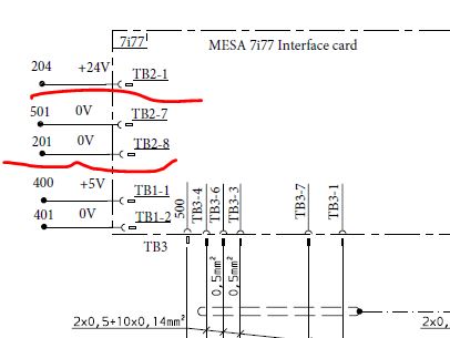

15 May 2019 20:43 - 16 May 2019 06:33 #133906
by RotarySMP
I power the 7i77 and the 7i84 from the 24VDC Bus 204 (+) /201 (gnd) as this is the bus which is always powered. The other two 24VDC buses only power up once E-Stop is released.
As you can see I chained the 204 to both the two field power connectors on the 7i84.
One issue I has was that my 28A1 Relay panel had a bad contact on that bottom row of connectors. I had random failures where the MESA boards wouldn't power up. I traced it to the green terminal block at the bottom of the board which has the terminal 204 connection. Pulled, cleaned the contact and re-seated it, and haven't had any issues with that since.
That can't be your issue though, as that should take done both 7i77 and 7i84. I think you have a config issue with your 7i84. Can you see it's I/O pins in the HALshow? If you put you voltmeter on outpin pins and command a state change, can you see the switch in voltage?

Okay, I took off the connector, set output 15 to true and measured it against TB1-8. It reads 0V. This is using just halcmd, with loardrt hostmot2, then loardrt hm2_pci.
Mark, because to a large extent I don't really understand what I'm doing. I thought you took that 24V power from the disconnected pendant terminal block, and since I thought I wanted to keep it I decided I'd just buy a second PSU. I have very little wiring experience and wasn't sure how to connect to these buses (also b/c I can't read these diagrams very well).
