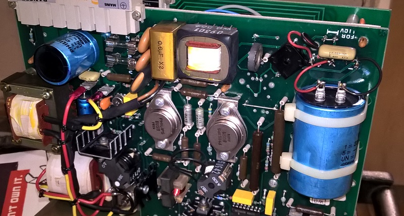

I was thinking that the blue cap with three terminals was a smoothing capacitor for the axis drive, but looking at it on a larger screen it seems to be a 10V-rated item? If so the ESR probably isn't a problem.
Where it would matter would be on the big DC bus caps, those work quite hard.

Well, if the existing caps have the right capacitance and ESR then there is no reason to change them...
You should be matching original spec rather than current spec. Are the original cap part numbers Googleable?

04 Sep 2017 11:32 - 25 Aug 2018 06:27 #98451
by RotarySMP
I thought it was considered good preventitive maintence to replace thirty year old caps, as they tend to fail rather catastrophically. I know in guitars amps this is commonally done, and also picked up that recommendation for the Indramat, from a retrofitter who had one blow, taking out traces on the PCB.
I have no part numbers for the original caps, but wouldn't any of them also be new old stock, and therefore just as likely to have dried out, and be ready to blow?
I appreciate your input on this.
Mark
Mark
Last edit: 25 Aug 2018 06:27 by RotarySMP.
04 Sep 2017 11:38 #98452
Yes, identical parts are unlikely to be much better.
But don't the original caps have part numbers on them in addition to the ratings?
Replied by andypugh on topic Retrofitting a 1986 Maho MH400E
I have no part numbers for the original caps, but wouldnt any of them also be new old stock, and therefore just as likely to have dried out, and be ready to blow?
- RotarySMP
- Posts: 1635
- Thank you received: 595
09 Sep 2017 18:17 #98742
by RotarySMP
The original caps don't have part numbers printed on them. Some have a reference DIN norm.

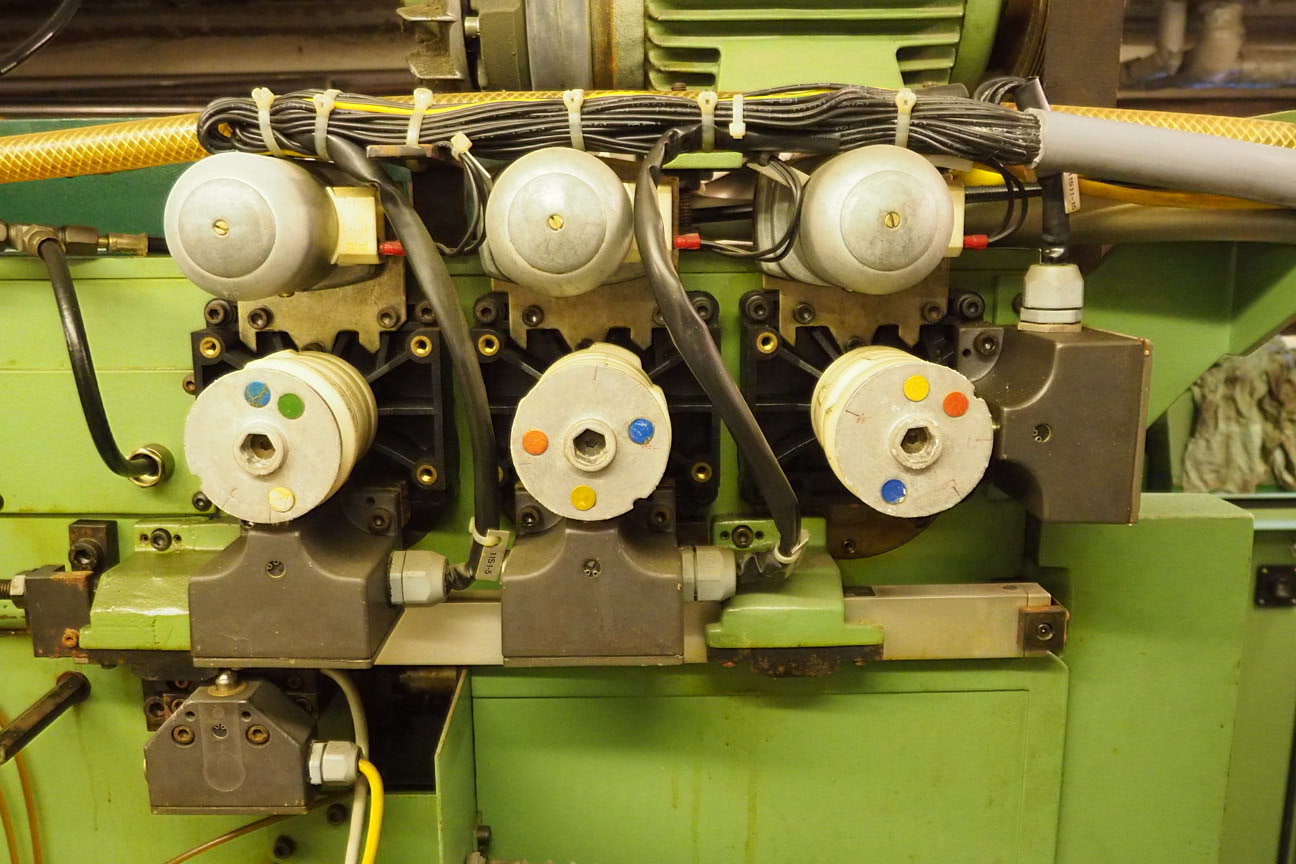

I went ahead and replaced all the caps. At the same time inspected all the boards for dry joints. The only defects were a couple of spade connectors in the Indramat had pulled their blades out of the circuit board when I disconnected them. I cleaned them up and soldered them back in.
Today I finished reinstalling the Indramat boards, and put power on the machine.
Here is a video of it's behavior...
On power up, the monitor comes up, but only with snow/ rolling diagonal lines. The Phillips 432 controller powers up, but I do not know if it boots up and the monitor is not getting the signal, or it is not booting. Either way the monitor is just showing snow/diaganal rolling.
Hitting the hydraulic start button, I hear relays closing, and the central lubrication system activates normally. Hitting E-Stop shuts down the lube unit. Otherwise it shuts down 16 sec after reaching pressure, as it is supposed to.
The hydraulic pump doesn't start. The backshell on the hydraulic unit 5Y1 switch (manual tool release) was broken, so I have epoxied it up. The wiring did not appear damaged.
I guess I'll have to put 24V on the the Hyd pump relay coil 3K1, to see if the relay is stuck.
Any other trouble shooting suggestions would be greatly appreciated.
Here is the photo of the gearbox shifting unit. Three motors, with feedback through cams and switches.
Since I now have the MESA boards, I am tossing up between continuing to troubleshoot the Phillips 432, or just remove it. If I make a few cables with connectors which interface with existing MAHO connectors, I could do this in a non-destructive manor. The main reason I want to get the Phillips working, is to start the retrofit from a known condition, rather than unknown. Especially if the gearbox timing of the software widget db1981 has written is different from my gearbox, it would be good to have video of the Phillips doing gear changes to fine tune db1981's software to.
Mark

09 Sep 2017 18:35 #98743
by db1981
Replied by db1981 on topic Retrofitting a 1986 Maho MH400E
Hello,
optical the gearbox looks 100% identical, I think there will be now differences.
I'm back from tour now, and will get on the Mahos Pc soon.

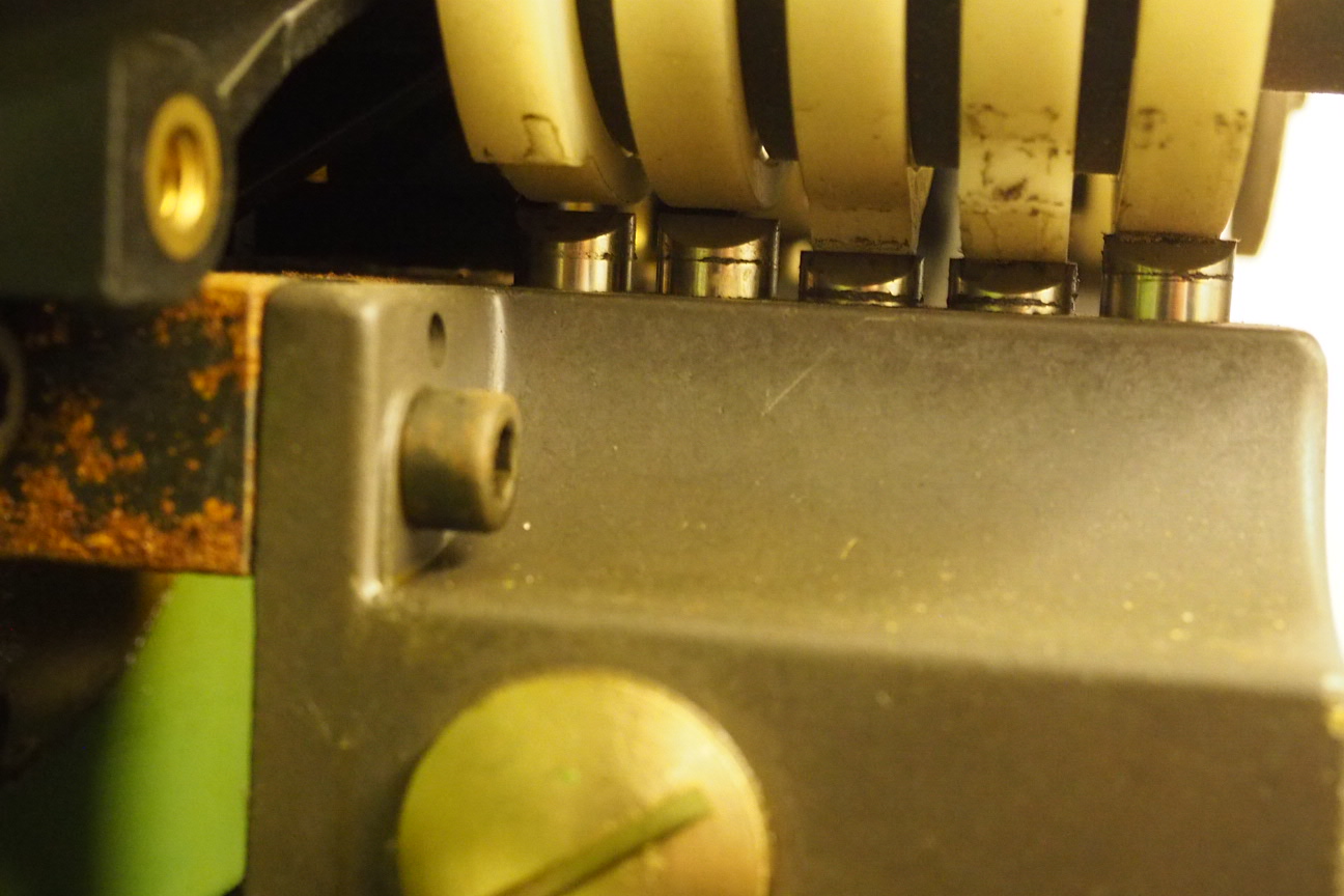

09 Sep 2017 18:45 - 09 Sep 2017 19:49 #98744
by RotarySMP
Thanks a lot for the confirmation.
It is a bit weird that the cam switching blocks have 5 cams and 5 switches, but my schematic (and all other MAHO schematics I have studied) only show 4 switches being used for the feedback.
(Edit] Woops In a different part of the schematic it shows all five with the extra one being "Mitte - Vorabschaltung" Middle permature stop?
Mark
Mark
