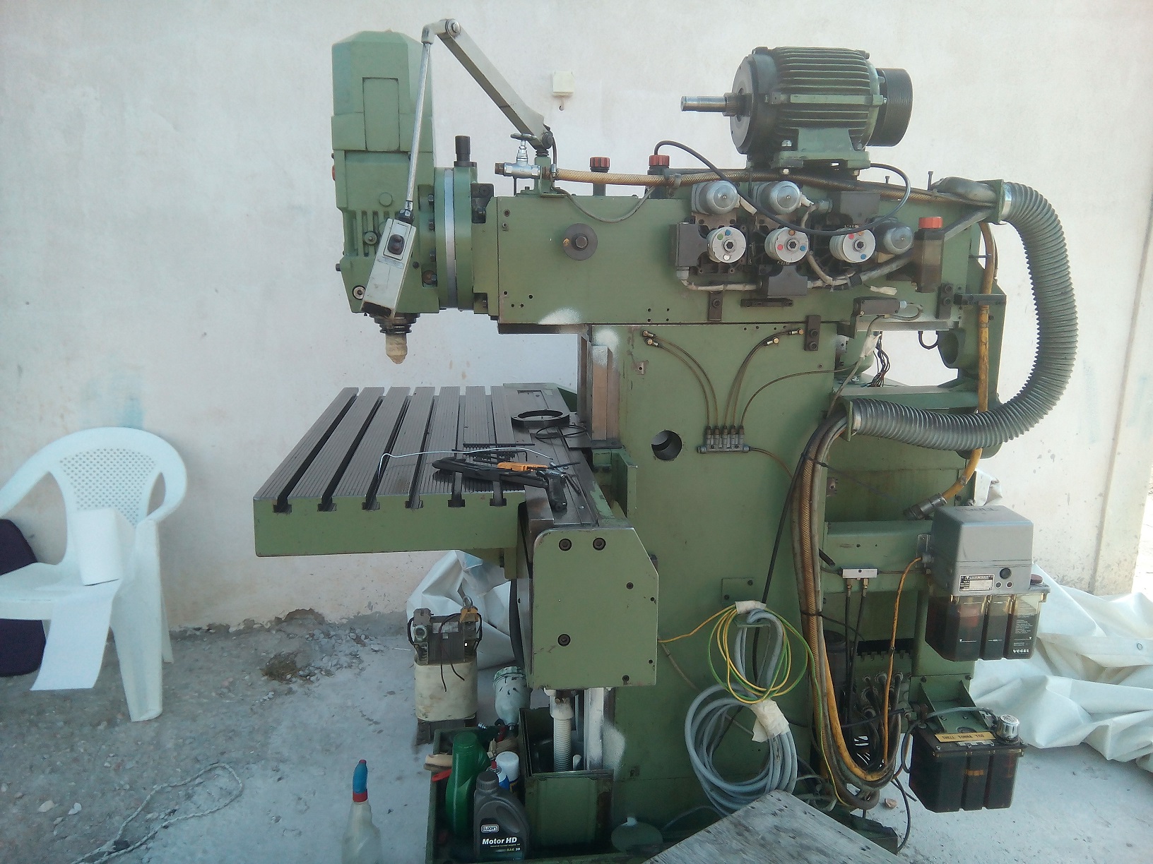

Are you also using a MESA 5i25/7i77/7i84 setup, or something different? Do you have any pictures of your machine, and how you packed the replacement electronics into the electrical cabinet? Since I am going to reuse the Heindenhain EXE board, it is tempting to put the ITX motherboard, and the 7i77 onto slide in carriers, and reuse the Phillips housing. The 7i84 is going on the cabinet door, as it is only interfacing the two MAHO relay board ribbon cables (unless I run out of I/O on the 7i77).

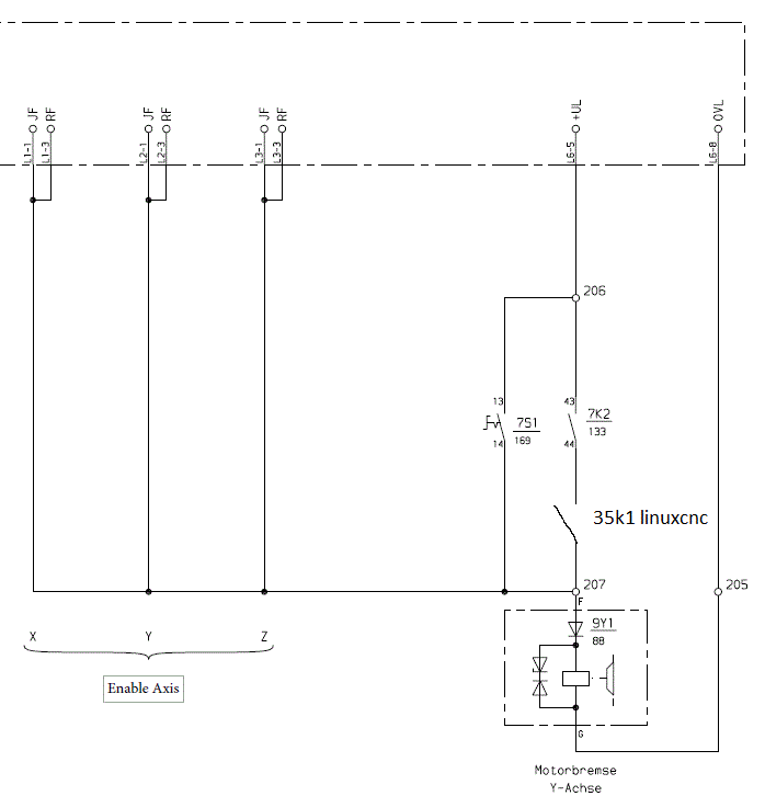

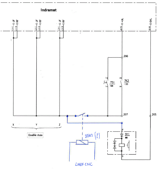

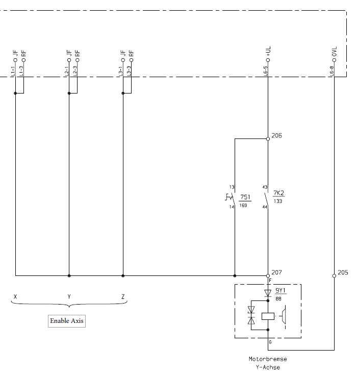

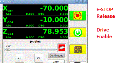

Concerning the last MAHO wiring diagram which needs modification (Sheet 06 in my set) do you have a recommendation for the axis enable set up? As far as I can tell, the three axis are enabled, and the Z motor brake released as soon as the machine is released from E-Stop (7K2 relay) or when the Z Brake release is selected on the 28A1 relay board.
LinuxCNC would normally separate these functions, first releasing the machine from E-Stop, and then enabling the drives.
Option 1
If we keep the MAHO's set up, then we need to connect the LinuxCNC "E-Stop release" button though the HAL to the MESA TB3-17 "CNC Ready" output, closing 19K1, which releases the E-Stop chain, and thus enabling all axis.
That leaves nothing for the LinuxCNC "Machine On/Enable drives" button to do.
Option 2
We add a relay between screw connection 207, and the Indramat enable pins giving LinuxCNC separate drive enable control. We will also need to move the Z brake wiring to be controlled by that same relay, otherwise we'd drop the Z axis as soon as we exit E stop, without the drive enabled.
Ideally, I'd like to use the existing relay 35K1 for this, as it was "Address M" before, and now unused. There is an input "feedback address M and T" on pin IPC1-1. I need to energise that and see if it actually controls the 35K1 relay. If the control signal to that relay is available, the second issue will be whether the relay is rated for the current of the brake, as it will be energised for hours. What is your Z brake rated at? And the final show stopper would be if the second pole of the relays is wired to ground on the PCB of the relay board. If that is the case, then I guess we will be putting an addition relay on a rail.
[edit] Option 3
Split the drive enables and wire X to the MESA 7i77 TB5-4 and Y to TB5-8. Run the Z enable and it's brake from TB5- 12 to control both the Axis enable and release the brake. This would take three relays to use the existing power at screw connection 207, thus keeping the hardware E-Stop in the enable loop. All three MESA Enable pins could be connected in the HAL to the single drive enable pin. Not sure if there would be an advantage in doing this.
Really nice machine you got there. Also looks like it had an easy life.

Hello, I thing we should choose the split logic of linuxcnc. And the wiring should be like this if the contact can handle the current.

The relay boars for the 7s1 says break release but instead enables the drive and releases break, I am confused. What is the real use of that switch?

According to the MAHO user manual, it is to release the brake so that you can manually crank the Z axis off it's end stop. Not sure how that is supposed to work, it the drive is activated to lock the motor at the same time.

I took a look at the relay panel and wiring this evening, but doubt we can use 35K1 for that drive enable, as we will only have access to one side of the relay. The other side goes to earth on the PCB.
