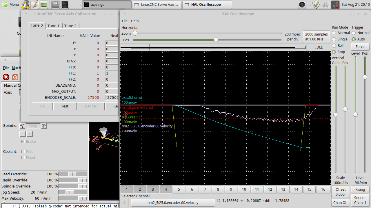

14 Jul 2022 16:12 #247299 by new2linux
Todd, thanks!! I have several pics of traces that have the trace (top of the corner is not sharp, has radius) not filling (what Pot or SW- fills the corner; what is best way to fill corner?) that corner. Only 1 trace attached, units are uniform, but you see the trace is on bottom of center line, it seems to be more consistence this direction. I have worked through the sw 2 settings to control overshoot, Pot1 as high w/o any noise or vibrations. Setting on pic are y=y axes motor; s2=1.267; s3=SW3 .20 & .0147 P1=11.5 turn cw; P3=10.625 cw fd=20"/min.
Many thanks

14 Jul 2022 18:40 #247311 by Todd Zuercher
Moving in the right direction.
What does the trace look like when you set SW2 to off, off, off, on? (leaving every thing else alone.)

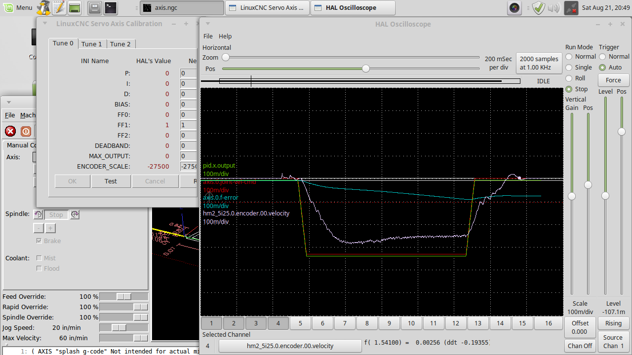

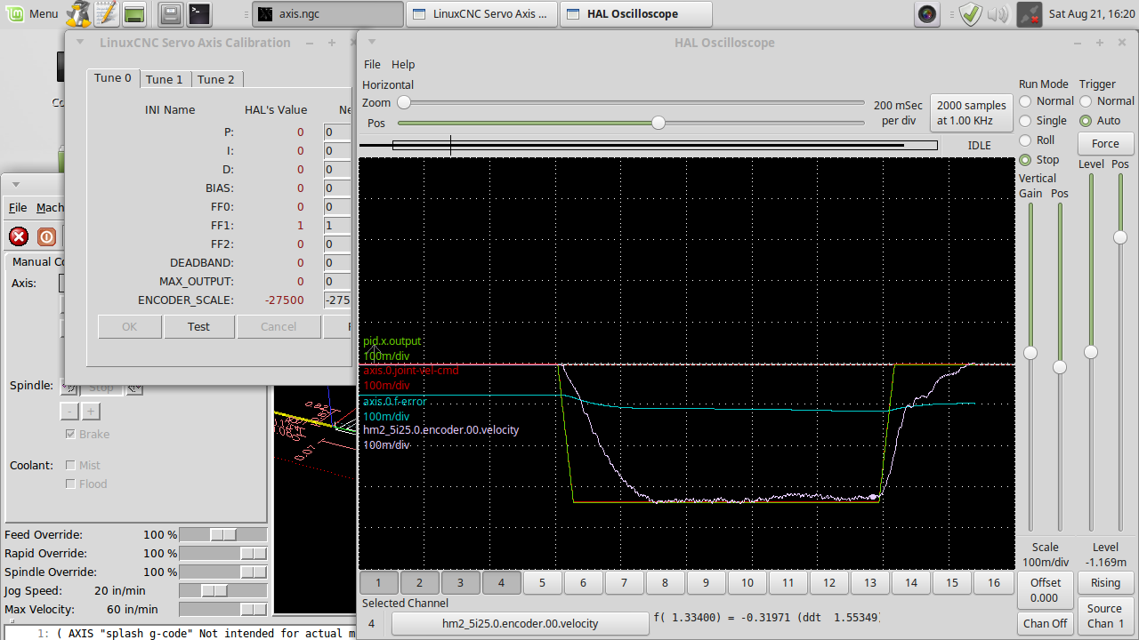

14 Jul 2022 20:38 #247320 by new2linux
Todd, thank you! This attached pics are a close to the trace as the one you requested & a pic of the settings you asked for. I don;t understand why it will not repeat with a very close trace if settings are the same.
These pics are with table moving left to right (vs. right to left) the trace (rt to left) has a great deal of difference, not in the good way. I have spent a great deal of time tuning, just nothing real promising to show. I am staying with the left to rt feed direction.
Many thanks!
In the pics, the only Pot 3 changes, 11.0 vs. 13.5.

14 Jul 2022 21:00 #247322 by Todd Zuercher
Does your machine have lead screws or ball screws? The most likely reason for the difference in reaction for different direction moves, is because the friction in one direction might be different from the other. Could be because of a number of reasons. Maybe one of the gibs is a bit out of adjustment and moving in one direction causes the table to turn a little and causes something to bind a bit.
