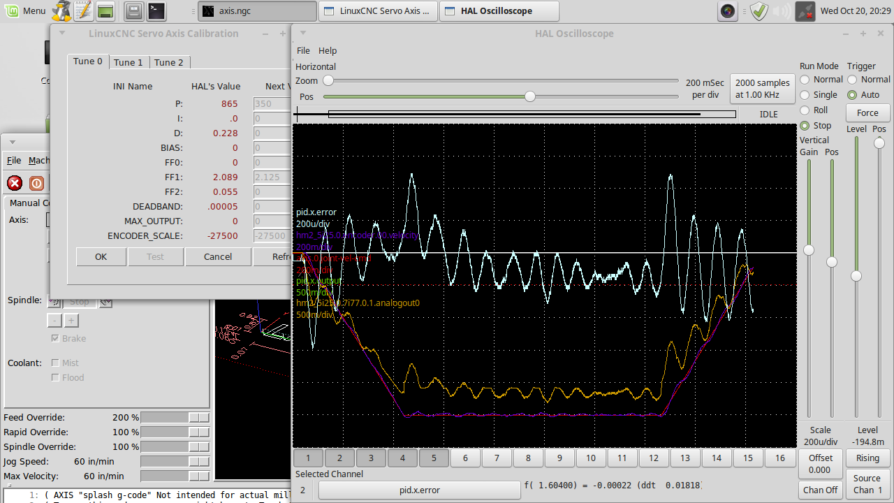

12 Sep 2022 20:12 #251765
by new2linux
Replied by new2linux on topic Set up using AMC AB15A100 drives, brushed DC motor Prototrak Plus with Encoders
Todd, many thanks! Attached a pic of traces in the p=800 range. I started the opposite direction, seems more consistence trace. You will see that the start of the cruse

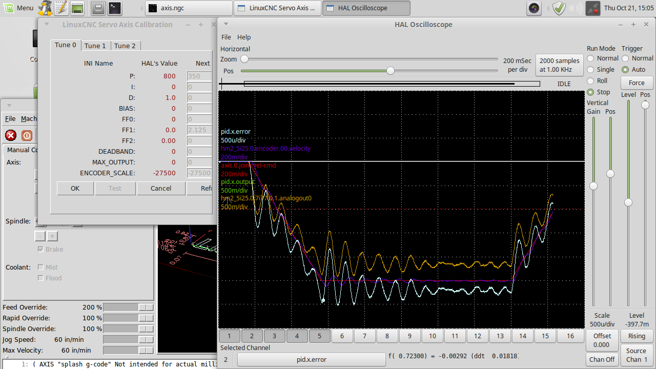

13 Sep 2022 14:54 #251809
by new2linux

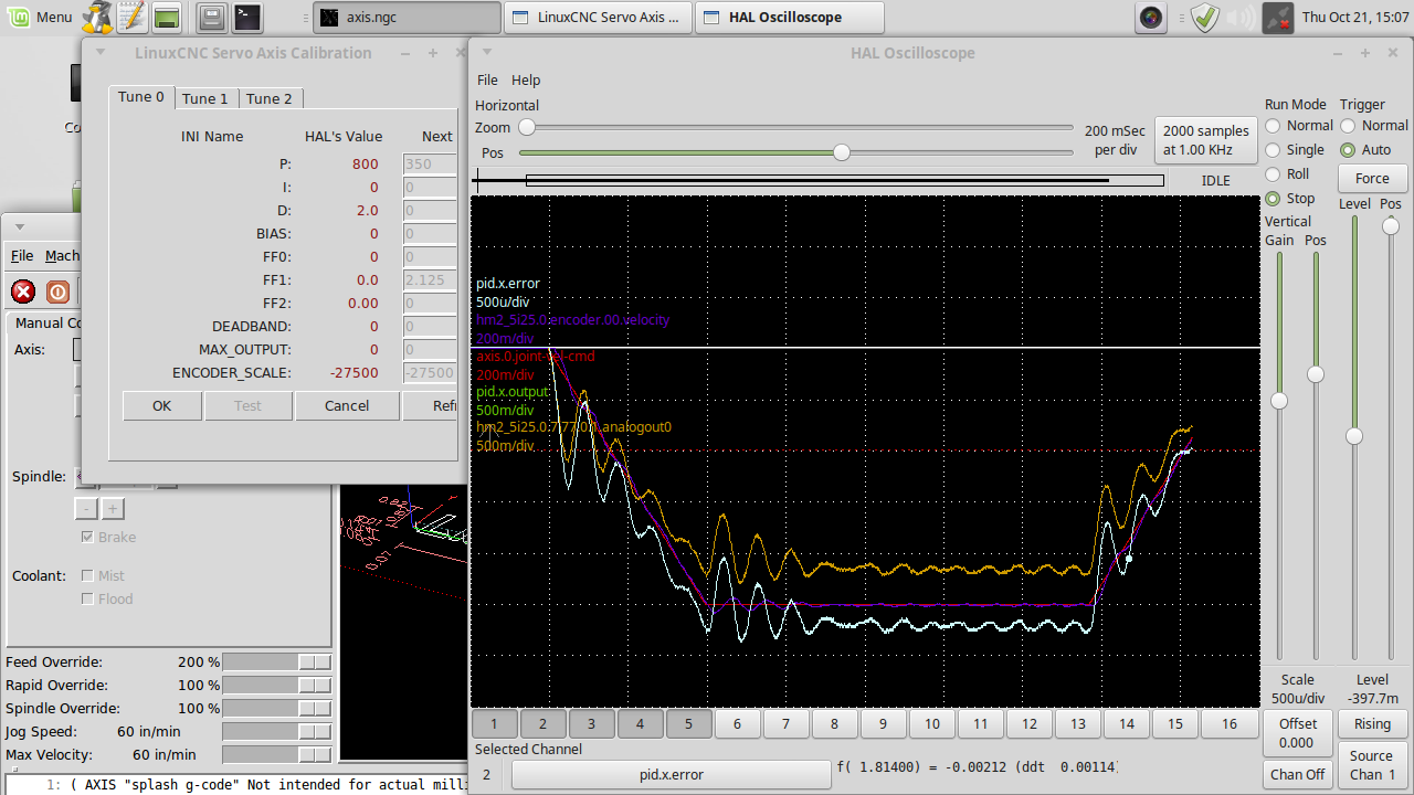

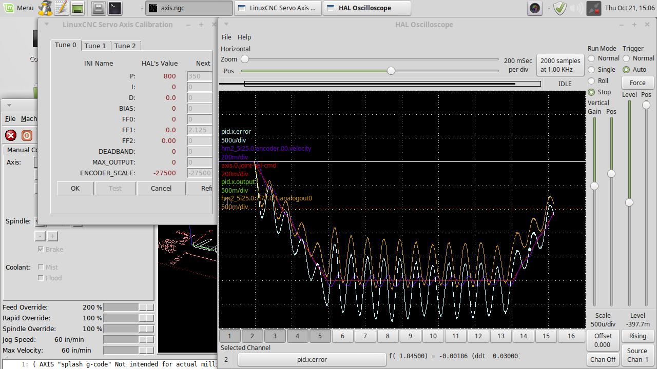

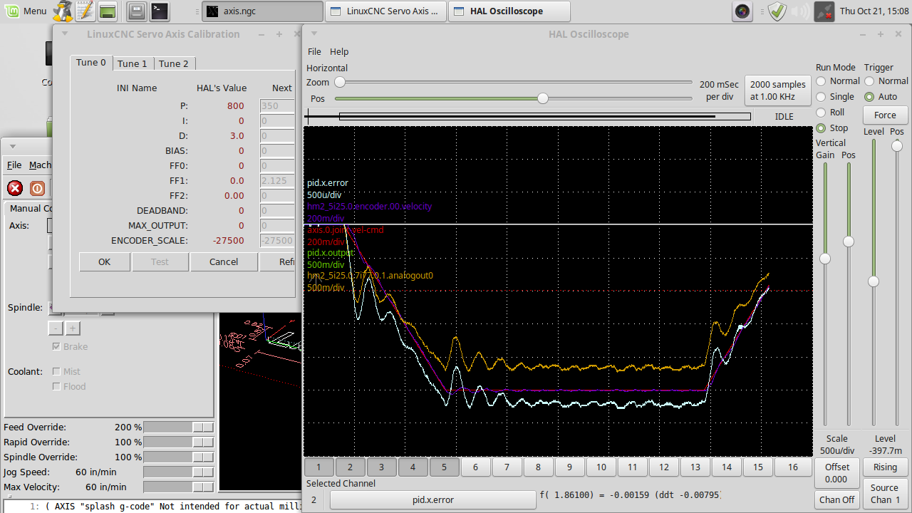

Todd, Thanks!! What I was trying to say is that ch2 & ch4 are always on top of each other, (never separate, with a section of screen between) so 60-90% from where? I think it is 100% with different amounts of oscillation as I go up in values. I was thinking (I know, their I go again, thinking again) that the trace may of not been low enough and missed the 60-90% "sweet spot" instead went all the way to 100%, and your suggestion was specific in the #251433 post.
The attached traces start with P=800, the units are ch 3 & 5 = 500m/div; ch 1 & 4 = 200m/div & ch2 = 500u/div. Notice all other settings are 0.0.
Many thanks!
Many thanks!

13 Sep 2022 15:14 #251812
Replied by Todd Zuercher on topic Set up using AMC AB15A100 drives, brushed DC motor Prototrak Plus with Encoders
When you have all of the feed forwards (mainly FF1) set to zero this is expected. In this situation the output command is driven only by the error. With every thing set to zero except for P, the out put to the drive is simply the error multiplied by P, so the larger the error the larger the output command to the drive.
Adding more D is certainly improving the oscillation. I think you should definitely try adding more. (You should also put the FF1 and FF2 settings back to where they were at, about 2.1 and 0.06.)

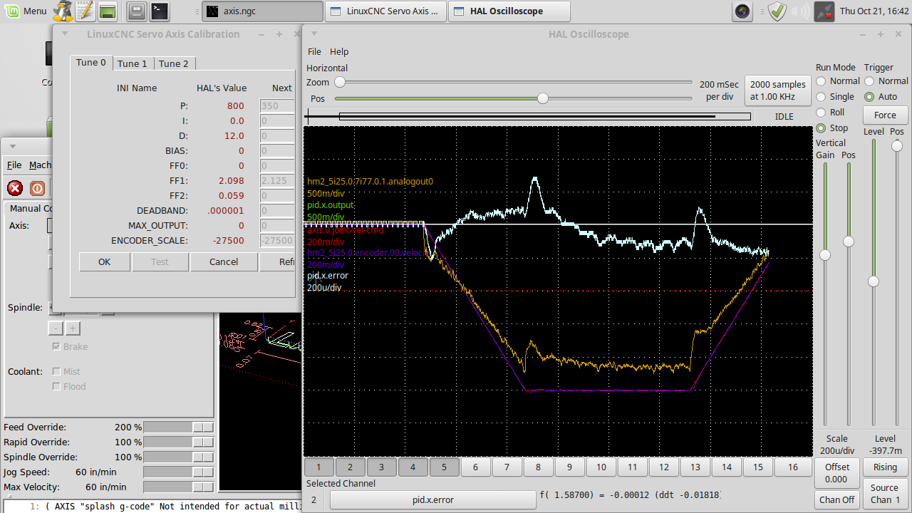

13 Sep 2022 15:43 #251815
by new2linux

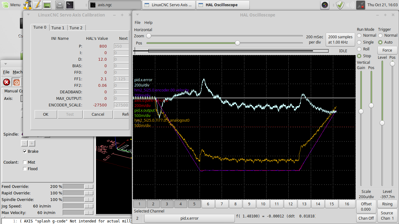

Todd, thanks! Attached is best trace, the units are ch 3 & 5 = 500m/div; ch 1 & 4 = 200m/div & ch2 = 500u/div. The settings are on the screen. What do you think?
Many thanks!
Many thanks!
- Todd Zuercher
- Posts: 4786
- Thank you received: 1476
13 Sep 2022 15:51 #251818
Yes that looks pretty good. Might be able to improve the cruse error with some more little tweeks of FF1 and FF2. But otherwise that is probably about as good as your going to get it.
Also put the deadband back to where we had it. (That should quiet down the dithering when the servo is at rest.)

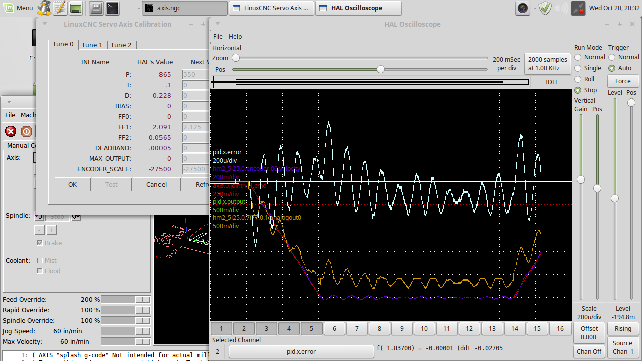

Todd, thanks! The attached pic is the best trace with settings for "X" axes. Now for "Y" axes, start with the "x" settings?
Many thanks!
