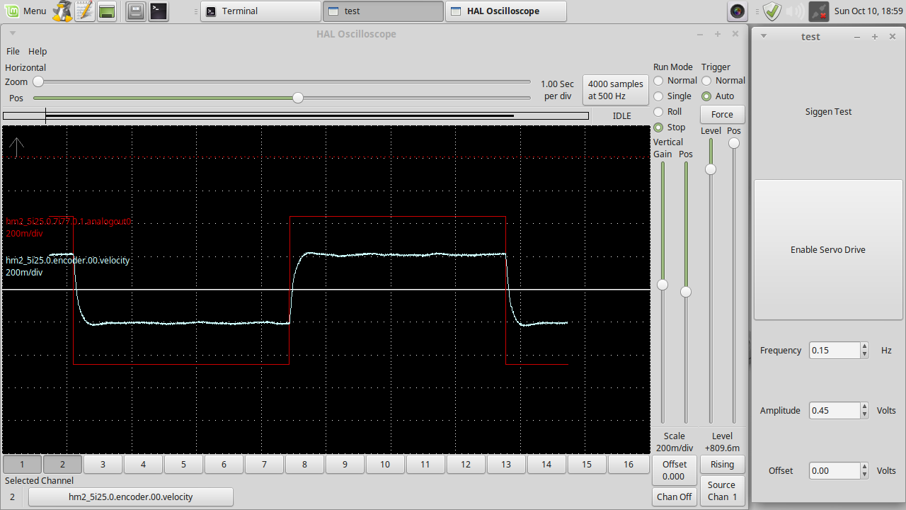

Todd & tommylight many thanks for your help. I have disconnected (left in the temps, so hook up Rigol, anytime) the Rigol o-scope, and see no real noticeable change in the trace. I plan to work (never moving Pot4), Pot1 & 3, try to keep pot 3 below 7.0 turns (as you have stated this is a high number of turns) & work Pot1 so the motor does not get nosies (usually over 10.5), with the intent the trace has sharp corners and level "cruse".

Interesting, now it is nicely behaved. I think that would seem to imply that it is a noise issue on the encoder lines, and some how hooking up the scope helped clean up the signal enough to not bother the servo drive, or there is a wiring connection problem and what ever you did to connect the probe leads, improved that connection so it isn't currently causing a problem.
Not being an electrical engineer I really don't have a clue what the answer is, but I'm sure to someone who knows what they're doing the answer and solution is probably obvious.
I'm not sure what is going on with your scope trace but I don't think the settings are right.
If it stays as nice as the last plot, it is probably good enough to move on to tuning the position loop.

Todd, many thanks! Attached is a trace, taken just now, the corner is not so sharp, but balanced (symmetrical) top to bottom (when trace is below the "zero" table is moving to the right), the settings are SW2=1.147; Pot1=10.0; Pot3=6.75, this are same settings as you referenced in prior post. I have tried Pot 1 over 11.0, with Pot 3 low, as to not get spike, the spike will 1st appear when the table moving to the right. I am willing to do what is necessary to get this correct, but if some sacrifice at top feed rate is necessary, its ok. I still have the "temps" connected & 7i77 card is out of cabinet. I will wait for your response before putting the electrical cabinet back together.

You may just be able to call it good enough. I'd be inclined to try tuning the position loop in Linuxcnc with it as is. If you can't get satisfactory results with the position loop, then you could come back to this and increase pot1 to get a faster response, then increase SW2 to tame the overshoot caused by the higher pot1 setting. The AMC instructions are to turn up pot1 until it buzzes (I think when it is at rest, enabled but no commanded movement.) Then back off 1 turn. Then fix any overshot with SW2 (with the test we were using).

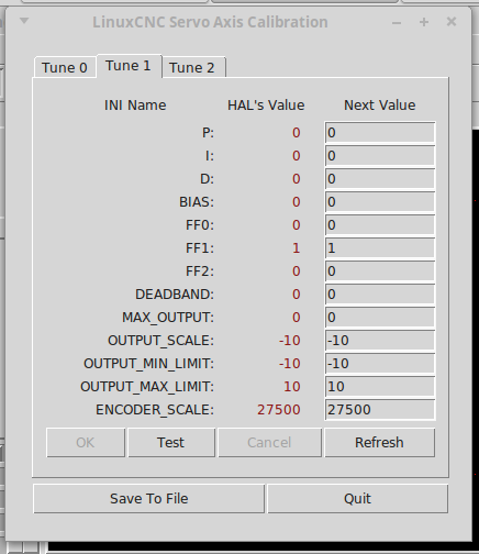

The LEDs all look proper on drives & 7i77 card. The pic of the "Configuration" screen for the "y" axes has 3 extra lines: OUTPUT_SCALE; OUTPUT_MIN_LIMIT & OUTPUT_MAX_LIMIT. I was going to try tuning the "y" axes but noticed the difference.
Many thanks
Edit: The DRO seems to work proper, the only setting that had a value in the "calibration" screen was the FF1=1.0, all others were 0.0.
