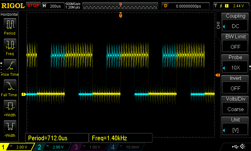

Todd, Many thanks!! I believe that the o-scope is connected proper, but have not mastered the o-scope settings. This attached pic, is this the type of trace I am to look for or adjust scope to? Not completely shore of what to expect in the trace.
Many thanks
Many thanks

If those are encoder signals, there is to much noise, even when at 0.

I'm not so sure the signal is all that noisy in that image. The scope setting is layering many many sweeps for the same trigger point, on channel one. And you are seeing multiple rises on channel 2 layered over top of each other and those are not all in the same position because of variation in the velocity. Try pressing the "Single" button to get a single trace sweep.

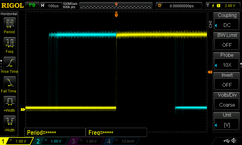

You'll want to zoom out on those waves so that you can see a larger number of cycles to look for noise. And you'll want to examine and compare what the pattern looks like while the machine is moving in each direction, since before it was only looking goofy when moving one way.

Todd & tommylight many thanks! I tried the o-scope a few different ways using the "single" and this is the trace. I used the "intensity" to clear up the screen. Is this better? The base line is aligned (zero is same for both) for both channel.
Many thanks!

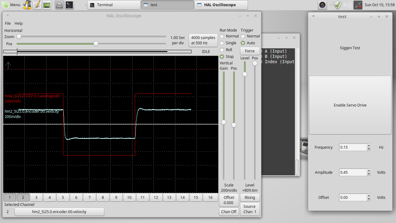

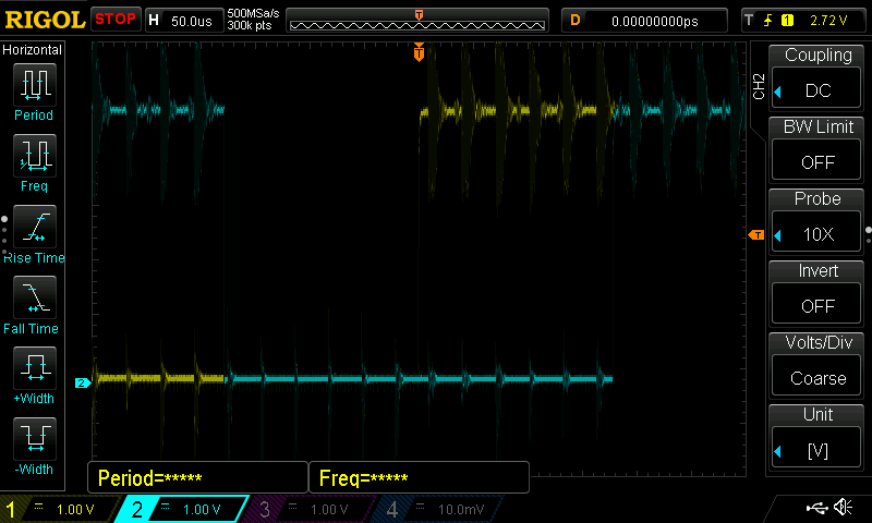

Many thanks! This is a trace zoomed out, today I do not notice in the trace any difference (as table moves one direction vs. than other) in the directions, I tried the HAL Scope with setting (as ended yesterday; sw2=1.147, pot1=10.0,pot3-6.75. Only change was Pot4. Today set pot4 as per Todd's post (01 Sep 2022 20:45) was how Pot4 was adjusted.
Edit: Do you think that having the Rigol o-scope connected that it may make a difference when tuning the HAL o-scope?
Many thanks!
Many thanks!
