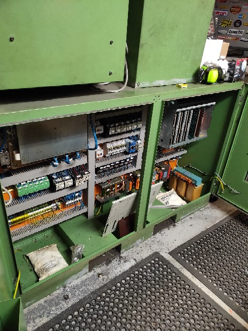

Hi All
A few years back a mate and Got possession of an old Deckel FP4 ATC with the TNC355 Control
It came from my workplace who purchased it from the original owner new back in 1990 (and who now worked for the company)
It never worked at my workplace as the batteries went flat and it lost all parameters.
After we aquired it i got some parameters from a german company and spent a few hours reloading them.
This all went to plan however the axis' would not move and go home.
After a bit of mucking around we kind of lost interest and as the machine is an hour or so away from me it is hard to spend time to diagnose and so it has sat in my mates factory for the last 7 or so years.
Now my friend is moving his workshop and has no interest in retaining the deckel. Providing i can move it it will be coming to my shed and i will attempt a control refit.
I would like to retain the original servos and drives for simplicity, i do believe the drives were our original issue a few years back.
I understand that i will need to source some EXE boxes if i go down this path.
What is the best way to test if the drives are viable? i have read about applying a small voltage to them to see if the servo moves.
Alternatively would a new drive similar to www.machdrives.com/bra.html be an option? Only issue i see is that the max voltage is lower than the rated voltage on the servo. Is that a big issue?
Another issue i will have to overcome is the machine is 3 phase 415v however i only have 240v single phase available at home.
With a control refit i will sort out some of the voltage and phase issues however if a VFD is used to power the spindle will there be any other requirement for 3ph power?
The tool changer will be a future challenge i really just want to get the machine making some chips first.
My previous CNC conversion experience is a round column mill conversion using a USB breakout board running Mach3

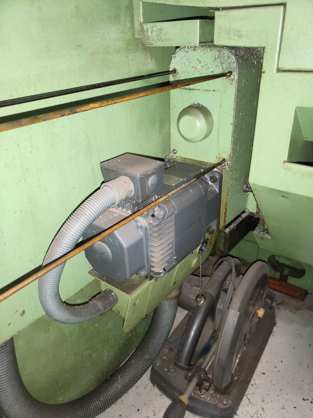

Replied by andypugh on topic Deckel FP4 ATC Retrofit
I bought one of those on eBay a while ago, but then the vendor talked me out of it. I think he was right, it would have been a very right fit in my garage.
I suspect that the machdrives drive that you linked probably has more "smarts" than necessary for this retrofit. It seems to be aimed at converting to step-dir control and closes the position loop in the drive. Which is fine, but LinuxCNC offers plenty of other options.
Do you know what voltage the servos originally operated at? It is probably not 500+V DC from the rectified 414AC, so you can probably get a suitable drive voltage with a transformer swap.
(I think I see 176V on the motor plate in the photo, but I am not clear if that is the spindle or a servo)
One option for a DC servo drive is: store.mesanet.com/index.php?route=produc...83_90&product_id=141 (Which can handle two motors per drive)

Looks like that Siemens servo is a 176VDC, 7.6A thing. No idea what feedback it uses (couldn't find a datasheet)

Sorry for the delayed response been waiting for the machine to arrive.
Current servos are 176v DC Siemens units.
Current Bosch drive receives 165v 3 phase AC and I assume rectifies to DC.
I believe the drives are damaged in some way so will not be retaining them. But if I am to keep the current servos I will be needing a 160ish volt DC power supply capable of 2000w or so which isn't cheap from what I'm finding.

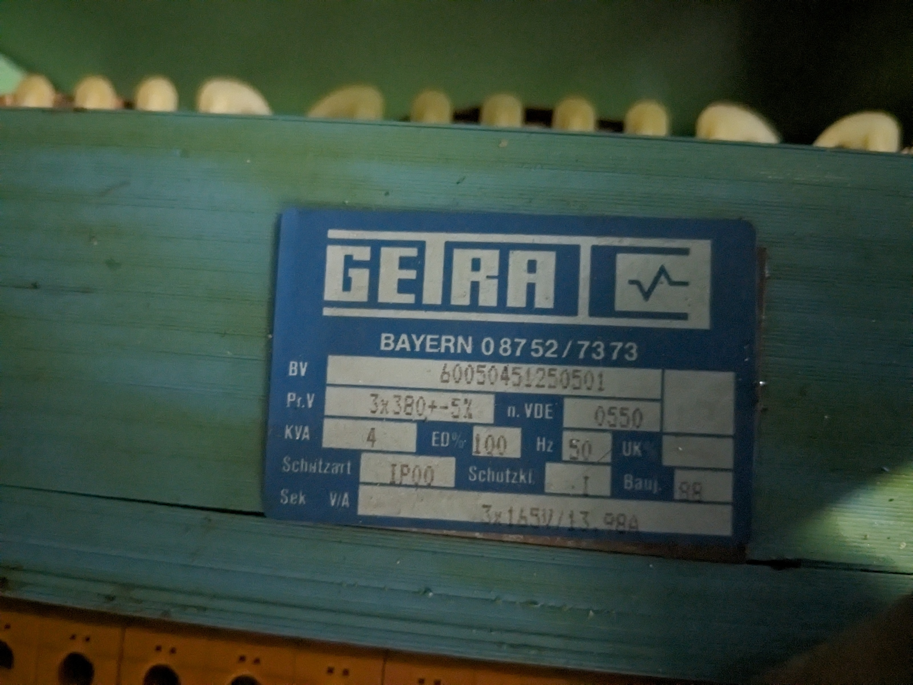

Are the motors brushed DC or 3 phase AC?
Also, 165V AC after rectification is 232V DC, so a 160V DC drive will burn to a crisp if wired to existing transformer with 3x165V AC.
In general, 100V AC is never ever the same as 100V DC, not even for a light bulb.

by Walkahz
Replied by Walkahz on topic Deckel FP4 ATC Retrofit
They are brushed DC motors.
I have attached a photo of the transformer that goes to the current Bosch transistor drives.
I will look into the bridge rectifier option.
Does it go straight to the drives, or via smoothing caps?
I was going to suggest store.mesanet.com/index.php?route=produc...83_90&product_id=141 for drives but I would expect the 165V on the transformer plate to be Vrms not Vpeak, and that would be 230V once rectified into capacitors.
