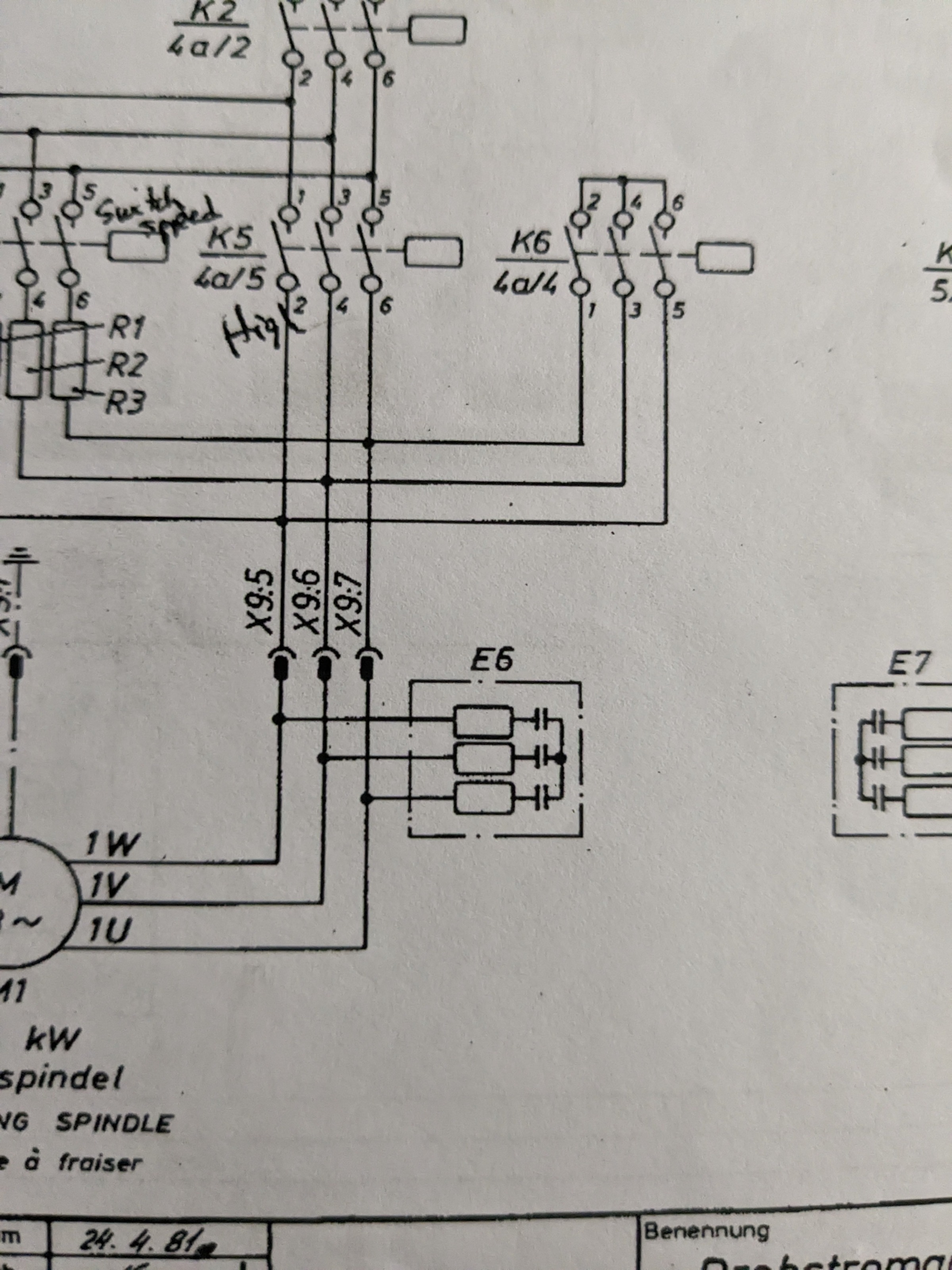

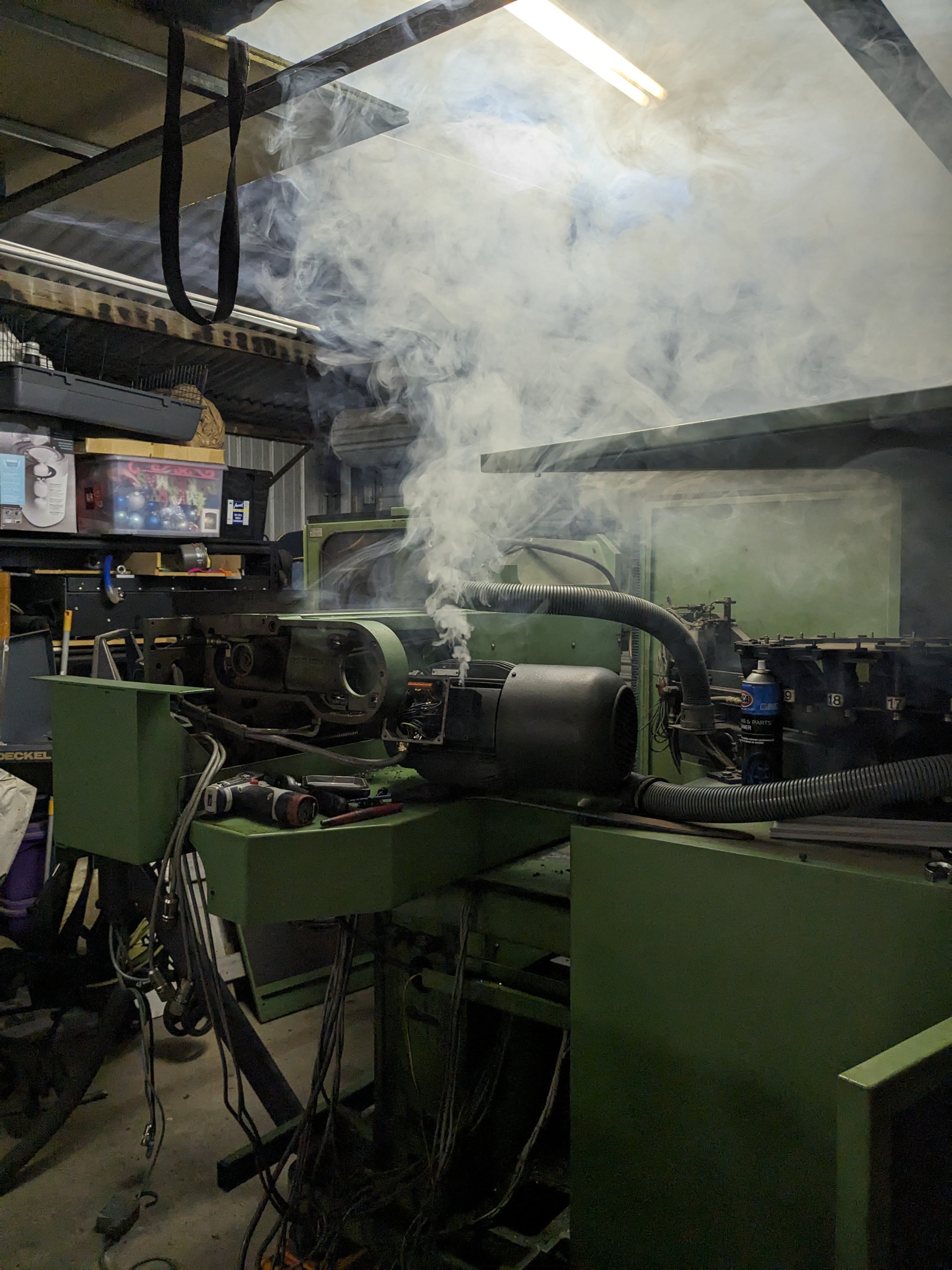

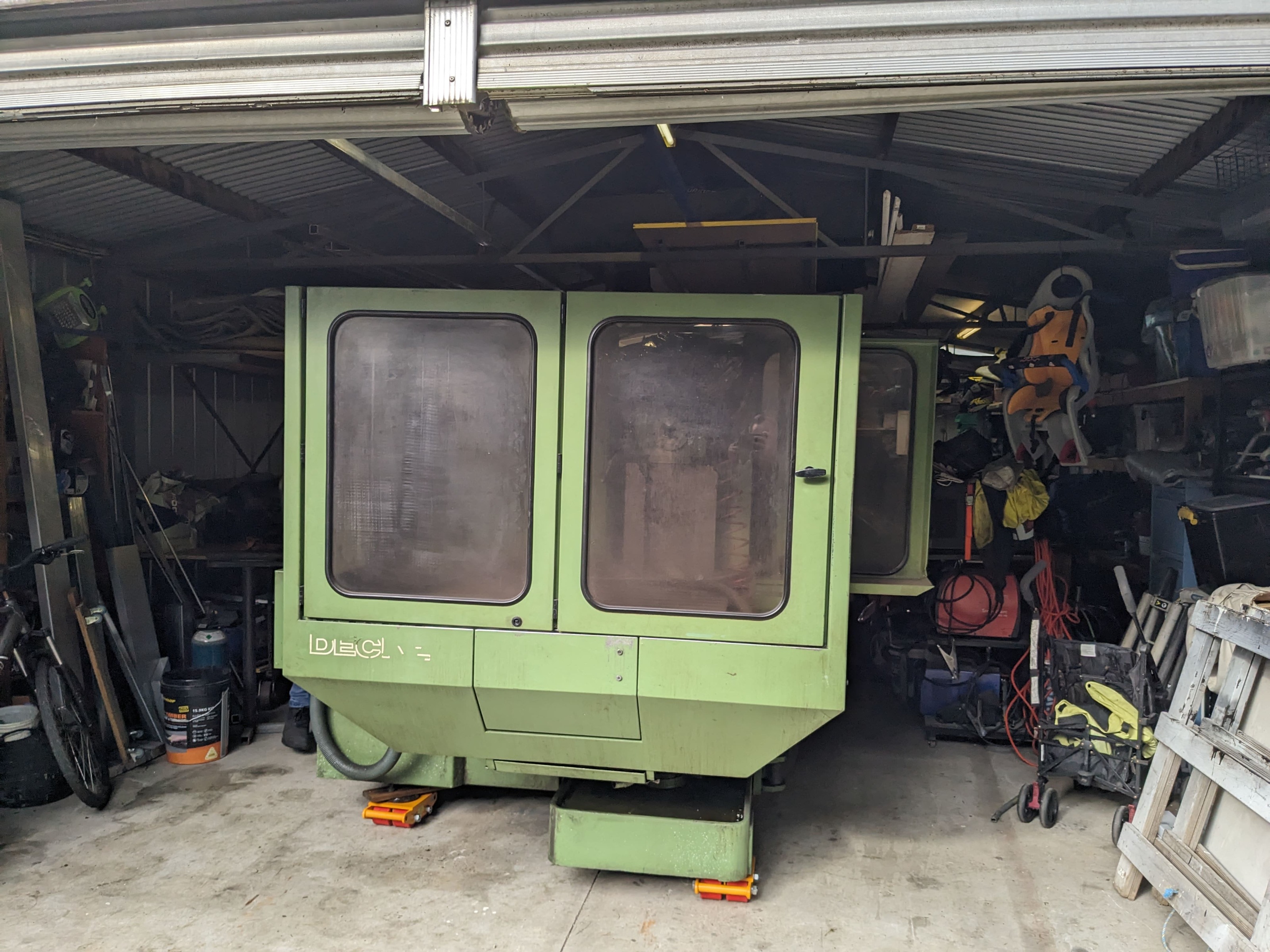

Been a while since my last post. I have gotten stuck in now the machine has been delivered and have been removing all the components that will be unused and tracing wiring so i can reverse engineer systems.
This project has gotten more complex due to my want to keep the machine to single phase only power which has meant removing most of the existing wiring and electronics that were mostly 3 phase. There were multiple transformers in the control box converting 380v 3ph to many different voltages both single and multi phase. These have all been removed.The 7 contactors that controlled the spindle motor have been removed and replaced by a VFD. This has been tested and functions well apart from letting the "smoke" out of a module that was wired into the motor... I believe a surge protector of some sort (E6 on the diagram). I removed these and tested motor again and it functions as it should.

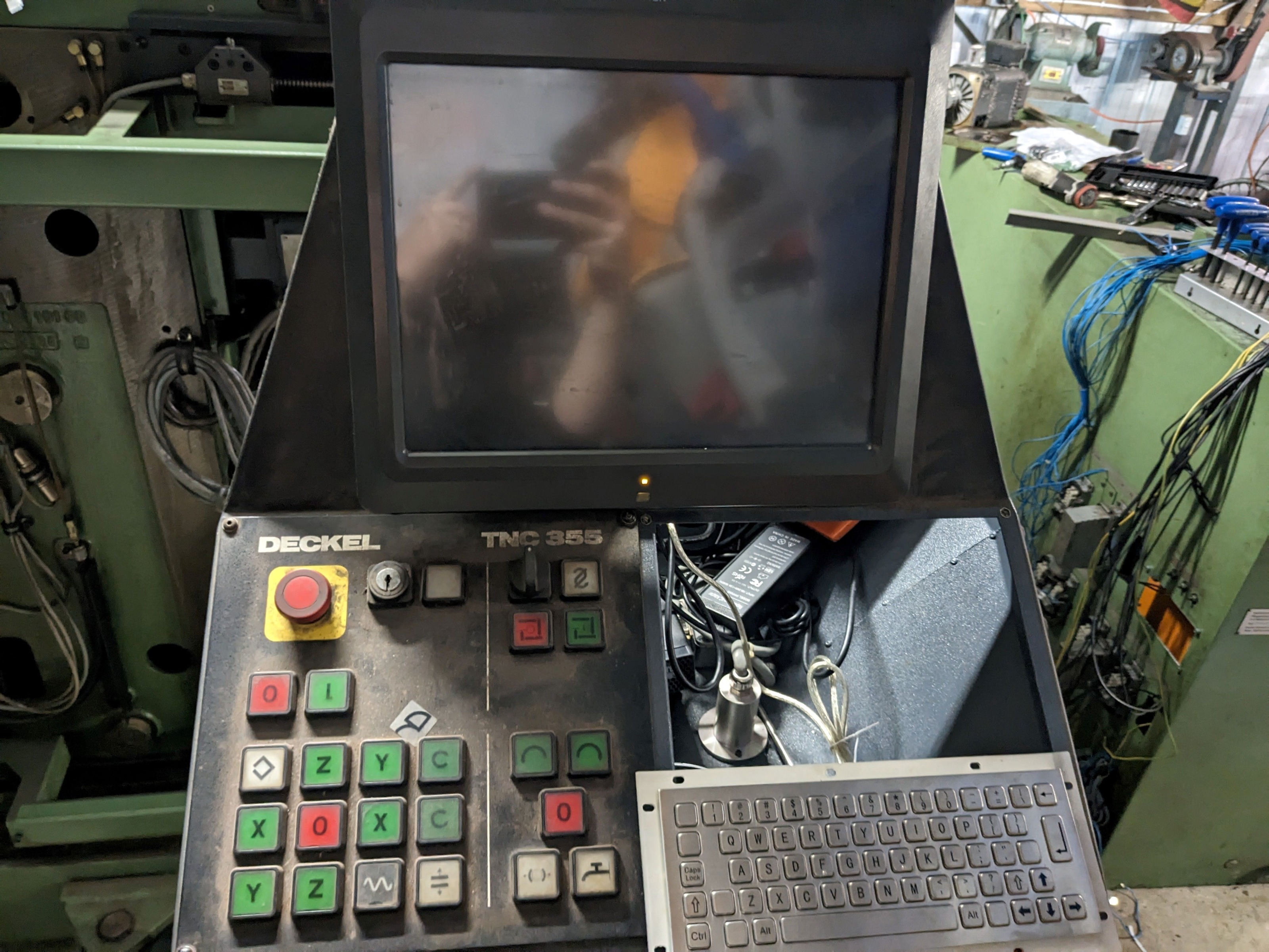

I have purchased a PC and touch screen and am mounting them to the original control cabinet so i dont have to make anything from scratch.
I have ordered a Mesa 7I96S as my main control board with a 7i84D for additional I/O.

Nice smoke effects ! :)
It looks like a high frequency protection, would be nice to replace that as it helps suppressing interference's.

Still Chipping Away. I investigated the drives Pawel has suggested and they could work. Cost isnt crazy but it is similar pricing to 3 brand new lichuan AC servos with drives which is the way i am leaning at this point.
Have got my touch screen mounted to my existing panel (some slight mods required) The calibration is way out for the touch so would love some guidance on how to best correct this.
Electronics box is almost completely stripped. Due to the smaller footprint of modern drives and equipment i am downsizing this by cutting it in half and i will weld the end back on. The other photos shows the pile of wiring and contactors which has been removed. Some of this will be repurposed in the refit but will end up with a lot of surplus.
My Mesa Cards arrived yesterday so i look forwards to getting these connected to the PC and Linux CNC.  I didnt realise but do the  7I96S and 7i84D require an External 5v supply? What is the best way to obtain this through a power supply?
