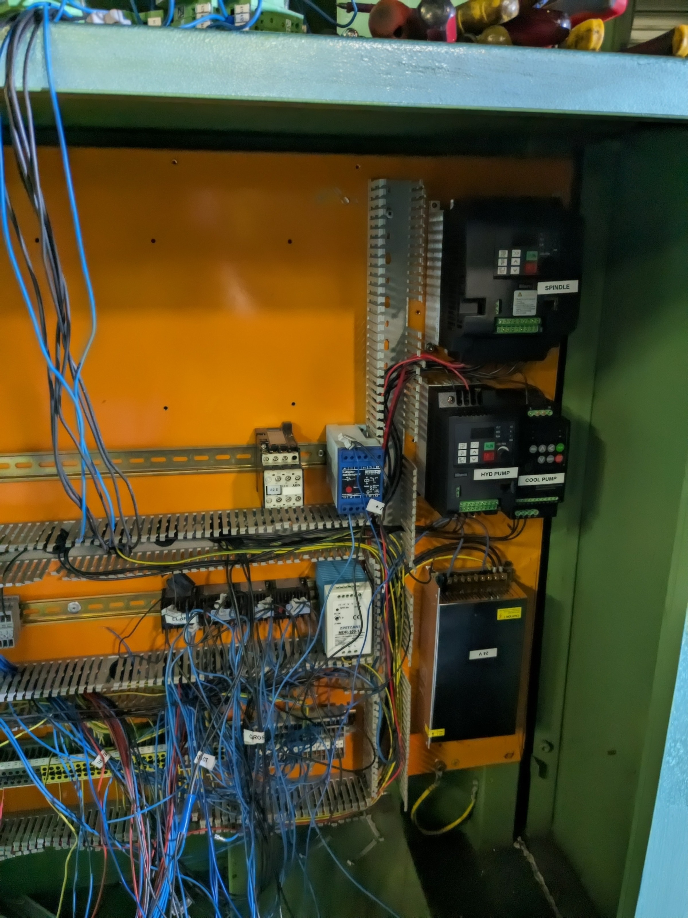

Control box is coming along, have got most wires I no longer need stripped and I am starting to put it together again. Have fitted up my 3 vfd's and 24v 12v power supplies.
240v power cable fitted and running through breakers and into my various distribution blocks. Having so much cable and componentry I have already removed is useful as there is plenty there for the rebuild.

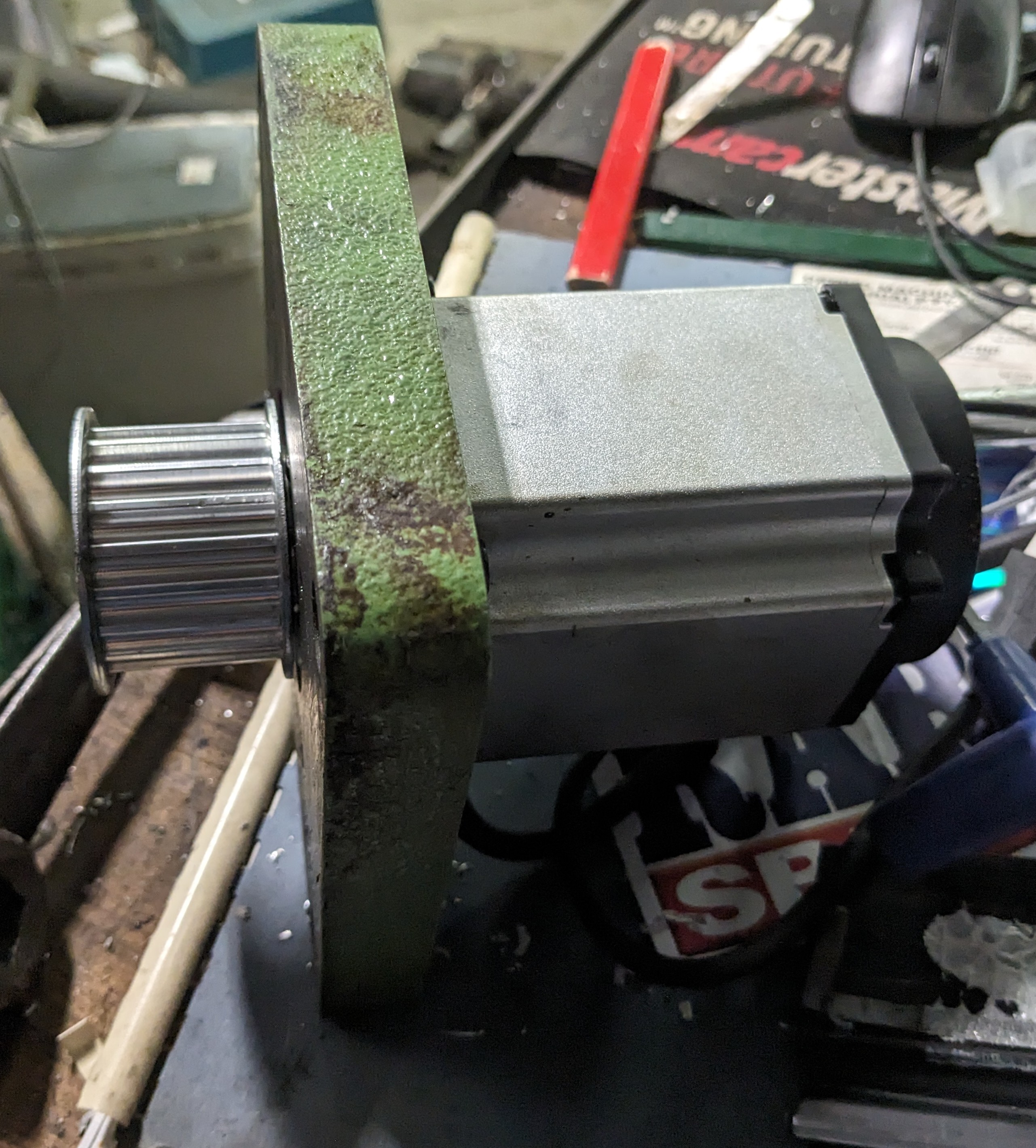

Got the fwd reverse switching working for the VFD. Ended up running through an external relay triggered by the 7i96.Need to read up more on how outputs are used on the 7i84 with only 1 wire unlike the 7i96 with a common side.In the meantime my 8m pulleys arrived from china for my X and y axis. Got my X axis finally moving. Probably the first movement this machine has made under its own power in 10 years!!! Photo of the servo on its mount before fitting.

Didn't realise how long it has been since posting here.
A lot of things have happened to the mill and on Friday I finally made its first very slow chips in a long long time.
Z axis motor took me some figuring out as the servo drive was not as basic as the X and Y motors.
Have wired up the hydraulic pump and got the tool clamp functional, have kept this running analogue style with just switches and relays for now. Can change to PC control down the track.
Have a tool setter and probe fitted although the probe was DOA from AliExpress so had to arrange another.
Still working on linking my physical buttons on my control panel as well as the biggest task of getting the gearbox running which I have had a few goes at now. I am finally getting some progress on a classic ladder solution for this so hopefully not too far off now.
