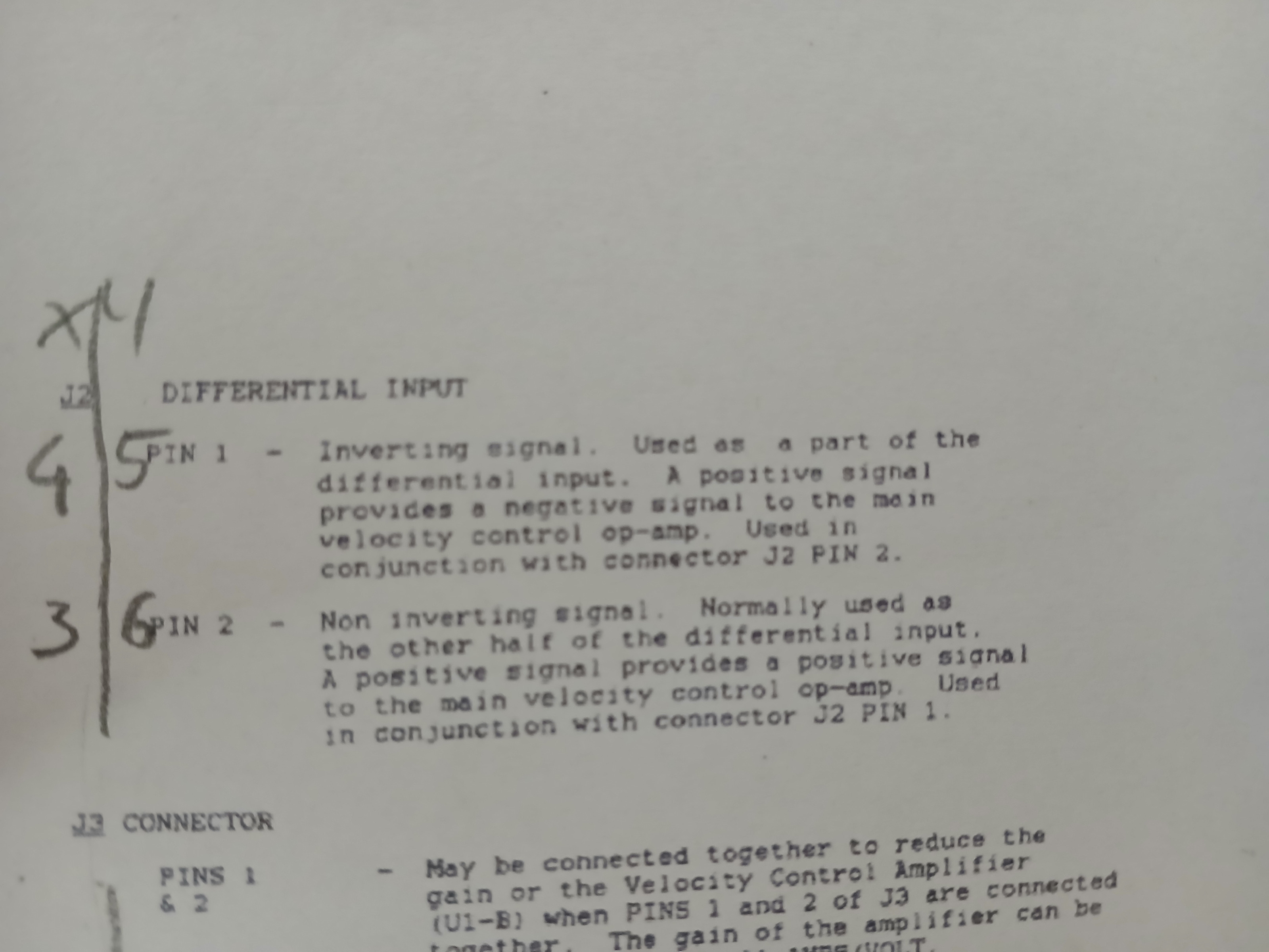

Replied by PCW on topic converting a tos/intos fngj 40
It look like J2 pins 1,2 are the differential analog input
So I would wire:
7I77AOUT --> J2 pin 2 (non inverting differential input)
7I77AGND --> J2 pin 1 (inverting differential input)
So I would wire:

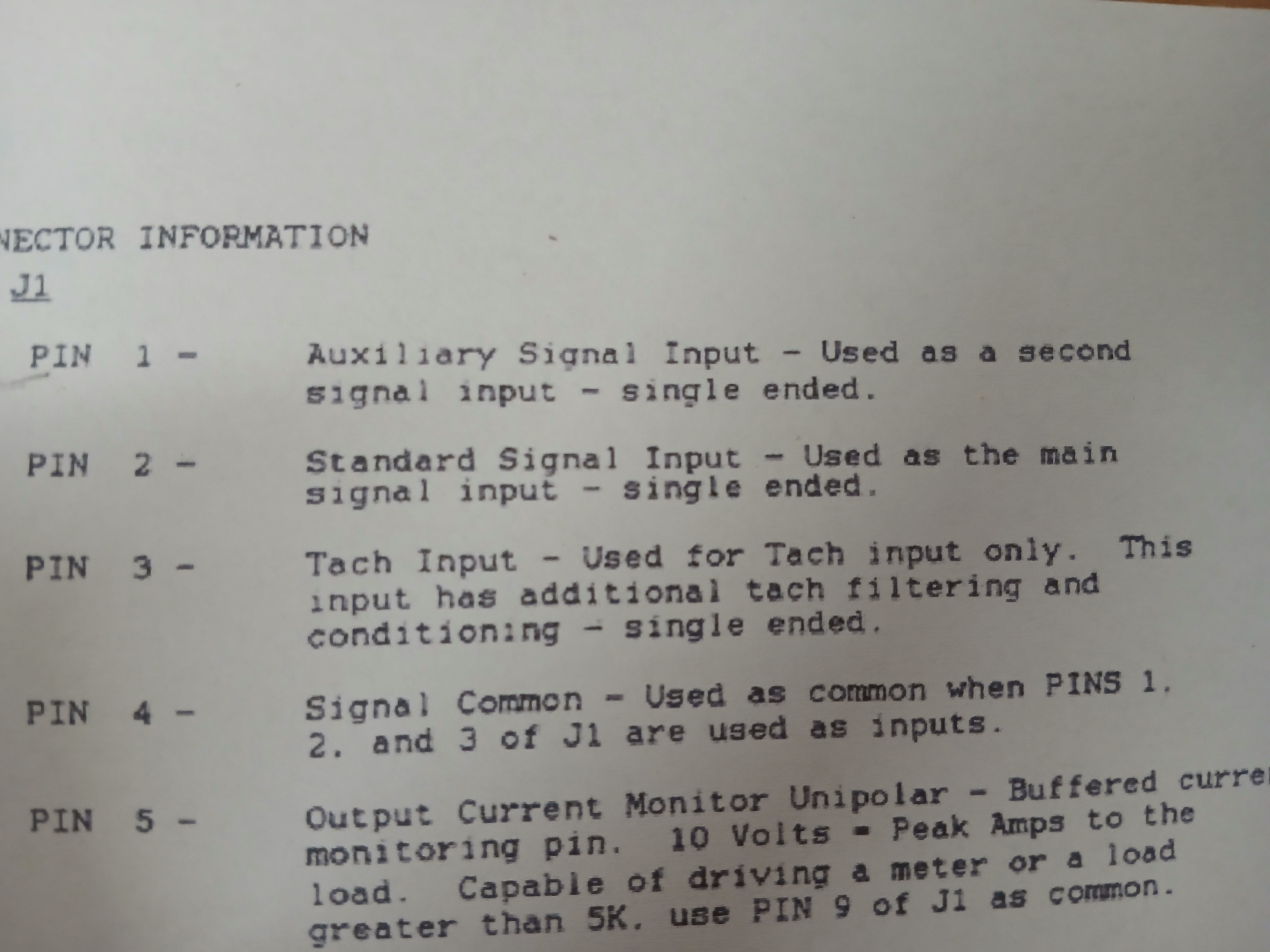

Replied by FPM on topic converting a tos/intos fngj 40
So you think the j1 pin 2 serves a different purpose?
- Posts: 18109
- Thank you received: 5329
28 Oct 2024 14:26 #313368
I don't know, but since the original system used J2 pins 1,2
I would use them.
I would use them.
The following user(s) said Thank You: FPM
