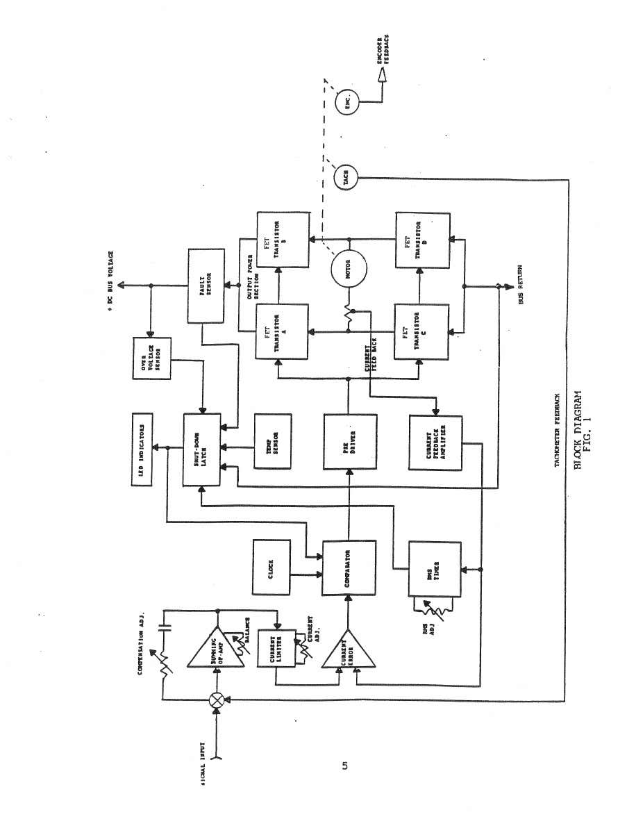

If they have tachometer feedback, they are velocity mode drives.
(a velocity mode drive is a torque mode drive with local velocity feedback)
