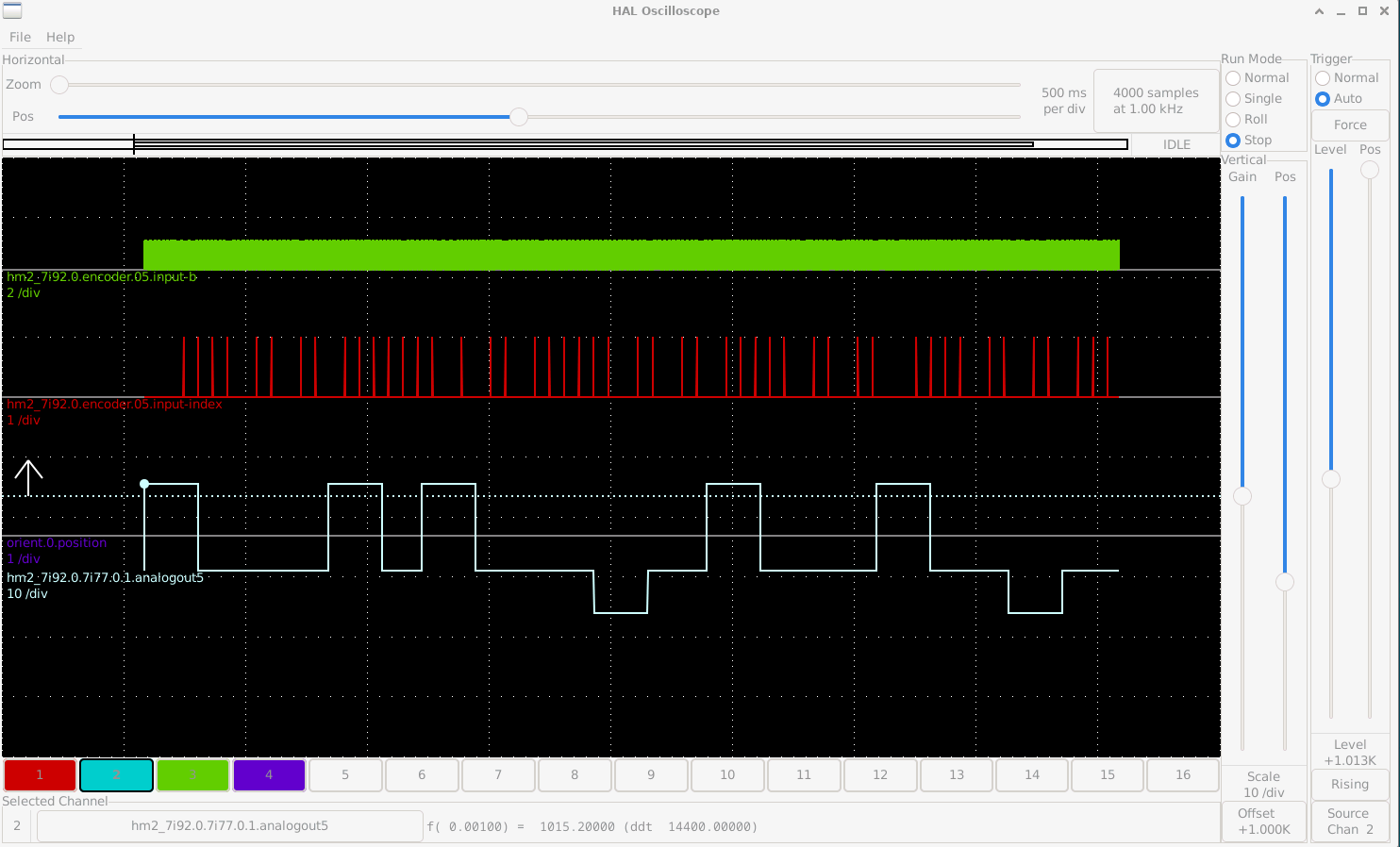

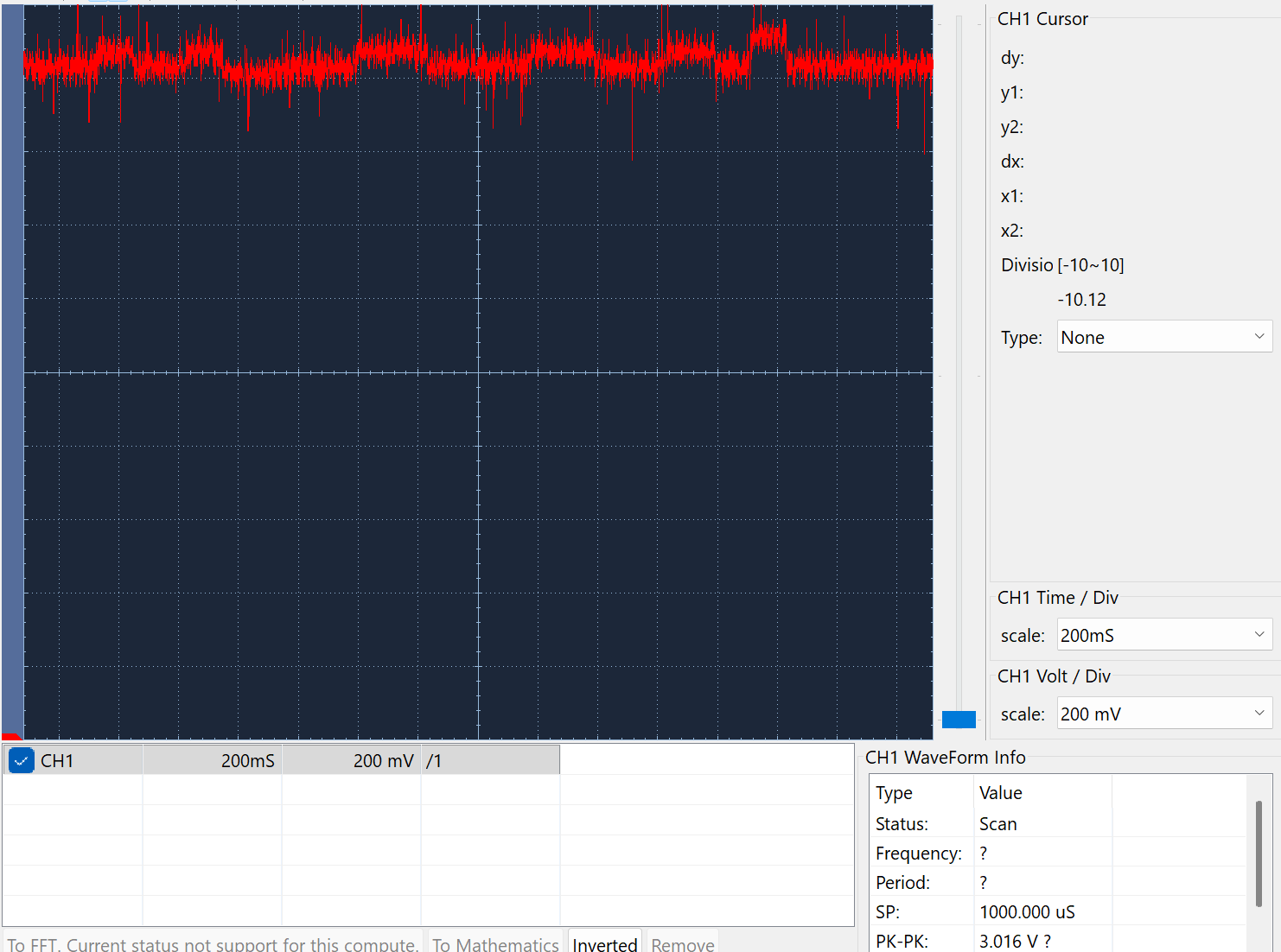

17 Feb 2026 13:50 #343094
by NT4Boy
Replied by NT4Boy on topic HURCO KMB-1 Control Update
I replaced the spindle motor VFD, three phase outpout and the speed signal is 0-10v.
I notice that the speed varies in a random way and at say 1000 rpm, I get steps of 15 to 30 plus and minus.
The fuzzy line is an oscilloscope trace of the analogout5 pin on the 7i77.
The lower halscope trace is the same pin also nominally at 1000, offset and magnified to show what I can hear.
I have started the spindle using MDI with M3 S1000.
Any ideas what maye be going on?

Replied by PCW on topic HURCO KMB-1 Control Update
If this is closed loop, I would check for issues with the encoder setup
or PID setup
Is the encoder velocity used for feedback?
or PID setup

17 Feb 2026 19:22 #343110
by NT4Boy
Peter,
No its open loop. I've got all the gains at zero bar FF0=1.
I do have an encoder though.
If it's open loop, the question becomes what is changing the analog out command?
(bottom trace second plot)
Ok Peter, so that is resetting my original understanding. But I have been unable to get the index pulse, which is clearly present in halscope to trigger the position reset. The sensors I am using for both the toothed wheel (a pair in quadrature) and a separaste index tooth, is ATS616LSG by Allegro.
Datasheet
Just wondering if there is some magic in the devices that makes them unsuitable here. ( a straw to clutch at).
Re the speed variation, then I don't think there is anything in the config that is altering the analogout.
I have these:- But I think they are only used for the pyvcp speed display bar and at speed led. Can the act of processing them anyway do something? I guess the thing to try is a minimum basic clean build and see what goes from there.
