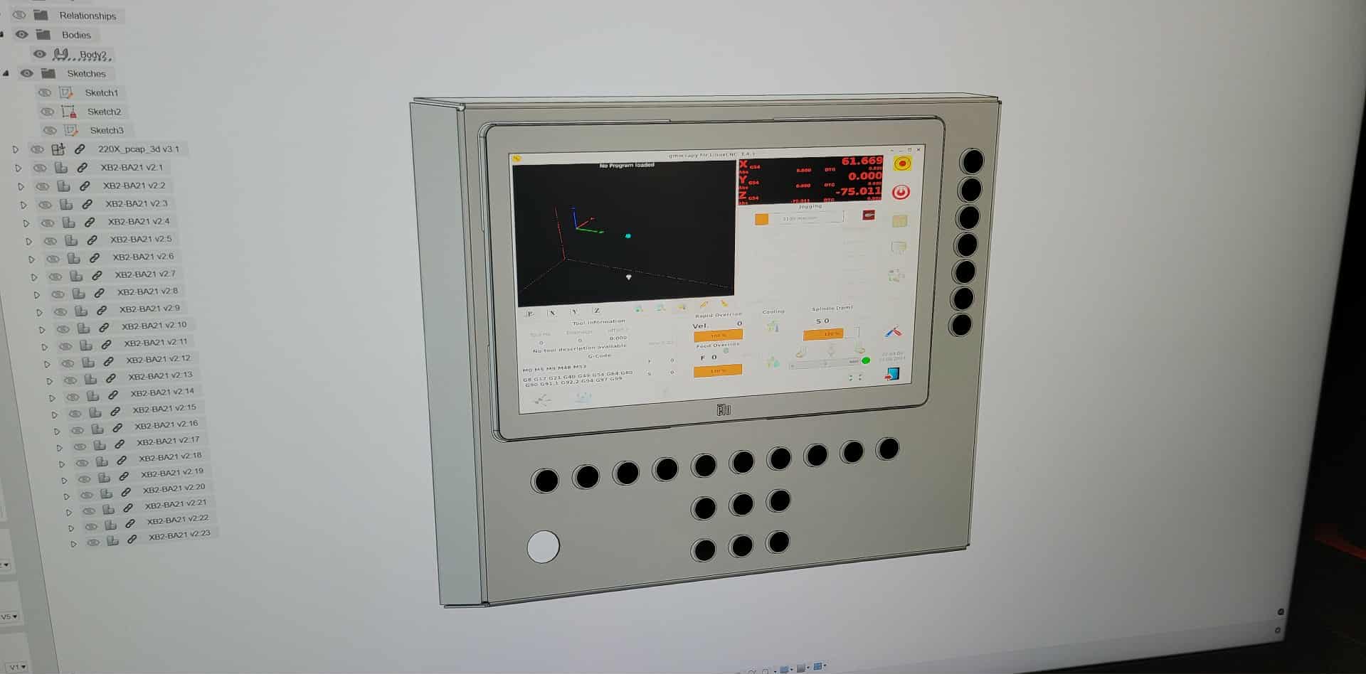

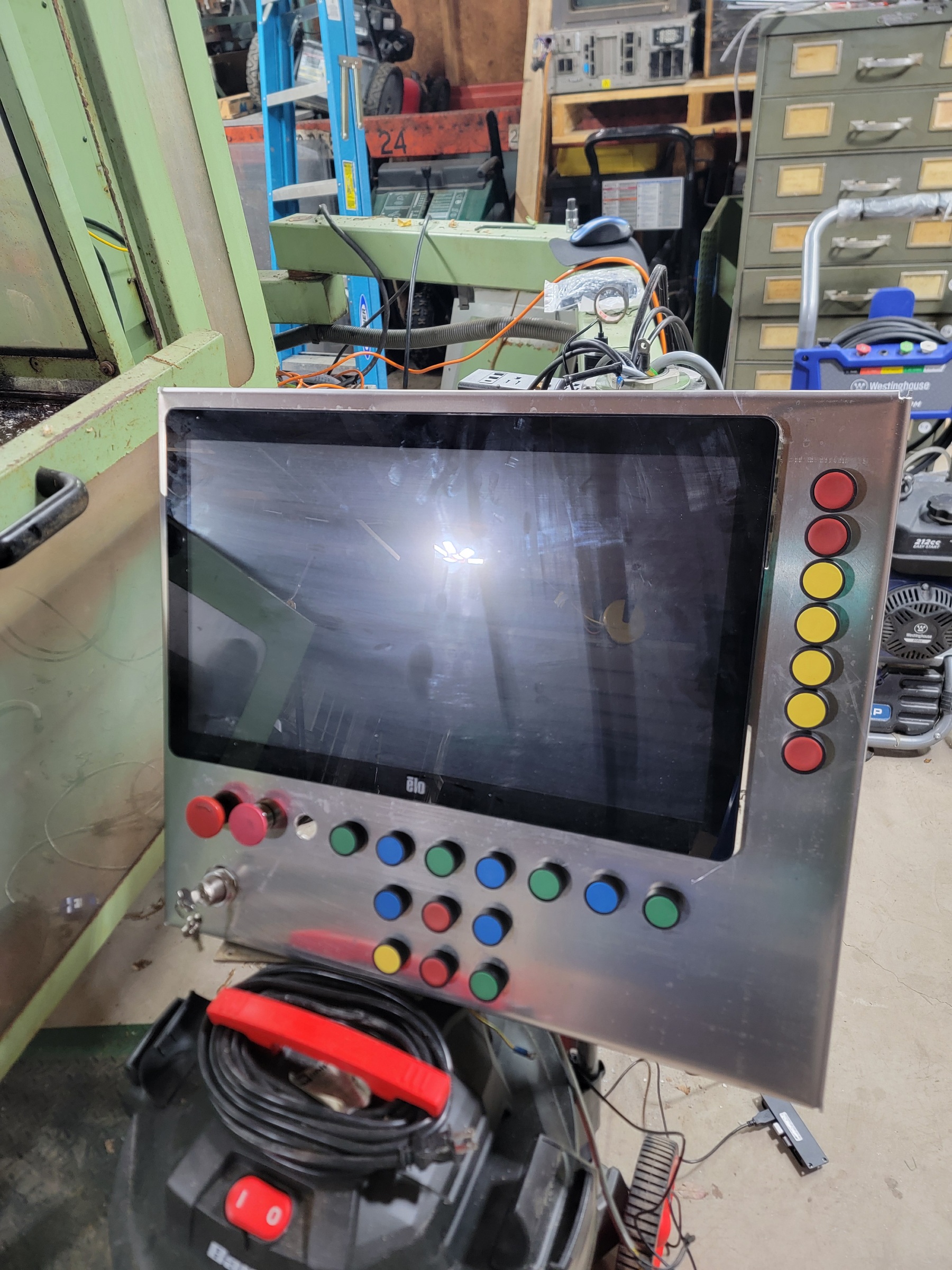

01 Nov 2025 23:40 #337682
by Cooped-Up
Replied by Cooped-Up on topic Maho MH800e Retrofit Project
I find little bits of time in the morning before work and whenever else I can squeeze out to the garage. I have gotten the machine to the point where it all homes properly granted very very slowly. It then moves to home position. Yesterday I designed a basic control panel for the monitor which I also got the touchscreen this week. I had enough time at to different points in the day to cut and then later bend up and partially assemble the control. Need a lot more time to wire it all up and change the program to use the 7i73 for the control interface. In the future I plan on adding 2 override encoders as well as an mpg either on the panel or on a pendant as well as 2 or 3 USB ports
