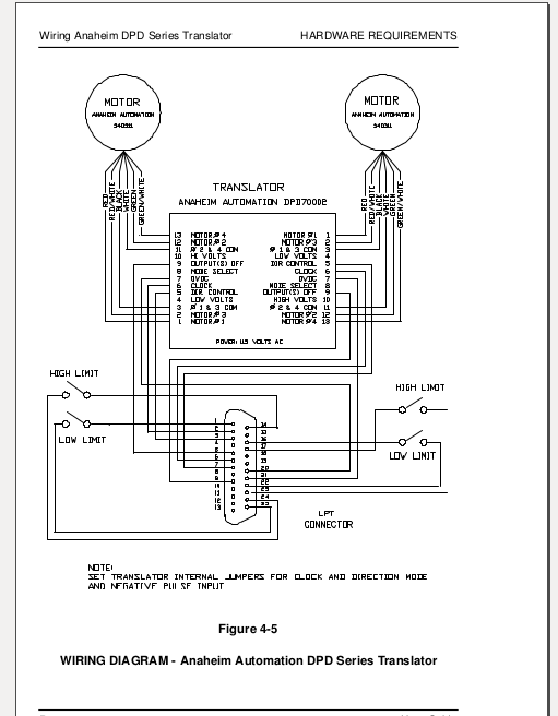

10 May 2013 00:30 #33850 by allenwg2005
Replied by allenwg2005 on topic Please help, I need some addvise
Once again I apologize, it was the port assignment not pin I was supposed to be referring to.
(Good thing I copied the text to contradict myself). :silly:
Arceye, I'm certain your advice on the step wizard is spot on!
I have attached a zip folder of the config. (At lest I think this will work, we'll see after I click "submit").
I could be wrong here but I think the attached screen shot of the wiring diagram may be safer than my doing a spread sheet. (I can't even make a clear delineation between a port address and a pin number)! :S
***Please note I did make the changes Todd shared, pin 1 to 10, 14 to 11, 16 to 12, 17 to 13***
Those are the only differences from the diagram. Let me know if this isn't inclusive enough.
I will dig into the drive and do some house cleaning/inspections, all the connections are surely due for some sorely needed attention.
When I start Lcnc and hit f1 the estop button background changes, when I hit f2 I get the following errors:
Joint 0 on limit switch error
Joint 1 on limit switch error
Joint 2 on limit switch error
What's all this?
