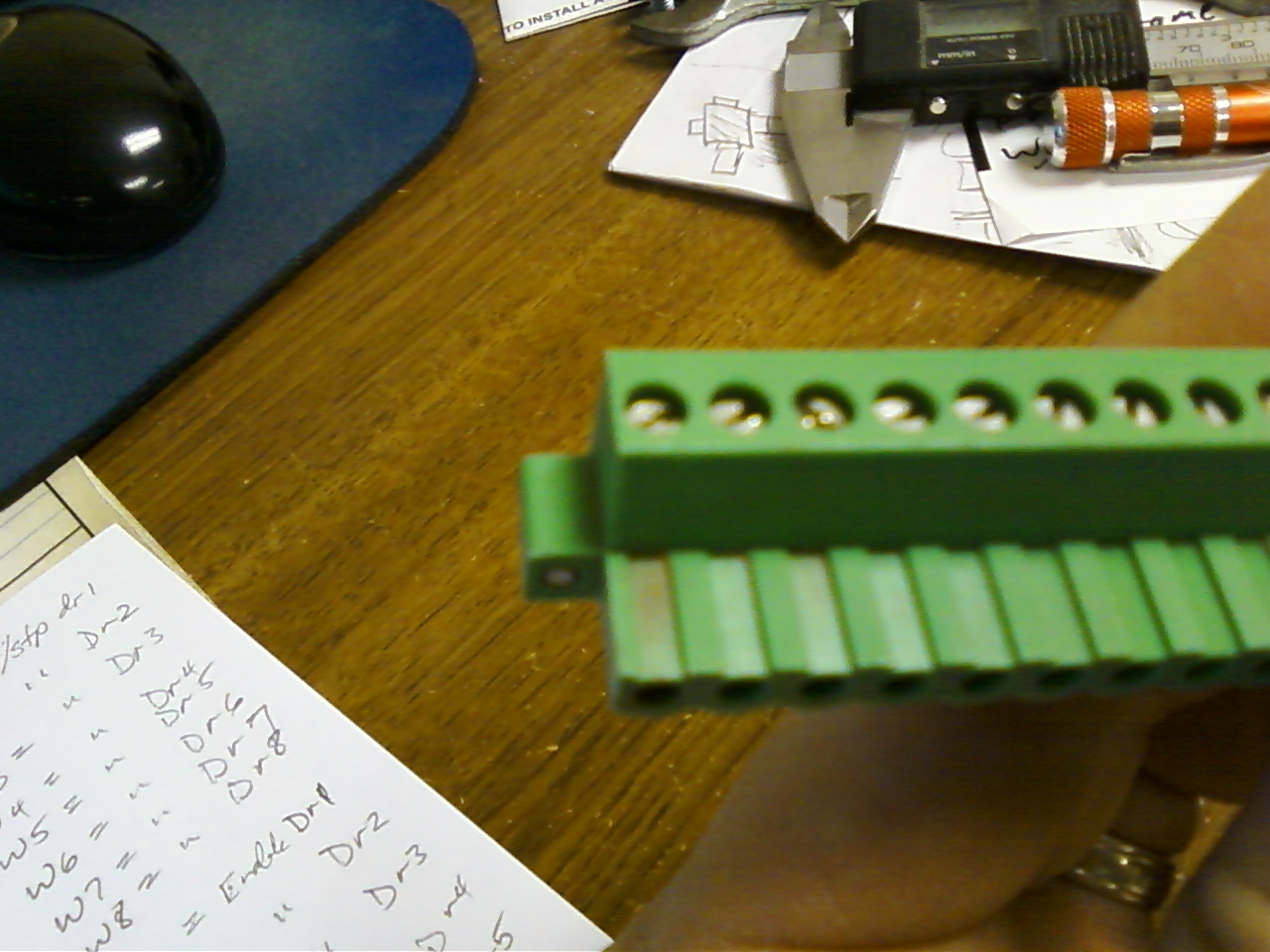

I personally have never had any problems using one of the limits for a home, but I also have always had all the switches individually wired. I know it uses more IO pins, but I haven't had that as a limitation, and niether does this fellow.
Here is the burned plug contact picture that I promised
The following user(s) said Thank You: allenwg2005

14 May 2013 05:03 #34039 by allenwg2005
Replied by allenwg2005 on topic Please help, I need some addvise
Thank you for the photo Todd, this is different than mine, but shows how careful you have to look for thermal damage that could create problems. Still working on cleaning.
