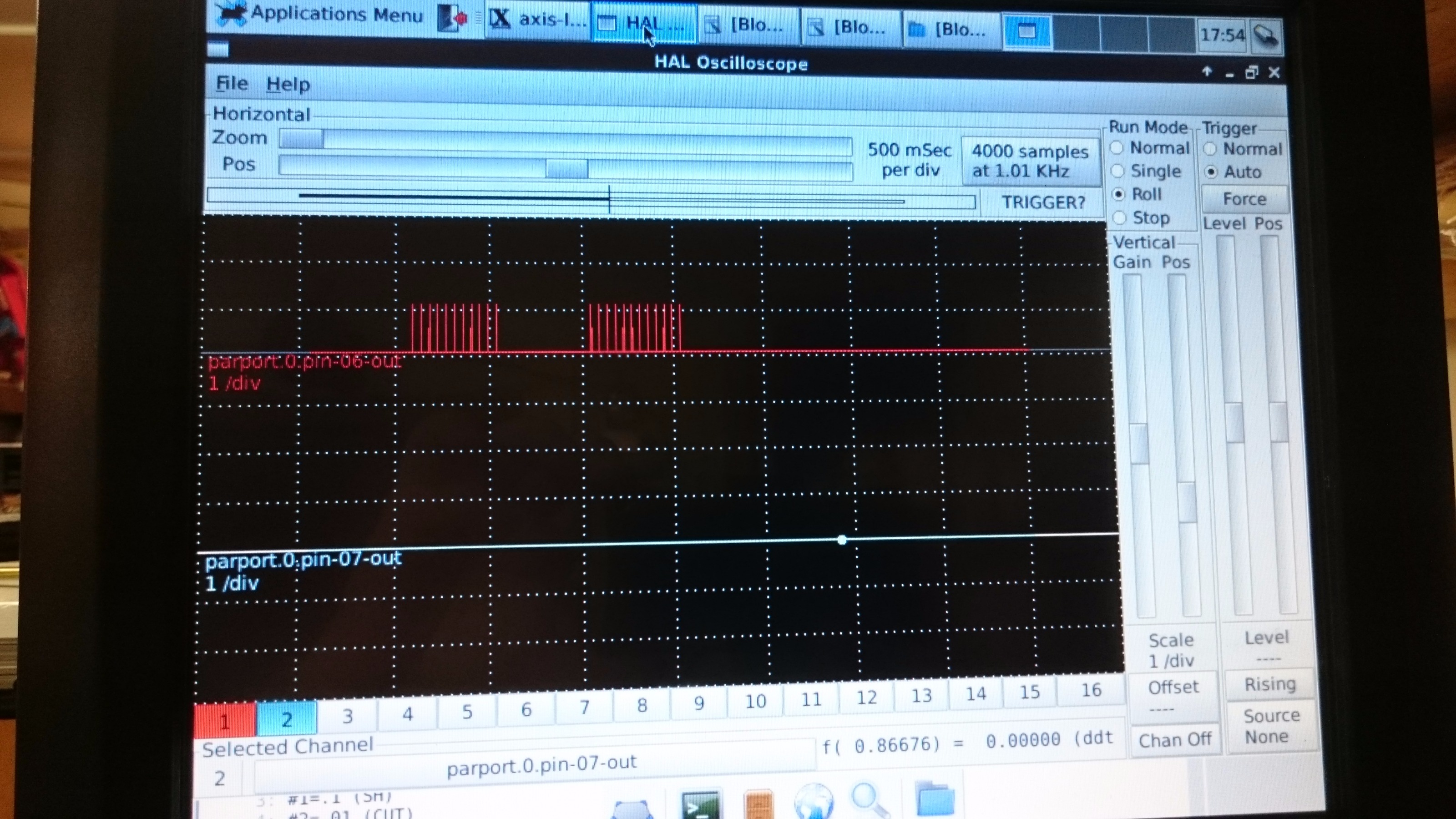

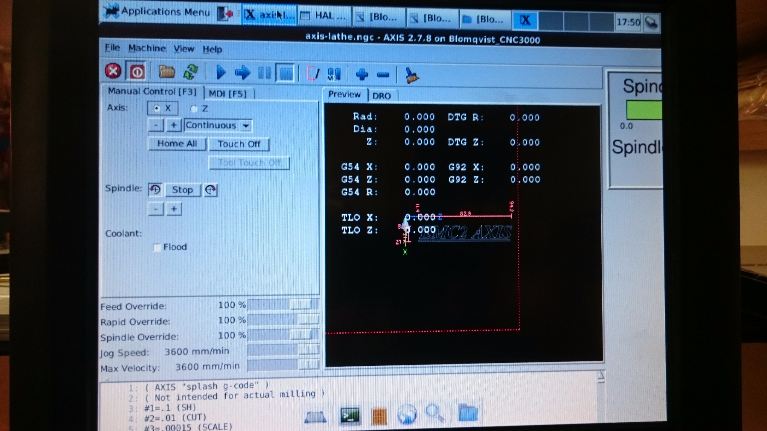

Can you try using Hal Scope to watch the parport.0.pin-06-out and parport.0.pin-07-out pins?
Ask if you need instructions how to do that.
Wait, just had an epiphany. Duh, I think we forgot to connect the enable for the spindle's stepgen.
Add this line to your hal file.
net spindle-enable <= motion.spindle-on => stepgen.2.enable

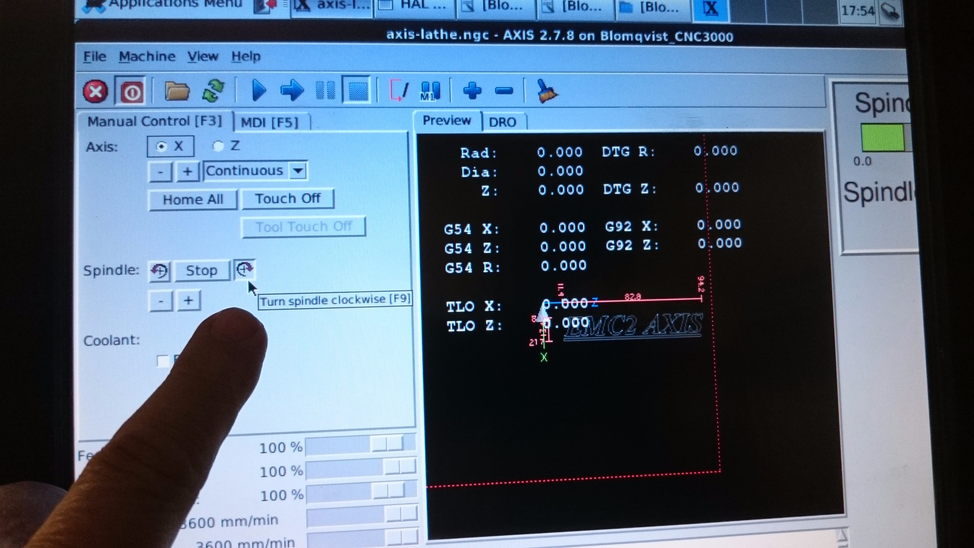

22 Apr 2017 16:01 #91853
by tecno
Replied by tecno on topic Mach3 XML and Stepconfig issues.

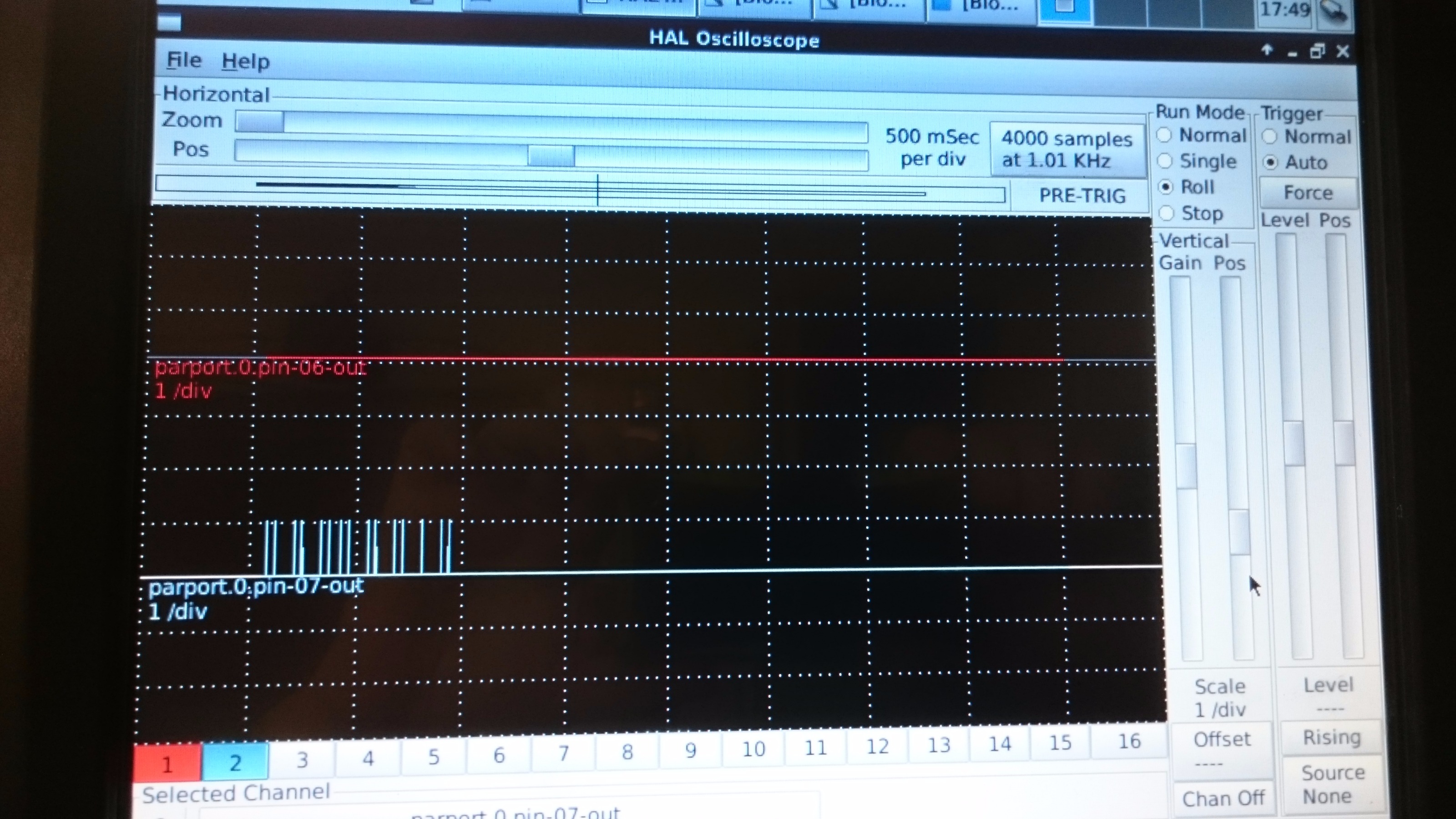

So now we have clockwise F9 working
- tecno
- Posts: 1850
- Thank you received: 127
22 Apr 2017 16:16 #91854
by tecno
Pin 7 is not changing direction, pulses only on pin 6 for steps and 7 to go high or low.
How to change this?
How to change this?
- Todd Zuercher
- Posts: 4781
- Thank you received: 1471
22 Apr 2017 20:20 #91859
Replied by Todd Zuercher on topic Mach3 XML and Stepconfig issues.
The way I understood what you wanted, pin 6 should get the clockwise pulses and pin 7 should get the counter clockwise pulses. Is that not what you wanted?
If you want all the step pulses on 6 and toggle a direction bit on pin 7. it is as simple changing one parameter value and changing a couple of pin names.
Change these lines:to
Change these lines:
loadrt stepgen step_type=0,0,1 ctrl_type=p,p,v
net spindle-cw <= stepgen.2.up
net spindle-ccw <= stepgen.2.downloadrt stepgen step_type=0,0,0 ctrl_type=p,p,v
net spindle-cw <= stepgen.2.step
net spindle-ccw <= stepgen.2.dir Please Log in or Create an account to join the conversation.
