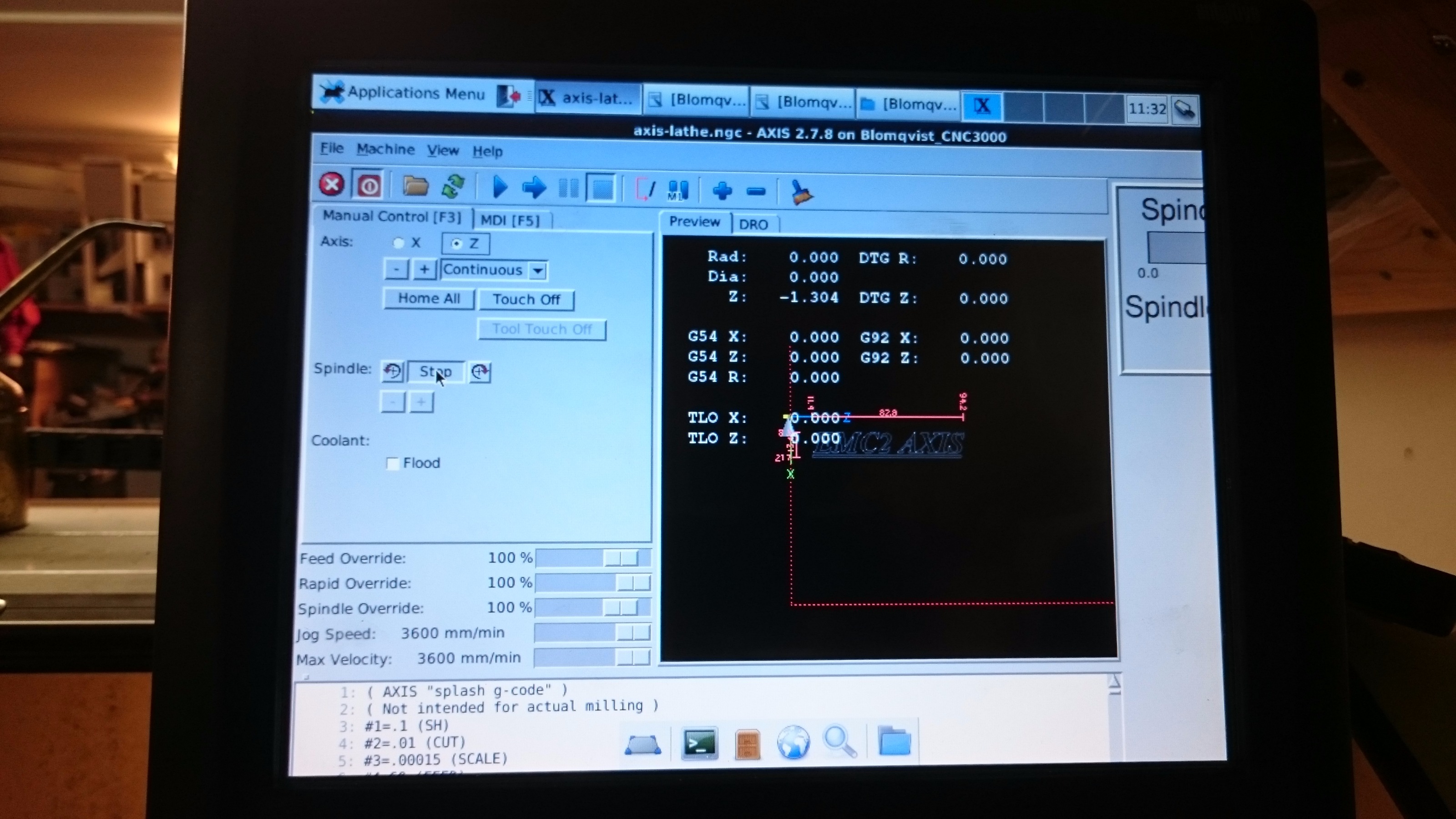

Jogging issues. Lathe.
X axis moves correct with keyboard and -+ on screen but homing in wrong direction (assuming rear tools) and I use front tools.
Z axis moves opposite direction but homing is correct.
How to change this behavior?
Cheers
Bengt
Cheers
Bengt

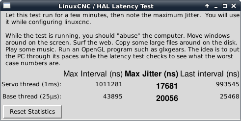

24 Apr 2017 13:38 #91960
by tecno
Replied by tecno on topic Mach3 XML and Stepconfig issues.
- Todd Zuercher
- Posts: 4781
- Thank you received: 1471
24 Apr 2017 13:50 #91963
Replied by Todd Zuercher on topic Mach3 XML and Stepconfig issues.
That doesn't seem too bad, if it was for a long enough duration of time, with a sufficient load on the system.
Could you try running the Latency Histogram, from the apps section of the config picker.
I am kind of baffled.
