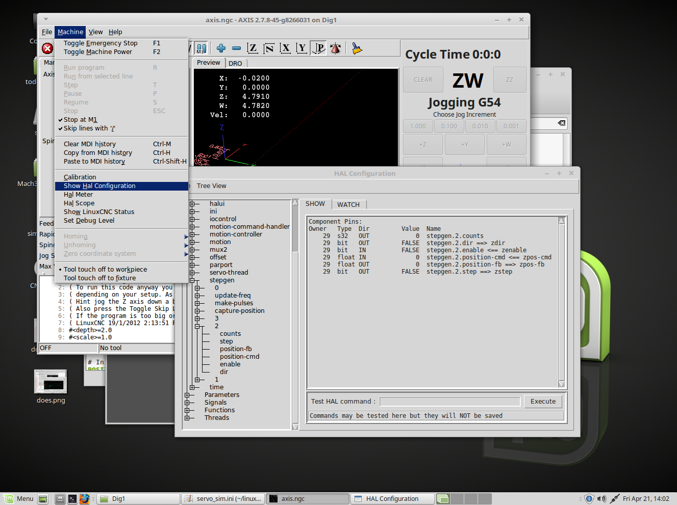

Now I get into LCNC but still no spindel action.
Found a typo in the line in question.
- Todd Zuercher
- Posts: 4781
- Thank you received: 1471
21 Apr 2017 18:08 #91799
Replied by Todd Zuercher on topic Mach3 XML and Stepconfig issues.
If Linuxcnc now opens. Then you can use its diagnostic tools to see what is (or isn't) happening.
Look at the pins for stepgen.2 that you are trying to connect to run the spindle. Does it have a pin called stepgen.2.velocity-cmd?
if you select the watch tab and select that pin. does it's value change when you try to turn on the spindle?

Yes the watch shows 0 and -1 and 1, adjusting rpm values changes accordingly
- Todd Zuercher
- Posts: 4781
22 Apr 2017 12:12 #91837
That is good to hear, That means that part of the connection is working.
When you set say 1000rmp what is the result?
also look at the values for the pin stepgen.2.up and stepgen.2.down.
They are the step pulse signal that is to be sent to the parallel port pins.
(You might only be able to notice them blinking at low frequencies.)
It is probable that you need to change the step pulse length for your chip to to be able to detect them.
Change the 1 in this line to what ever it should be or try a reasonably large number, something like 250000and add a line for stepspace and set it to the same number as step length.by adding this line.
setp stepgen.2.steplen 1setp stepgen.2.stepspace 250000Please Log in or Create an account to join the conversation.
