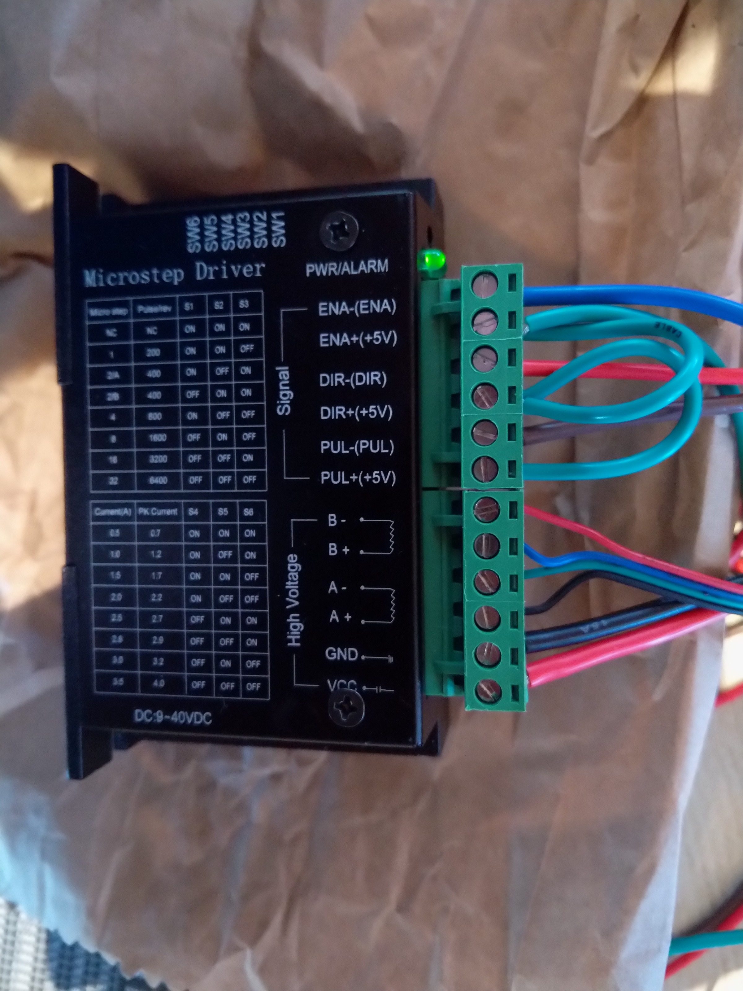

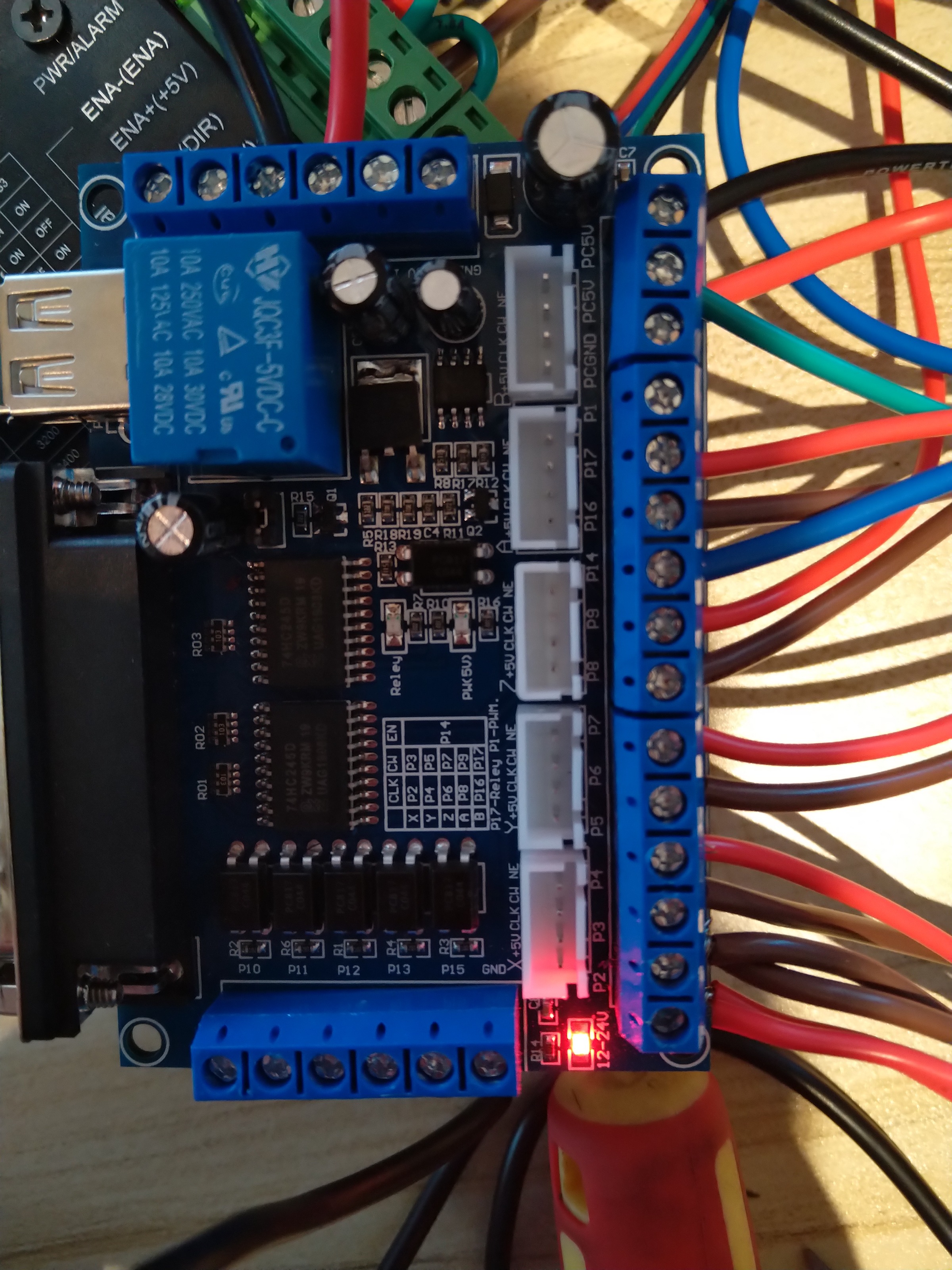

I have tried reversing the cables on pins 2 and 3 so that PUL- is on pin 3 and ENA- is on pin 2 and still get the same clicking noise out of the z axis motor regardless of which axis I'm testing.
The BOB is a cheap one I found on AliExpress
m.aliexpress.com/item/32969585672.html?s...70050f88b4ab5&is_c=N I have also attached some photos to show my wiring, unfortunately it's a bit of a rat's nest as I'm trying to test it on my desk before I put in a proper enclosure.
That is just one of the driver's but there are 6 in total (2x for X axis as you can see 2 red and 2 brown wires coming out of pins 2/3)
What other information would be helpful in trying to sort out this issue?

Additional info
PUL+
DIR+
ENA+ are all looped together and running to the second to last PC5V pin,
ENA- is connected to pin 14
All motors have these cables looped together (all 5 axis)
they all run to one busbar and then all come into the PC5V pin as well as pin 14.
The cables going to the PC5V and pin 14 are separate from each other but together for all drivers. I think I made it sound like they are all looped together
PUL+
DIR+

You do need to have a USB cable plugged in to provide 5V for the logic on the board.

Sorry the photo didn't show it but I have a power supply for the BOB only and tried both with and without USB 5v power supply and still no luck.

You do need both.
Can you draw a wiring diagram of what you have
Edit: most of those drives have a inverted enable, so you could try with ENA disconnected.

Do not wire the enable signal, those drives are enabled by default and use the "enable" signal to actually disable them.
After getting them to work you can wire and configure the enable signal.

Is that ENA+ or ENA- or both?
I have attached some photos of the wiring diagram, wired as I had it before. I have taken it apart and only wired 1 motor and I couldn't even get that going. Motor is on pins 2 (PUL-) and 3 (DIR-).
