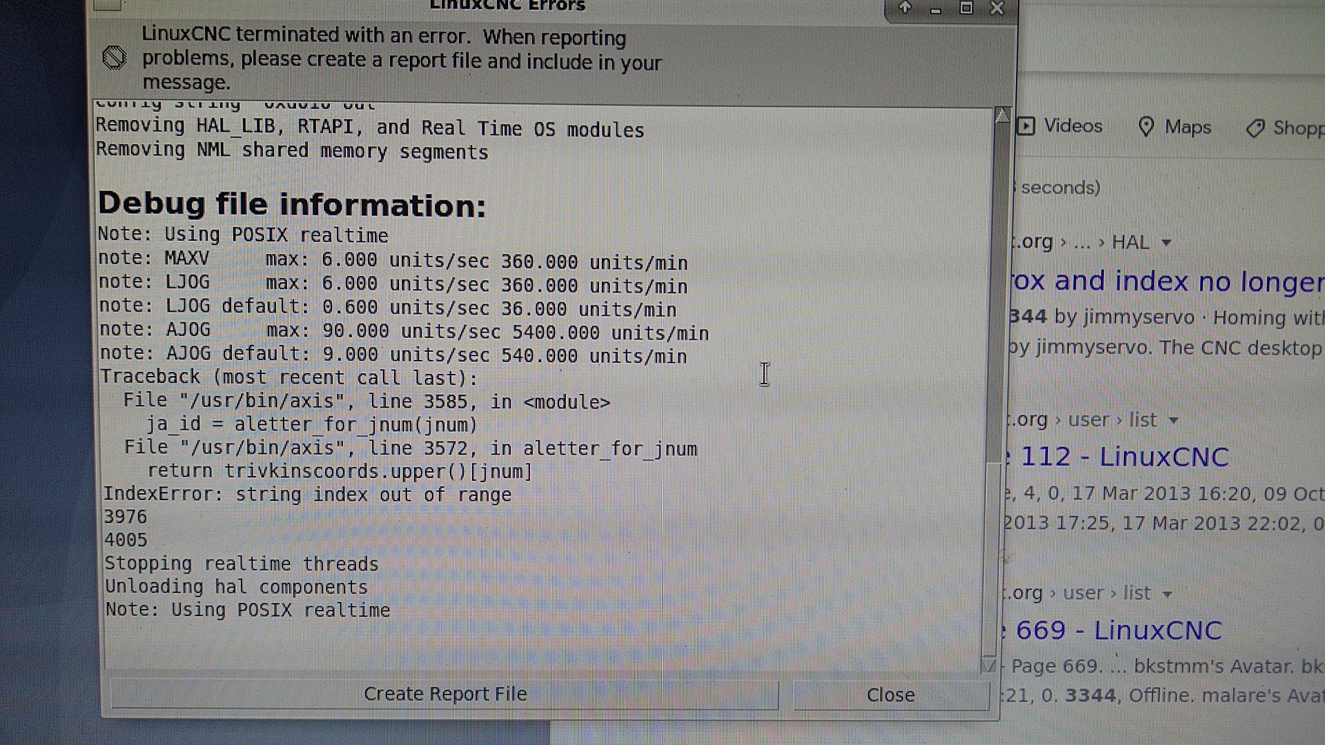

- CNCApples
- Posts: 22
29 Aug 2021 10:24 #219085
by CNCApples
Replied by CNCApples on topic Need help setting up parallel port on new build
- phillc54
- Posts: 5711
- Thank you received: 2100
29 Aug 2021 10:29 #219086
by phillc54
Replied by phillc54 on topic Need help setting up parallel port on new build
You will need a 'U' here as well.
KINEMATICS = trivkins coordinates=XYZAPlease Log in or Create an account to join the conversation.
- CNCApples
- Posts: 22
29 Aug 2021 10:58 #219089
by CNCApples
It Runs. Thank you so much for all your help!
I am indebted to you!
