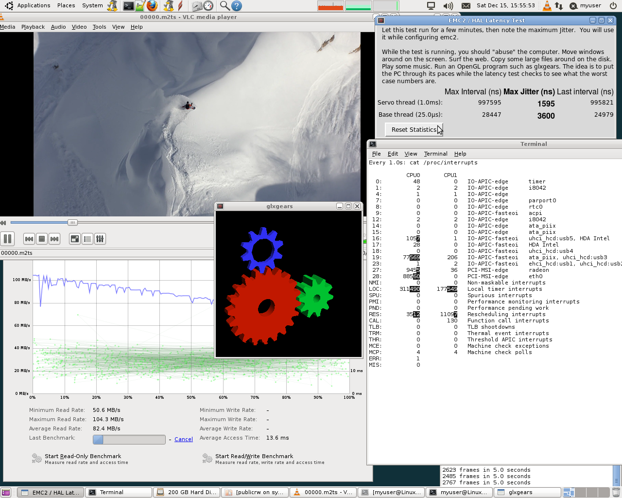

15 Dec 2012 22:27 #27768 by RGH
Okay - I never said that this would magically solve all high latency problems or something. That it does not change anything on your machine just means that the latency was not induced by the handling of an IRQ, right?
The low latency values I get are NOT because I changed something in the BIOS by accident like C1E or something!!! That's not me. Maybe I should elaborate a bit more on my testing and optimization process. I spend days with it running different old machines I had collecting dust and looking for the best one for linuxcnc.
Initial test to get a picture was with bios default settings which gave me a regular jitter of around 15000ns with peaks of 30000+ (no isolcpus). Next was changing all obvious values in the bios like c1e, SpeedStep ect. and suspicious values like hardware monitoring, temperature regulation of the cpu fan and others and setting isolcpus. After further tests, re-enabling ACPI 2.0 and fixing the sleep mode to S3 (instead of AUTO) resulted in <4000ns jitter nearly all the time with irregular peaks of up to 10000ns that happened during really heavy testing for the period of an hour. The next step was changing back "not so obvious" values in the bios to see which had an influence and which not (keeping all cpu settings but TM and disable bit off!), trying other vga-cards and more and more tests that revealed that reserving irqs in the pnp configuration changed the rate at which the 10000ns peaks happened. That lead me to the irq stuff. Observing the cpu usage showed that the second cpu irregularly jumped to 2% load although it was isolated. Watching the irq handling revealed that the second cpu was doing a lot of the handling, changed that with the attached scripts and the peak 10000ns values were gone! Changing the affinity mask to F still shows the peak ~10000ns values after running the machine under heavy load for a longer period of time.
So NO! This is not wishful thinking but a measure with reproducible effects on two core2duo machines!
Actually I think that it is quiet obvious that unloading the cpu on which the realtime stuff happens CAN have an impact. At least if the max jitter on a machine happens while handling an interrupt request and is not induced by something else.
Cheers,
Ruben
PS: In the meantime I installed the software opengl drivers in order to be able to start linuxcnc in a remote NX session. I will have to do dedicated testing to see what is going on but when using the remote session (normal "administration work", browsing and doing this and that) the jitter is even lower now at around 1800ns :huh:
15 Dec 2012 22:31 - 15 Dec 2012 23:01 #27769 by RGH
@Anders
I will make a screenshot and post it.
How do you create that histograms? Are the jitter values logged and I don't even know?
Thanks,
Ruben
Last edit: 15 Dec 2012 23:01 by RGH. Reason: added attachment
The following user(s) said Thank You: tensor
