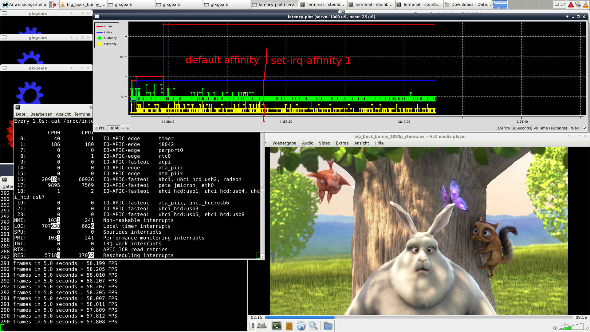

28 Nov 2015 11:43 - 29 Nov 2015 17:24 #65930
by steinbeisser
Replied by steinbeisser on topic Reducing latency on multicore pc's - Success!
I tried Spainman's scripts on my machine and they seem to improve my latency.
My machine:
Club3D ATI Radeon X300 256MB PCI-E Silent
Gigabyte GA-P35-DS4 rev1.0
Intel Core2Duo E8400
4x1GB Ram
WD IDE HDD
BIOS settings:
All peripherals set to OFF, except LAN and LPT
Every setting that seems to alter the clock for power saving or performance: OFF
Kernel parameters copied from Spainman's first post in this thread:
"isolcpus=1 acpi_irq_nobalance noirqbalance"
In the attached picture, you can see
- latency-plot
- 3x gxlgears
- 1080p Big Buck Bunny
It seems like the upstart script provided by Spainman doesn't work with debian, so i called his set-irq-affinity script manually.
In the plot, i highlighted the point in time when i called "set-irq-affinity 1"
As you can see the latency spikes are reduced after this.

It seems like i was a bit lucky taking this screenshot. It is true, that setting irq-affinity 1 calms down the small spikes, but sadly the huge spikes of ~17k are still happening, even with irq-affinity 1.

@Doc Alex:
I think this has to be one line. you have to add it to the line you already have.
For example:
GRUB_CMDLINE_LINUX_DEFAULT="isolcpus=1 acpi_irq_nobalance noirqbalance lapic quiet rootdelay=5"
@qthree:
The reason might be, that the upstart script doesn't work on debian (at least it doesn't work on my machine)
I have no idea how this upstart stuff works, so i hope someone here can help us with this
