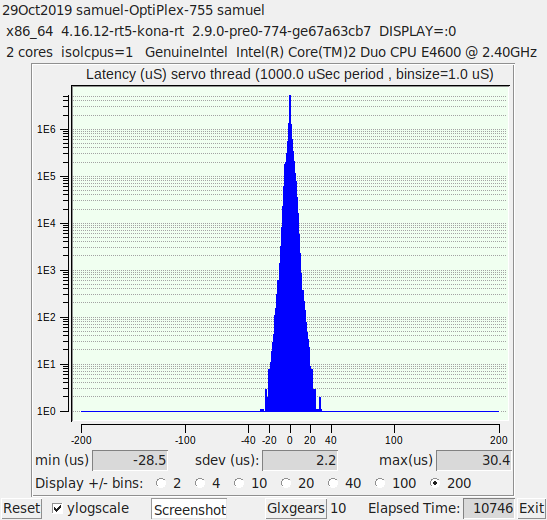

29 Oct 2019 14:06 - 29 Oct 2019 14:07 #149070
by Samuelx
Replied by Samuelx on topic Reducing latency on multicore pc's - Success!
I had bad latency 200+
Thank you for your advise. Now its 30.
I am happy
Dell 755 intel core a duo 2,4ghz
2gb ram
integrated video card
I also modified /etc/default/grub
GRUB_CMDLINE_LINUX_DEFAULT="quiet splash isolcpus=1 acpi_irq_nobalance noirqbalance nohlt idle=poll radeon.modeset=0"
10 X glxgears and youtube playing video
I am happy
2gb ram

01 Nov 2019 08:23 #149354
Replied by andypugh on topic Reducing latency on multicore pc's - Success!
30 is good, there is no point trying for any better. Especially as it might reduce non-realtime performance.

04 Nov 2019 06:57 - 04 Nov 2019 06:58 #149541
by Samuelx
Orginaly it was integrated graphic card, I change the graphic card to AMD radeon HD 8570 1GB DDR3 and latency jumped. Ther might be driever problem. any suggestions what to do?
