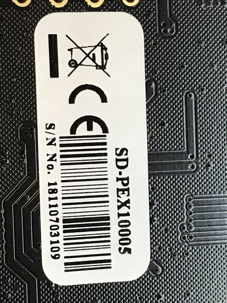

Jon's advice is expert, and I and others have confirmed this PCIe parallel port card as a "warrant" (something you can readily buy new at retail today, that is known to work with current LinuxCNC). It is also a well-made board but very low priced.
But please see the qualifications I reported on this expansion card in this thread . One precaution is that "Syba" is not the "make", just an U.S. importer/labeler/marketer of mystery China boards, and part number "Syba SD-PEX10005" does not definitely identify the product "model", because Syba has delivered a variety of at least two physically different boards bearing stickers with this same part number (and this number is just on a sticker, not the board itself, the actual board bears no indication of identity in brand or part number). So "Syba SD-PEX10005" is not a concrete "make and model" specification in the engineering sense (which is the only sense that matters), just a silk-market moniker for what Syba is selling lately. This sloppy Syba version identity is a potential problem, certainly in the past, and who knows if they won't confuse things worse in the future. Being a legacy-support product, with little market, made by careless engineering mimics in developing places, and imported carpet-bazaar style, this is all to be expected.
The factors of the Linux version, LinuxCNC version, and motherboard BIOS are also involved in getting parallel port expansion to work. Also as Jon mentions, the chip has an EEPROM configuration that is invisible to you but has to be set properly at the factory, so you can't know if some "China quality control" mistake was made until you test the board, but you can't do that isolated test if you don't have a known-working reference system already using the board. You can't perform multi-factor diagnosis without isolation and known-good reference capabilities. But this "Syba SD-PEX10005" (with a confirmed version identity) is as safe a "warrant" against surprises and mystery as you can get these days, especially if you source it from Jon and his beneficial specimen-qualifying and testing.
Replied by Richard J Kinch on topic Please recommend PCI-E Parallel Port card
The ones I sell are marked Syba SD-PEX10005.

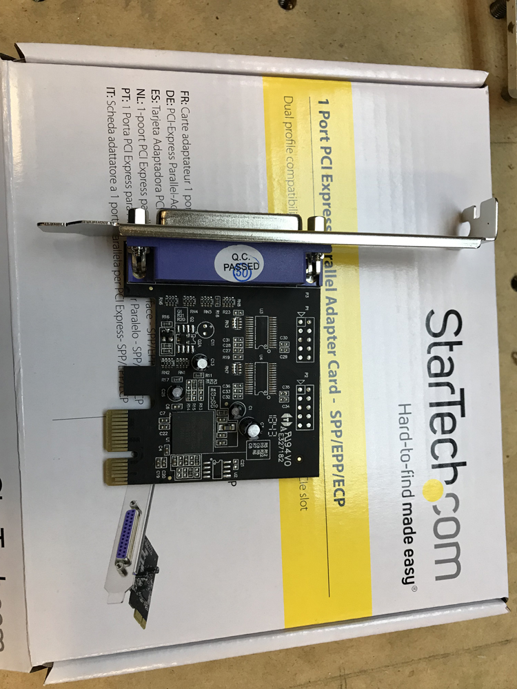

04 Apr 2019 07:48 - 04 Apr 2019 07:57 #130279
Replied by PCW on topic Please recommend PCI-E Parallel Port card
What is the actual problem, just the printed warning?
hal_parport is a very low level driver, AFAICT it does not need Linux driver
support at all (the port address = 0,1,2 shortcut would but that's about it)
edit: Also, what is the exact warning message?

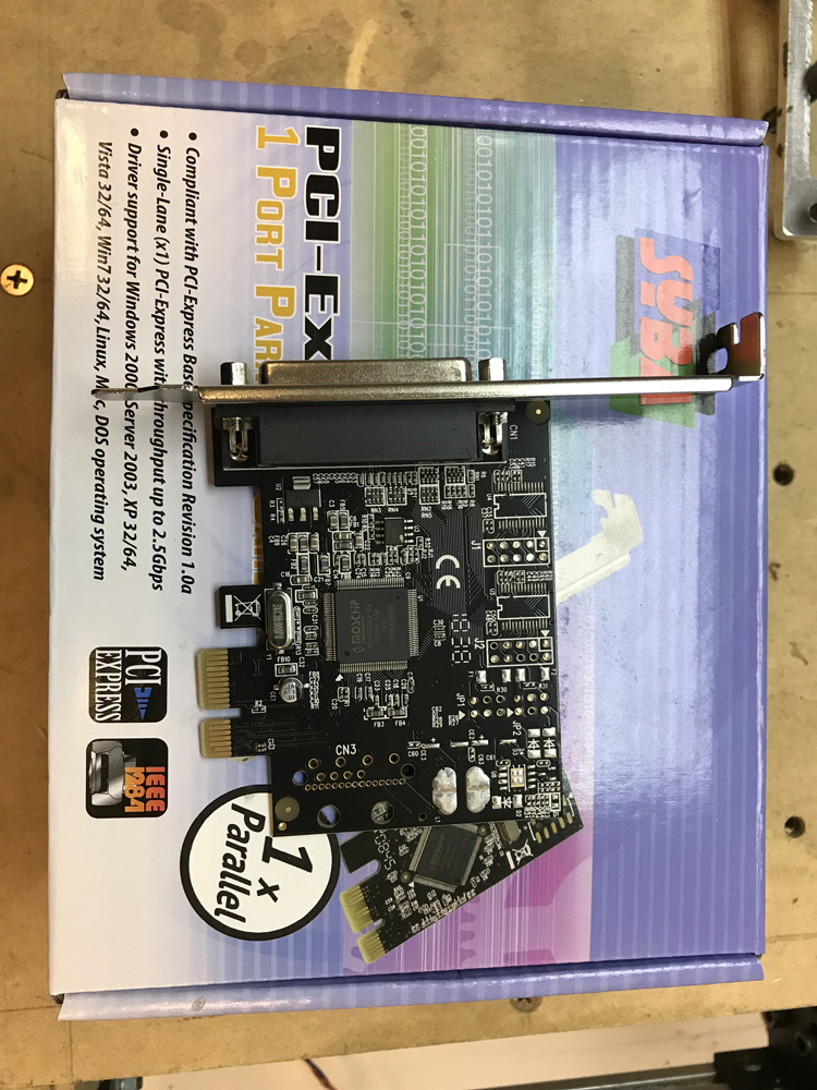

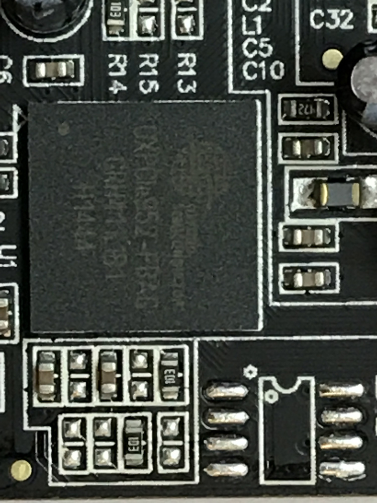

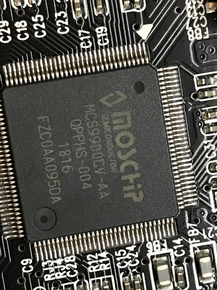

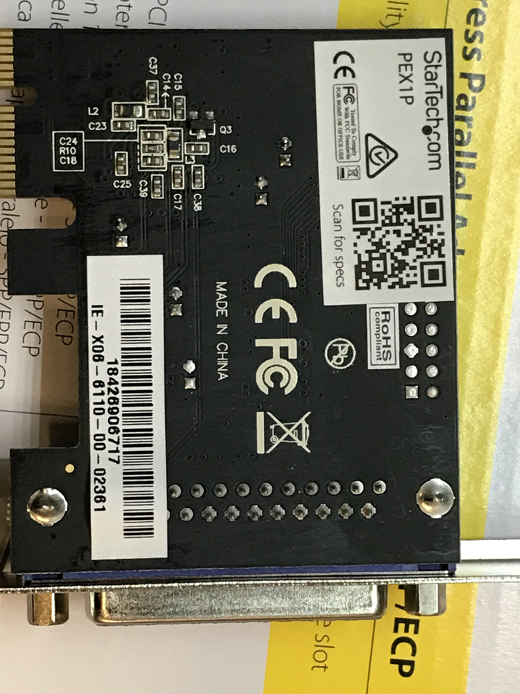

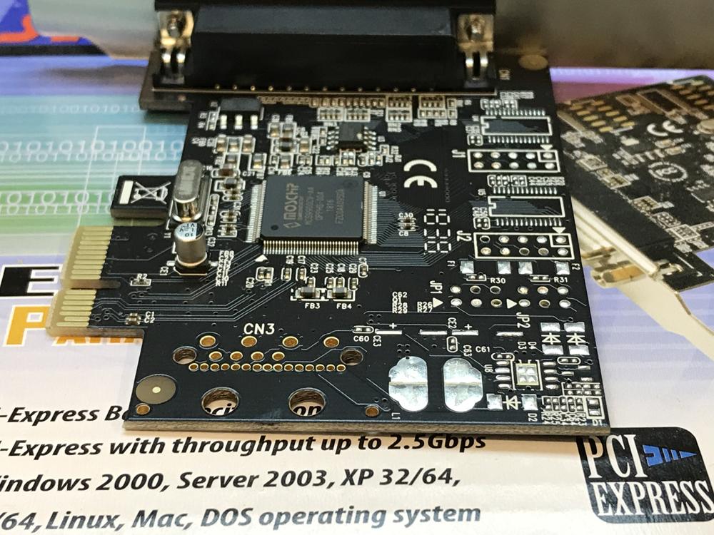

sorry, this will be a bit of a long post.
so here are the files and pics of the cards. the configuration is copied directly from a running machine, the differences are hardware and the old box is running wheezy and the new box is running stretch. it is a fresh install from the live cd, the only change is that it is upgraded to the 2.8 master.
old hardware:
core 2 duo, 2gb ram, onboard parport and pic parport, wheezy
new hardware:
ryzen 5, 8gb ram, syba and startech parports, stretch
originally, on the old box i was using 2.8.0-pre1-4572-g677d7b5 and after i tried the startech card i had unusual behavior (more on that later) so i updated to 2.8.0-pre1-4655-g39977ac31 this morning to eliminate variables. ran as expected.
output from original box:
output from new box with syba card:
the error i get when i run linuxcnc:it complains, but ultimately it works. dont really trust it tho
when i use address "0 out", it crashes on startup with:
i guess my understanding is that even tho the os doesnt recognize it as a true parallel port, linuxcnc can still address it directly? pretty spiffy.
so after i put in the startech card, this is the output:
so now it shows that i have a parallel port, and i can address it either by address or by shortcut, but now i have odd (REALLY BAD) behavior... for the homing sequence (XYZ on a XYYZ gantry), x homes normally, and only y1 homes while y0 is stationary (you can see how that doesnt end well...). luckily y axis was already homed and so only just past switches so no permanent damage done, but linuxcnc was stalled waiting for the homing sequence for y to complete.
while i dont have much knowledge in low level hardware, i was lead to believe that the os handled port to hardware address translation, so regardless of whether the parport is pci or pcie, the os should still see it as a parport and the addresses should still be the same? or am i going to have to redo the config files for the machine?
sorry for the long post, but had a lot of details to get out and thanks for all the replies! just in case, i am including my config directory.
lspci -vvv
05:00.0 Parallel controller: Oxford Semiconductor Ltd Device c110 (prog-if 02 [ECP])
Subsystem: Oxford Semiconductor Ltd Device c110
Control: I/O+ Mem+ BusMaster+ SpecCycle- MemWINV- VGASnoop- ParErr- Stepping- SERR- FastB2B- DisINTx-
Status: Cap+ 66MHz- UDF- FastB2B- ParErr- DEVSEL=fast >TAbort- <TAbort- <MAbort- >SERR- <PERR- INTx-
Latency: 0, Cache Line Size: 64 bytes
Interrupt: pin A routed to IRQ 31
Region 0: I/O ports at e010 [size=8]
Region 1: I/O ports at e000 [size=4]
Capabilities: [40] Power Management version 3
Flags: PMEClk- DSI- D1+ D2+ AuxCurrent=55mA PME(D0-,D1+,D2+,D3hot+,D3cold+)
Status: D0 NoSoftRst+ PME-Enable- DSel=0 DScale=0 PME-
Capabilities: [50] MSI: Enable- Count=1/1 Maskable- 64bit+
Address: 0000000000000000 Data: 0000
Capabilities: [70] Express (v1) Legacy Endpoint, MSI 00
DevCap: MaxPayload 128 bytes, PhantFunc 0, Latency L0s <128ns, L1 <2us
ExtTag- AttnBtn- AttnInd- PwrInd- RBE+ FLReset-
DevCtl: Report errors: Correctable- Non-Fatal- Fatal- Unsupported-
RlxdOrd+ ExtTag- PhantFunc- AuxPwr- NoSnoop-
MaxPayload 128 bytes, MaxReadReq 512 bytes
DevSta: CorrErr- UncorrErr- FatalErr- UnsuppReq- AuxPwr+ TransPend-
LnkCap: Port #0, Speed 2.5GT/s, Width x1, ASPM L0s L1, Exit Latency L0s unlimited, L1 unlimited
ClockPM+ Surprise- LLActRep- BwNot- ASPMOptComp-
LnkCtl: ASPM Disabled; RCB 64 bytes Disabled- CommClk+
ExtSynch- ClockPM- AutWidDis- BWInt- AutBWInt-
LnkSta: Speed 2.5GT/s, Width x1, TrErr- Train- SlotClk+ DLActive- BWMgmt- ABWMgmt-
Capabilities: [100 v1] Device Serial Number 00-30-e0-11-11-00-01-10
Capabilities: [110 v1] Power Budgeting <?>
Kernel driver in use: parport_pc
Kernel modules: parport_pc
dmesg | grep par
0.000000] Booting paravirtualized kernel on bare hardware
[ 0.007749] AppArmor: AppArmor disabled by boot time parameter
[ 0.947038] acpi PNP0A08:00: [Firmware Info]: MMCONFIG for domain 0000 [bus 00-3f] only partially covers this bridge
[ 1.008753] hpet0: 3 comparators, 32-bit 14.318180 MHz counter
[ 1.468066] xhci_hcd 0000:01:00.0: hcc params 0x0200ef81 hci version 0x110 quirks 0x00000418
[ 1.469206] ahci 0000:01:00.1: SSS flag set, parallel bus scan disabled
[ 1.469241] ahci 0000:01:00.1: flags: 64bit ncq sntf stag pm led clo only pmp pio slum part sxs deso sadm sds apst
[ 1.469252] xhci_hcd 0000:08:00.3: hcc params 0x0270f665 hci version 0x100 quirks 0x00000418
[ 1.484800] ahci 0000:09:00.2: flags: 64bit ncq sntf ilck pm led clo only pmp fbs pio slum part sxs
[ 3.005576] PM: Hibernation image partition 8:5 present
[ 3.353273] ppdev: user-space parallel port driver
[ 3.359192] PCI parallel port detected: 1415:c110, I/O at 0xe010(0xe000), IRQ 31
[ 3.359491] parport0: PC-style at 0xe010 (0xe000), irq 31 [PCSPP,TRISTATE,EPP]
[ 3.463724] lp0: using parport0 (interrupt-driven).so now it shows that i have a parallel port, and i can address it either by address or by shortcut, but now i have odd (REALLY BAD) behavior... for the homing sequence (XYZ on a XYYZ gantry), x homes normally, and only y1 homes while y0 is stationary (you can see how that doesnt end well...). luckily y axis was already homed and so only just past switches so no permanent damage done, but linuxcnc was stalled waiting for the homing sequence for y to complete.

04 Apr 2019 12:03 - 04 Apr 2019 12:05 #130300
by oddwick
Replied by oddwick on topic Please recommend PCI-E Parallel Port card
Last edit: 04 Apr 2019 12:05 by oddwick. Reason: pics in wrong order
