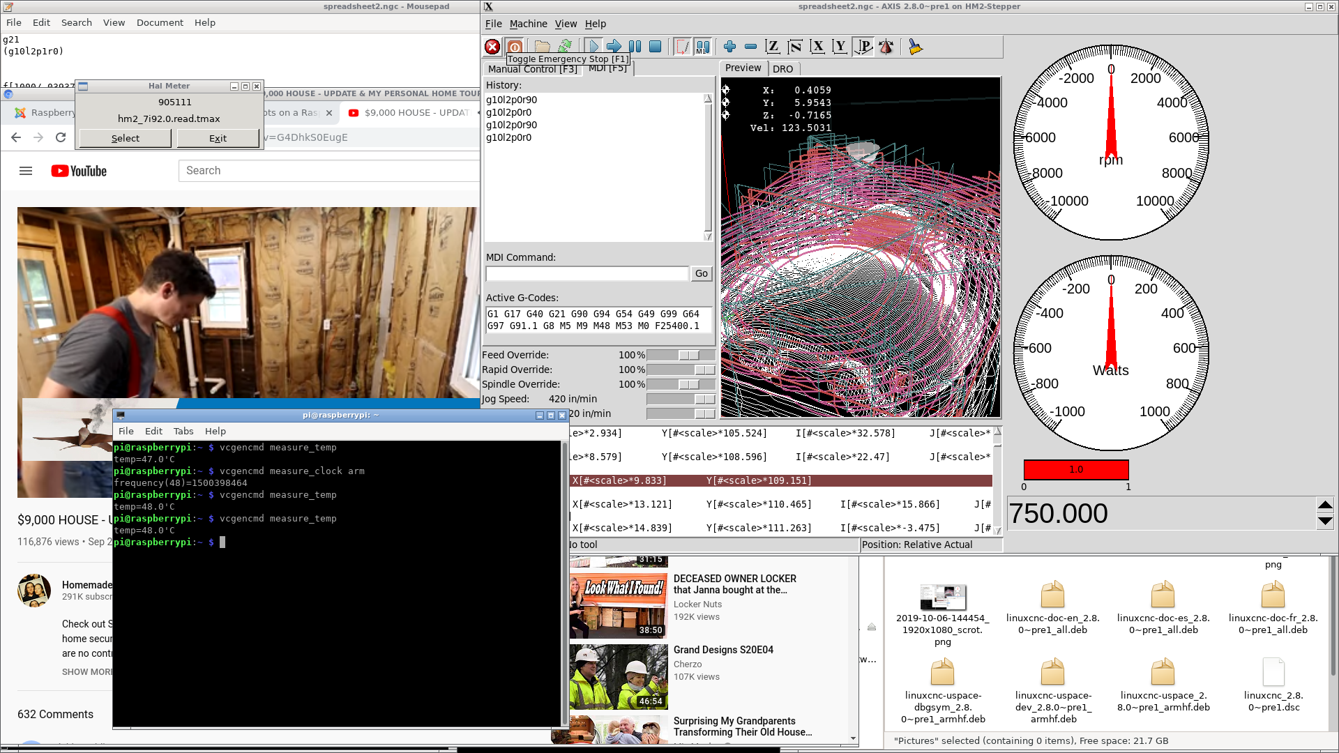

Ok - after playing I was still getting random following errors - cause by the servo thread going over 2.5ms... (I have a 2ms servo thread currently)
Looking at the 'vcgencmd measure_clock arm' the cpu seemed to be only running at 600mhz, On a normal 'pc' the realtime runs the cpu to max frequency. So looking around I added
force_turbo=1 to the config.txt
Now
pi@raspberrypi:~ $ vcgencmd measure_clock arm
frequency(48)=1500398464
pi@raspberrypi:~ $ vcgencmd measure_temp
temp=44.0'C
I am pretty sure you need active cooling for this to work - it will still throttle down the cpu frequency if it hits it temp limit.
I have been running for hours and the peak mesa read time is .6ms
I also am only isolating core 3..
And - holy crap - I can run youtube videos.. (atleast so far...)

That is why there is a note in the hm2_rpspi.9 manpage:
For optimal performance on the Rpi3, you must disable the "ondemand" CPU frequency governor. You may add the following to your /etc/rc.local file:
echo -n 1200000 > /sys/devices/system/cpu/cpufreq/policy0/scaling_min_freq
echo -n performance > /sys/devices/system/cpu/cpufreq/policy0/scaling_governor
The governor needs to be performance on any RPi you use. There is no point in doing a few Watts power save on the RPi when your machine happily churns away at few kiloWatts...
At 1.5GHz it looks like you are overclocking the CPU. This may or may not work on the RPi3 in the long run. Or are you using a RPi4?

This is a rpi4.. As I am not using spi - I was not familiar with the behavior... On a 'normal pc' the realtime kernel usually locks the cpu frequency at its peak.
