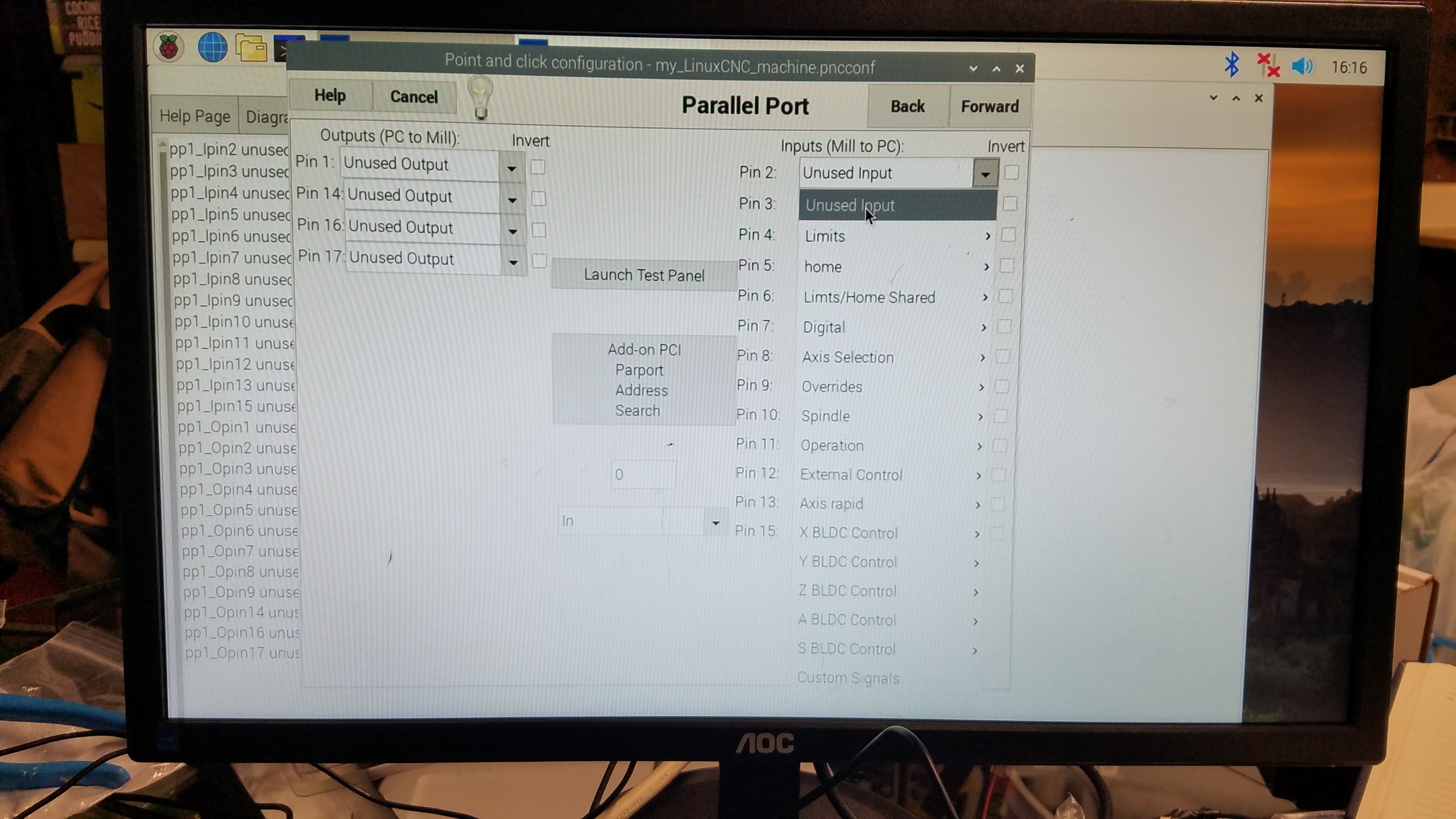

- RyanG
- Posts: 13
09 Dec 2019 00:54 #152351
by RyanG
Replied by RyanG on topic Raspberry Pi 4
Hey guys, I have been working on getting my pi 4 setup to run linuxcnc through parallel port but I am not sure how to select Step and Dir from the options provided. What should I be selecting to setup the axis? There is no option for step and dir so I am assuming it should be something else but I don't want to try all of them. I appreciate your time and assistance.
Ryan
Ryan
- skunkworks
- Posts: 351
- Thank you received: 153
09 Dec 2019 01:36 #152352
by skunkworks
Replied by skunkworks on topic Raspberry Pi 4
You are going to have to setup the hal file manually... there is an example using gpio... Hmmm
github.com/LinuxCNC/linuxcnc/commit/e0dc...52586d505f4b9bcda60d
at the bottom. Remember the GPIo pins in hal are actual pin number on the header (not the rpi numbering)
