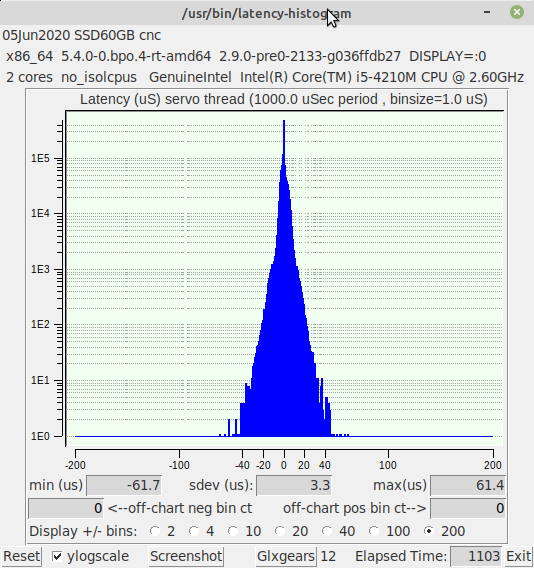

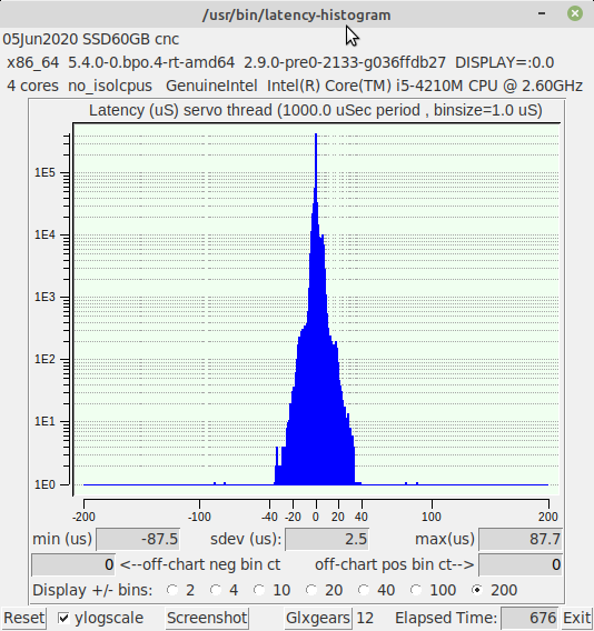

06 Jun 2020 10:44 - 06 Jun 2020 10:46 #170339 by tommylight
Replied by tommylight on topic Hardware latency tests, used PC's
-Fujitsu Lifebook E series Laptop, model no. E554 :
-8GB RAM, 60GB SSD, i5 processor,
--default BIOS
--BIOS settings changed to disable everything, like speed step, hyperthreading, virtualisation, serial, modem, etc
Using it to run the machine with a Mesa 7i92, had 1 warning about latency while with default BIOS settings, no warnings when BIOS modified for the second day. Even when there was a warning the machine continued to work so no loss of connection occurred.
Overall very nice to work and use with Linux Mint 19.3 and RT-Preempt kernel.

06 Jun 2020 19:43 - 06 Jun 2020 19:44 #170389 by tommylight
After a whole day of work, it looks very promising, no issues, no warnings, nothing, it just works, even while inserting USB sticks and copying files, doing light work on it, etc. Rock solid so far.
The bad thing is on ebay there is only one on sale at 340$ ! I found 2 locally at 250Euro each without discount, but since i have some big discount on some of these, i might get them cheaper. Online here they cost 375 Euro a piece.
More on this later, i will have this till Monday to play with.
Removing and inserting the power adapter also does not cause any warnings or issues.
Last edit: 06 Jun 2020 19:44 by tommylight. Reason: More info
