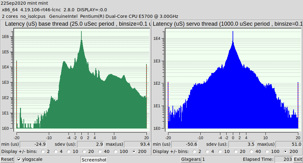

This is a Dell Optiplex 780 with 2GB RAM and 500GB HDD. Onboard video.
Here it is. I was running gears, youtube video streaming. This is running your linux from a usb stick. I can easily wipe out my current install of mint and replace with this, but I honestly don't know if these results are good or bad.
I fear this machine won't be adequate to deal with the very large g-code files I want to throw at it, 1.4million lines and up. I tried to open one of these large files, 35MB, in linuxcnc on this machine and it choked hard. To add to the burden on whatever PC I go with, I also want to be able to run g-code ripper autoleveling on these large files.
At this point, I'm happy to buy a snappier PC if I can first figure out whether or not Linuxcnc and gcode ripper autolevel will get me where I need to go. Any advice is very welcome.
