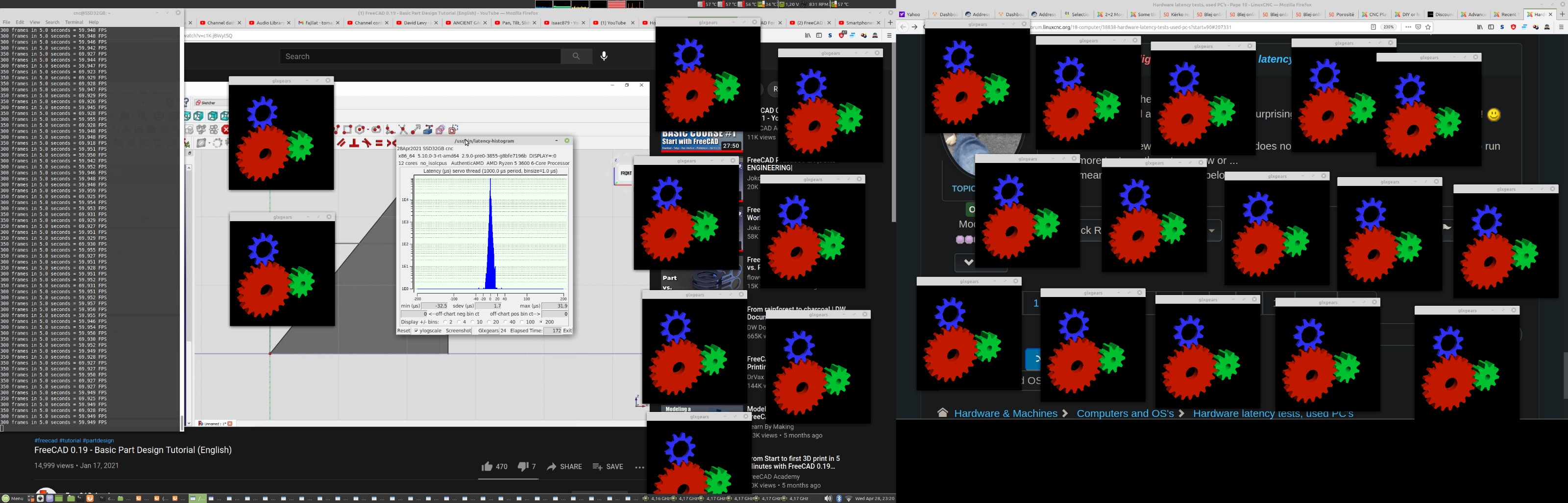

This is not a used PC, it is new, but might be useful for someone thinking of getting something similar,
New PC:
-MB Gigabyte Aorus Elite X570
-AMD Ryzen 5 3500X
-16GB (4X4GB)
-256GB NVME
-AMD RX480
-Noctua NH-D15
-Mesa 6i25
-Mint 20
-4.9.0-13-rt
And the result while doing things on the PC, doing a lot of things as can be seen on the bottom left side of the screen:
Had to scale down the image, to large to upload.

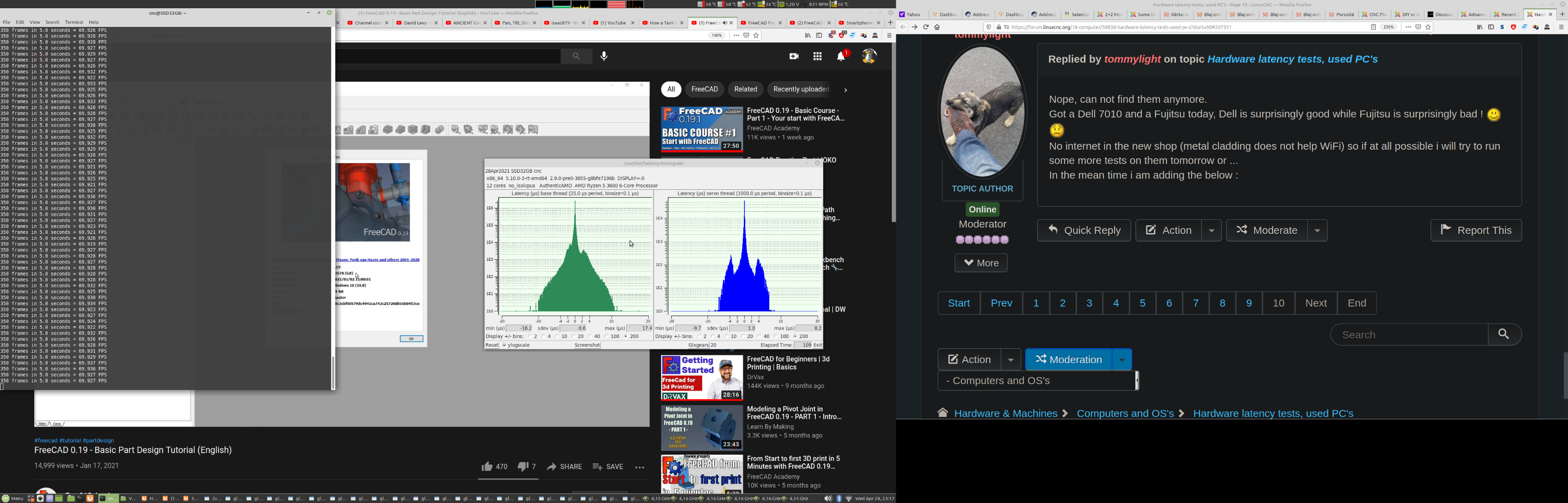

Nope, can not find them anymore.
Got a Dell 7010 and a Fujitsu today, Dell is surprisingly good while Fujitsu is surprisingly bad !
No internet in the new shop (metal cladding does not help WiFi) so if at all possible i will try to run some more tests on them tomorrow or ...
In the mean time i am adding the below :

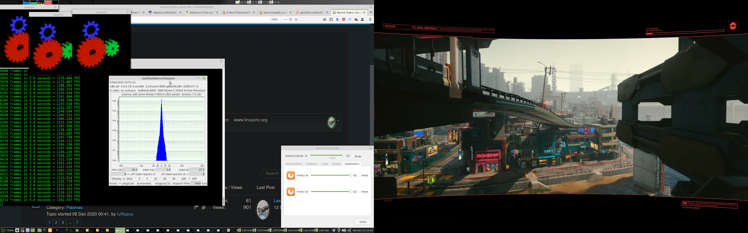

New PC:
-MB Asus ROG Strix B550-i Gaming
-AMD Ryzen 5 3600
-32GB HyperX 3600 CL16 (2X16GB)
-32GB NVME (yes 32, main drive)
-1TB Intel NVME ( not mounted, backup only )
-Saphire Radeon RX580 /8GB
-Cooler Master MasterCool 240 Lite water cooling
-Corsair CX550F RGB power supply
-Cooler Master NR200P case
-4.9.0-13-rt on Linux Mint 19.3, LinuxCNC 2.9/Master
--NOT a recommendation, the above costs over 1000 Euro without the graphic card !!!

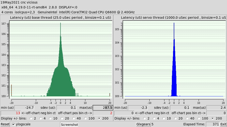

I've been testing an old computer with Asus P5B-MX motherboard, 2x2GB RAM, Intel Core2 Q6600, 128 GB SSD and Nvidia GT210.
This is my result running 5 glxgears, 4k youtube video (auto quality) and stress -c 2 -i 1 -m 1 -d 1:
As you can see most of the time the latency is really solid but once in a while it spikes to really high values.
Not sure if this is something to be concerned about? As you can see it spiked 2 times in 5 minutes. Then there were 2 more spikes during the next 10 minutes.
Is there any way to trace what might cause the spike?

For parallel port use it might cause issues, but either way you look at it RTAI kernel is much better for that.
For Mesa boards that is all fine as there is no need for a base period at all.

On Debian Wheezy with RTAI this computer performed slightly better with the Nvidia GT210 card but it seems it's much more solid with the built-in Intel GMA 3000 on Buster with preempt_rt. With the GT210 on Buster I get the latency posted earlier in thread.
Hardware is:
Asus P5B-MX, Intel Core2 Quad Q6600, 4 GB RAM (2x2 GB in dual channel), some 128 GB SSD i had laying around. Everything not needed disabled in BIOS.
Module pcspkr is not loaded, the script encounters an error when trying to detect if it's loaded.
Slight overclock for the CPU, running 290 MHz * 9 (266*9 stock). RAM running at 667 MHz.
Hardware is:

Command for latency test is:
su vicious -c "latency-histogram --bbinsize 1000 --base 100000 --sbinsize 1000 --nox 2>&1 | tee -a 1621436824.lat &"
Latency testing loop started ons 19 maj 2021 17:07:27 CEST,
should end after ons 19 maj 2021 19:07:27 CEST
Swap useage: prerun: 0, running: 0
CPU core temperatures:
Core 0: Tmin: 67.0°C, Tmax: 71.0°C, (high = +82.0°C, crit = +100.0°C)
Core 1: Tmin: 66.0°C, Tmax: 69.0°C, (high = +82.0°C, crit = +100.0°C)
Core 2: Tmin: 62.0°C, Tmax: 66.0°C, (high = +82.0°C, crit = +100.0°C)
Core 3: Tmin: 62.0°C, Tmax: 65.0°C, (high = +82.0°C, crit = +100.0°C)
last latency data is as follows:.
7199 secs servo min: -4.200 uS max: 4.300 uS sdev: 0.300 uS
7201 secs base min: -9.900 uS max: 9.800 uS sdev: 0.300 uS

Replied by tommylight on topic Hardware latency tests, used PC's
That looks very good even for software stepping.
After reading several post on this forum about using old DELL Optiplex 980, i got hold of 2 of them, in Midi Tower or whatever they call the big box these days, they do come with parallel port on the board so i was pleasantly surprised by the very good latency with Preempt-RT kernel, so here are the settings to change in BIOS:
-disable
--hyperthreading
--C states
--Virtualisation
--Serial port
--Set parallel port to EPP
Left everything else at default, so turbo and speed step are still enabled.
Had LinuxCNC with a base period set at 50000 running for half a day on it while copying and browsing internet and watching youtube, messing with resizing, playing 4K video <<< this is a lie as it can not cope with it just does a frame every 2 to 5 seconds, and there are no latency warnings. 13 glxgears running.
Very good for machine control, so far.
