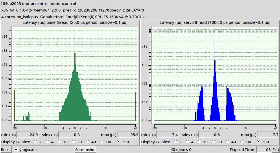

19 Sep 2023 01:57 #281128
by Hendrixx
Replied by Hendrixx on topic Hardware latency tests, used PC's

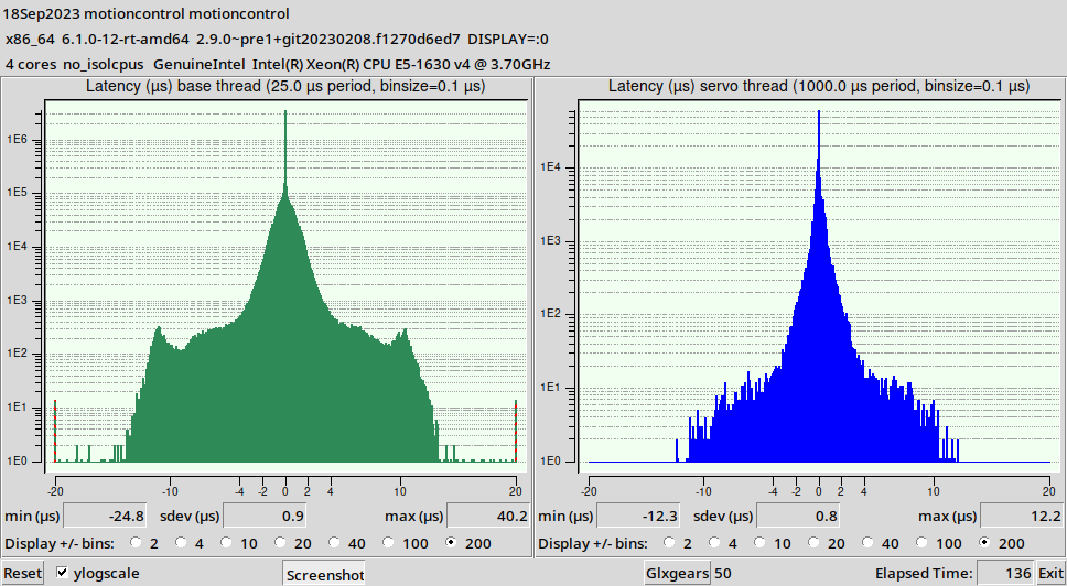

I picked up a budget mini pc at the beginning of this build. I think I paid $129 or close to it and it worked fine for getting the machine set up and in working order but as soon as I started trying to do any real work with multiple tool changes and set ups watchdog.has_bit triggered within 2 minutes and servo-thread warning as soon as the file started to load in. Isolcpus helped a little and I could do small files but not a viable option. I need this machine to be reliable and consistent so I chose to go with an older workstation and I got a HP Z440 for $185 and am very happy with it.
this is with no stress on the computer
This is with 50 glgears going
this servo thread

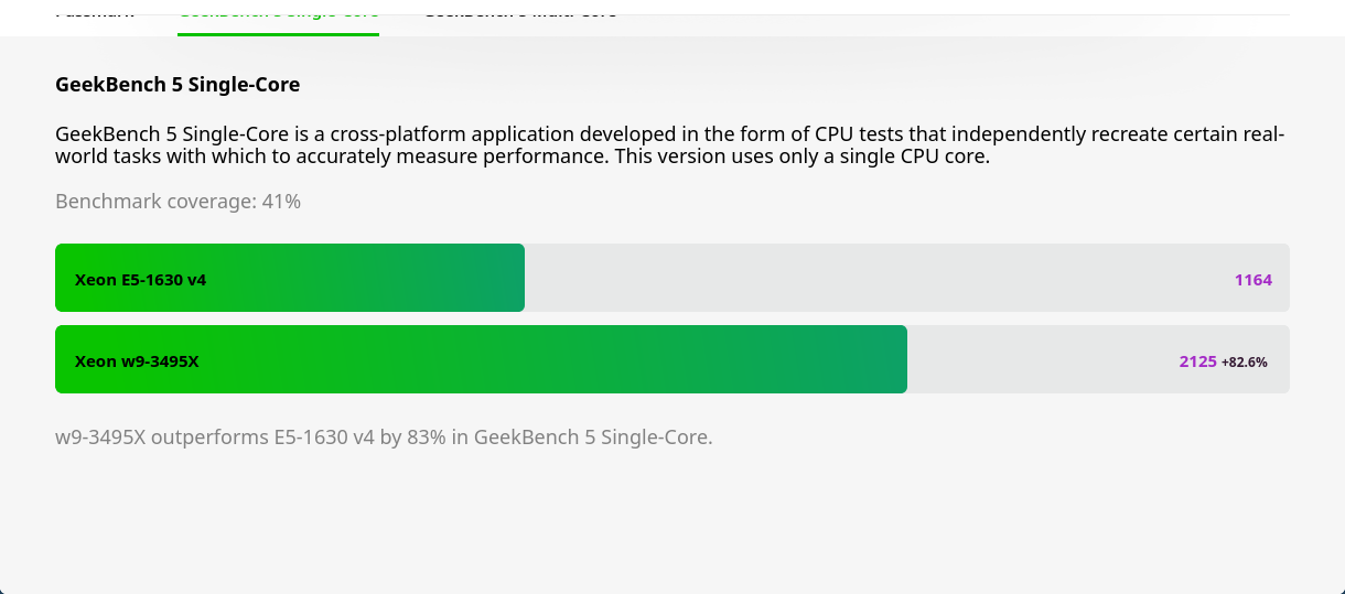

and this is how it compares to intels latest and greatest

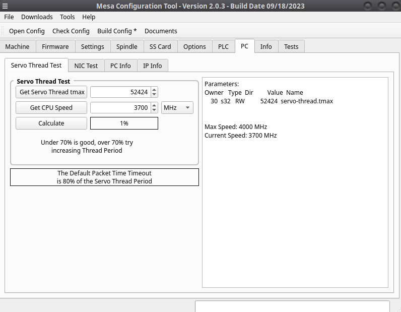

This is only useful if you are running a Mesa card or similar ethernet card. Then you can use affinity of the NIC IRQ to be the same as the isolated core.I usually set an lcnc pc up with isolcpus. Unfortunately I couldn't find any interesting interrupts to change affinity for, that seems like it could lead to a big improvement in latency.

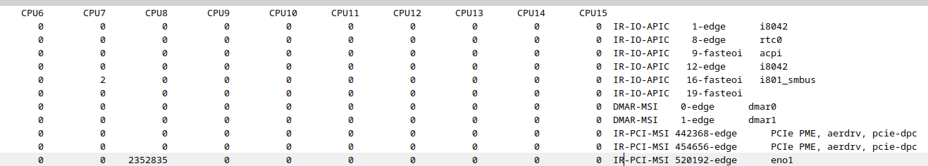

26 Sep 2023 21:25 #281666
by EricKeller
Replied by EricKeller on topic Hardware latency tests, used PC's
That's what I tried to do, but no joy. I figure you could move userland irqs off of the isolated cpus as well, but I didn't see any good candidates.
Apic is stuck to cpu 0, and that's where my nics both are.

26 Sep 2023 22:37 #281673
Replied by rodw on topic Hardware latency tests, used PC's
This page may be useful
Find your nic name with ip a (mine ie eno1)
type cat/proc/interrupts and look for the CPU that the NIC is on. In my case here CPU 8
Now open linuxcnc and not the core its running on. To do this, open linuxcnc and repeat the test you should see a new thread callrd rtappoapp or similar, Note the CPU the same way, (it should be on an isolated core)
Then use afinity commands to move the NIC to that CPU
