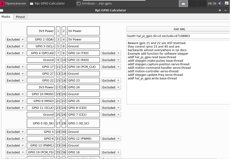

forum.linuxcnc.org/27-driver-boards/43907-rpi-4-gpio-calculator
This will be handy for Opi's. Just need to get it working with Opi IO's.

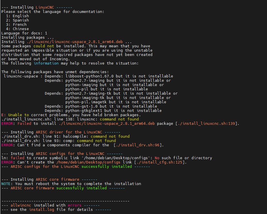

Hello, I have such a problem during installation. I don't know how to solve it. I hope you can give me some advice
Thank you very much.

What system do you install on?
Armbian_20.02.1_Orangepione_buster_current_5.4.20_desktop this one is ok

I'm curious now whether the project has been abandoned or completed.

It is sort of on hold until more Opi boards become available. The original developer archived the project since he could not get new Opi boards in his country due to the worldwide shortages of parts.
I think the project is great. it just needs a good u-boot and preempt_rt kernel for each version of the the Opi's that are available and have the Allwinner ARM SOC's with integrated microcontrollers. If Allwinner stops making them then I'd like to port this project to Rockchip or similar. I'm planing on a Gentoo fork of this project using 64b kernels.
