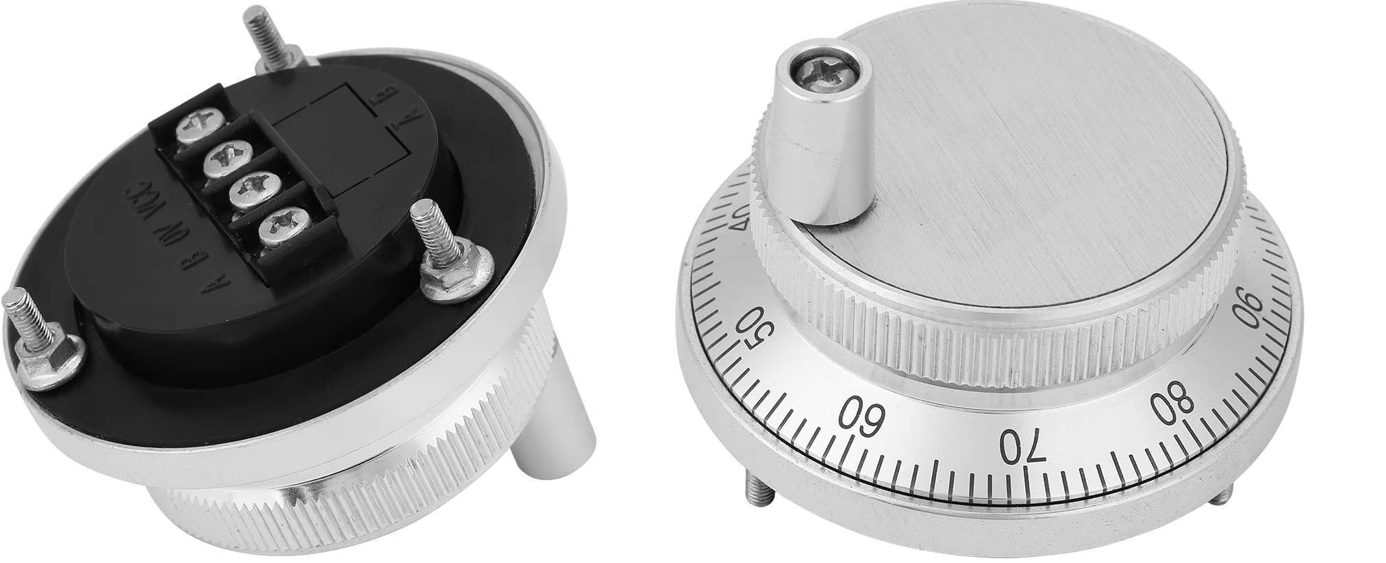

I need help again. I am apparently not understanding how to implement an encoder/MPG wheel. This isn't for my milling machine project but rather for the future lathe project. What I am trying to do to start with is just wire and use an encoder to step 0.001 machine units per click. The encoder I am using is like the one pictured below.
I have the VCC wired to 3.3v from the Orange Pi, 0V to ground, A to GPIO pin PG6, and B to GPIO pin PG7. Not sure if I should put VCC to 5v.

- Cncninja

I use the MPG with 2 PC817 Optocoupler, convert 5V logic level to 3.3v.
Below is my MPG setting in .hal file:
# MPG setup
loadrt arisc pwm="p,p,p,v" out="PA12,PA11,PA1,PA10,PA9,PA13,PA14,PA0,PA3,PC4" in="PC0,PC1,PC2,PC3,PG6,PG7,PG8,PG9" encoders=1
loadrt conv_float_s32 count=1
setp arisc.encoder.0.enable 1
setp arisc.encoder.0.x4-mode 0
setp arisc.encoder.0.pos-scale 4
setp arisc.encoder.0.A-port 6 # 6=PG
setp arisc.encoder.0.A-pin 6 # PG6
setp arisc.encoder.0.B-port 6 # 6=PG
setp arisc.encoder.0.B-pin 7 # PG7
setp arisc.gpio.PG6-pull -1
setp arisc.gpio.PG6-multi-drive-level 0
setp arisc.gpio.PG7-pull -1
setp arisc.gpio.PG7-multi-drive-level 0
net conv0 conv-float-s32.0.in <= arisc.encoder.0.pos
net jog-counter <= conv-float-s32.0.out
net jog-counter => joint.0.jog-counts axis.x.jog-counts
net jog-counter => joint.1.jog-counts axis.y.jog-counts
net jog-counter => joint.2.jog-counts axis.z.jog-counts
I also setup pyvcp to select which axis I want to use with MPG.
