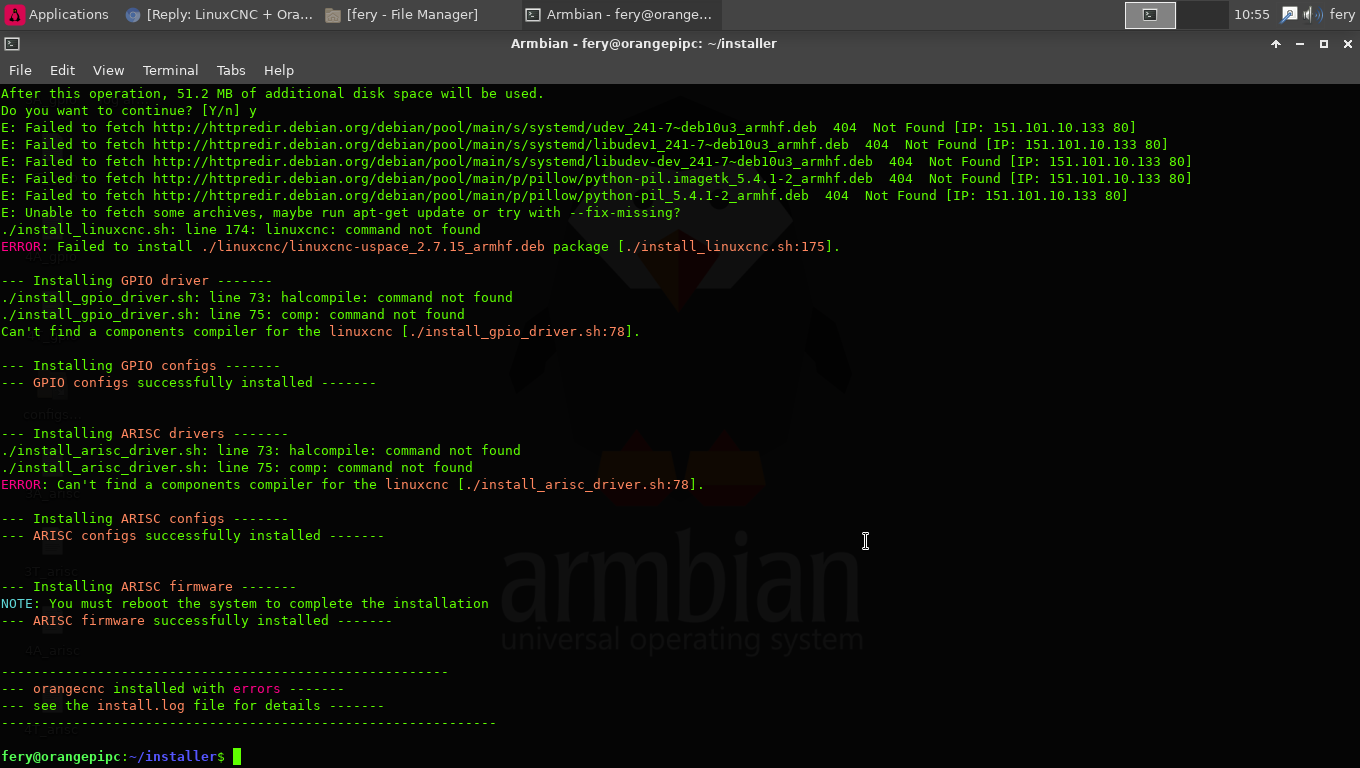

i have tried OrangePi_PC with
armbian img:
Armbian_20.02.1_Orangepipc_buster_current_5.4.20_desktop.7z
and I followed the instructions:
git clone gitlab.com/orangecnc/installer
cd installer
./install.sh
but the result failed, and the result is like this picture:
Please help me..

- twoflowers
- Visitor
24 Sep 2020 11:03 #183570
by twoflowers
Replied by twoflowers on topic LinuxCNC + Orange Pi
Network problem, try if you can reach the mentioned hosts that did respond.

can you tell me, how to fix it..

24 Sep 2020 11:20 #183573
by fery15sty
Replied by fery15sty on topic LinuxCNC + Orange Pi
fery@orangepipc:~$ git clone gitlab.com/orangecnc/installer

Do you want to continue? [Y/n] y
E: Failed to fetch httpredir.debian.org/debian/pool/main/s/...-7~deb10u3_armhf.deb 404 Not Found [IP: 151.101.10.133 80]
E: Failed to fetch httpredir.debian.org/debian/pool/main/p/...tk_5.4.1-2_armhf.deb 404 Not Found [IP: 151.101.10.133 80]
E: Failed to fetch httpredir.debian.org/debian/pool/main/p/...il_5.4.1-2_armhf.deb 404 Not Found [IP: 151.101.10.133 80]
E: Unable to fetch some archives, maybe run apt-get update or try with --fix-missing?
./install_linuxcnc.sh: line 174: linuxcnc: command not found
ERROR: Failed to install ./linuxcnc/linuxcnc-uspace_2.7.15_armhf.deb package [./install_linuxcnc.sh:175].
--- Installing GPIO driver
./install_gpio_driver.sh: line 73: halcompile: command not found
./install_gpio_driver.sh: line 75: comp: command not found
Can't find a components compiler for the linuxcnc [./install_gpio_driver.sh:78].
--- Installing GPIO configs
--- GPIO configs successfully installed
--- Installing ARISC drivers
./install_arisc_driver.sh: line 73: halcompile: command not found
./install_arisc_driver.sh: line 75: comp: command not found
ERROR: Can't find a components compiler for the linuxcnc [./install_arisc_driver.sh:78].
--- Installing ARISC configs
--- ARISC configs successfully installed
--- Installing ARISC firmware
NOTE: You must reboot the system to complete the installation
--- ARISC firmware successfully installed
--- orangecnc installed with errors
--- see the install.log file for details
fery@orangepipc:~/installer$

--- System tweaks successfully installed
--- Installing System language
Please select the system language:
1: English
2: Russian
Language: 1
Setting up the 'en_US.UTF-8' as system language...
Generating locales (this might take a while)...
en_US.UTF-8... done
Generation complete.
NOTE: You must relogin or reboot the system to complete the installation
--- System language successfully installed
--- Installing PREEMPT RT kernel
Installing packages ...
Installing ./armbian/preempt_rt_kernel/linux-image-current-sunxi_20.02.3_armhf.deb ...
The following packages will be upgraded:
1 upgraded, 0 newly installed, 0 to remove and 50 not upgraded.
Need to get 0 B/26.5 MB of archives.
After this operation, 151 kB of additional disk space will be used.
(Reading database ... 102528 files and directories currently installed.)
Preparing to unpack .../linux-image-current-sunxi_20.02.3_armhf.deb ...
update-initramfs: Deleting /boot/initrd.img-5.4.20-sunxi
Removing obsolete file uInitrd-5.4.20-sunxi
Unpacking linux-image-current-sunxi (20.02.3) over (20.02.1) ...
Setting up linux-image-current-sunxi (20.02.3) ...
update-initramfs: Generating /boot/initrd.img-5.4.18-rt11-sunxi
update-initramfs: Converting to u-boot format
Installing ./armbian/preempt_rt_kernel/linux-headers-current-sunxi_20.02.3_armhf.deb ...
The following NEW packages will be installed:
0 upgraded, 1 newly installed, 0 to remove and 50 not upgraded.
Need to get 0 B/11.1 MB of archives.
After this operation, 75.6 MB of additional disk space will be used.
Selecting previously unselected package linux-headers-current-sunxi.
(Reading database ... 102520 files and directories currently installed.)
Preparing to unpack .../linux-headers-current-sunxi_20.02.3_armhf.deb ...
Unpacking linux-headers-current-sunxi (20.02.3) ...
Setting up linux-headers-current-sunxi (20.02.3) ...
Compiling headers - please wait ...
--- PREEMPT RT kernel successfully installed
--- Installing LinuxCNC
Installing ./linuxcnc/linuxcnc-uspace_2.7.15_armhf.deb ...
The following additional packages will be installed:
blt bwidget freeglut3 gir1.2-gst-plugins-base-1.0 gir1.2-gstreamer-1.0
gstreamer1.0-plugins-base libcdparanoia0 libglade2-0 libglew2.1 libglu1-mesa
libgtkglext1 libimagequant0 libmodbus5 libpango1.0-0 libpangox-1.0-0
libreadline5 libtk-img libtk8.6 libudev-dev libudev1 libvisual-0.4-0
mesa-utils python-configobj python-gi python-glade2 python-gst-1.0
python-gtkglext1 python-opengl python-pil python-pil.imagetk python-tk
python-xlib tcl tcl-tclreadline tclx8.4 tk tk8.6 tk8.6-blt2.5 udev
Suggested packages:
blt-demo glew-utils libtk-img-doc libvisual-0.4-plugins python-configobj-doc
python-gi-cairo python-gtk2-doc libgle3 python-pil-doc python-pil-dbg
python-pil.imagetk-dbg tix python-tk-dbg tclx8.4-doc
Recommended packages:
linuxcnc-doc-en | linuxcnc-doc hostmot2-firmware-all python-olefile
libreadline5 libtk-img libtk8.6 libudev-dev libvisual-0.4-0 linuxcnc-uspace
libudev1 udev
2 upgraded, 38 newly installed, 0 to remove and 48 not upgraded.
Need to get 9,943 kB/13.5 MB of archives.
After this operation, 51.2 MB of additional disk space will be used.

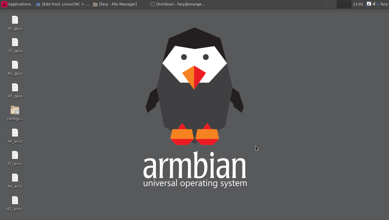

some time ago I also tried the latest version of Armbian:
Armbian_20.08_Orangepipc_buster_current_5.7.15_desktop.img.xz
And the process runs without error, but after rebooting, keyboard and mouse don't work ..
i am confused which version of armbian is suitable for machinekit / linuxcnc
