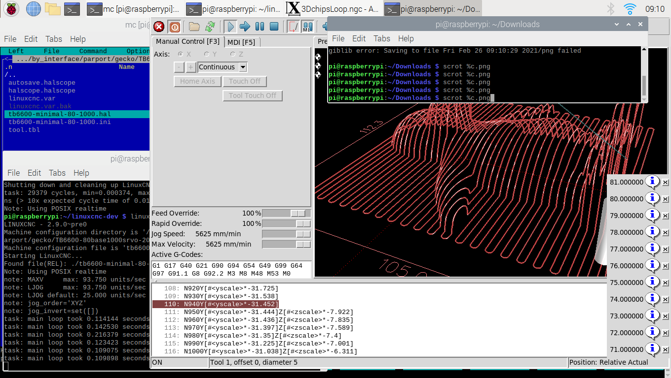

Helllo
I now have a hal_pi_gpio.c that runs well ( imo ).
It has inputs and in_nots
it has outputs and out_inverts and out_resets
it has a reset_time param for the reset pins
It's for the RPi3 ( the rpi4 latency is not as good as rpi3 imo )
Itfor fpr RPi not OPi but there's good news for OPi users....
The sweeet spot for threads is useful on OPi as well as RPi
Use 80us base and 1000us servo ( isolcpus=1,2,3 idle=poll
and dont touch it while it runs overnight! no youtube no games no music no movies no email, nanda
this is only for running lcnc ( and running lcnc only )
The reset pin feature means the hal_pi_gpio driver can be used with double step to increase velocity.
So, Ii didnt fix MxMaster's arisc gpio/stepgen
but the OPi can run pretty damn fast without it.
(12500 steps per sec with 80us base and 1000us servo threads)
For the brave, here's the source and screenshots of it running on RPi3
For the OPi, you can use the 80us 1000us threads to get same from MxMasters pi-gpio driver
no need for arisc to get that speed
I will keep looking into these gpio drivers and try to get the arisc gpio to do same as my rpi driver
(beware i am slow

02 Mar 2021 07:47 #200761
by asid61
Replied by asid61 on topic LinuxCNC + Orange Pi
I was able to get linuxcnc up and running on the Orange Pi with the GPIO driver at 10kHz using the quick start guide (and a sudo apt-get update before installing anything). Was very easy, and was pleasantly surprised by how easy it was to set up linuxcnc overall. I'm happy with that performance, but for rapids I need something a few times faster. ARISC driver is fast as heck (I got up to 300kHz before I stopped testing!), but the long term drift makes it hard to use. I took a glance at the code but it's all very over my head. Very cool project, and I hope someone can fix the faster driver, as it would be excellent for all kinds of smaller CNC control projects.
