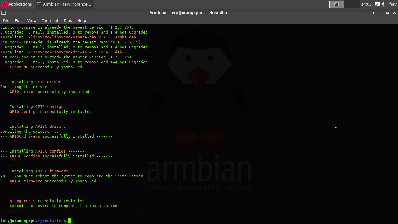

24 Sep 2020 09:27 - 24 Sep 2020 09:28 #183597
by fery15sty
Replied by fery15sty on topic LinuxCNC + Orange Pi
Thank you very much, I try again using Armbian:
Armbian_20.02.1_Orangepipc_buster_current_5.4.20_desktop.7z
After installing Armbian, I updated it
sudo apt-get update
and then
./install.sh
finished all, without any errors, done.
Thank you very much. I am very happy
sudo apt-get update
and then
./install.sh

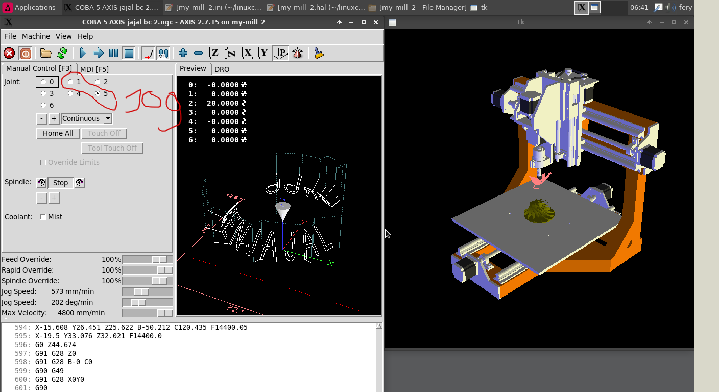

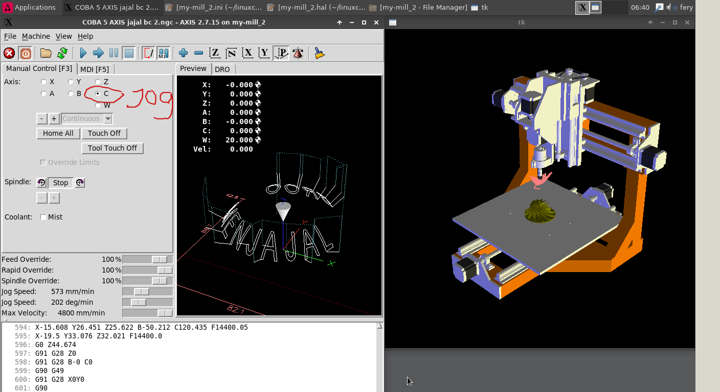

26 Sep 2020 02:27 - 26 Sep 2020 02:44 #183800
by fery15sty
I've tried multiaxis (5axis) in my armbian, and it works fine. but some menus is not working..
in joint mode, joint 1 and joint 5 cannot manually jog
and
in word mode, axis c cannot manually jog
how to fix this problem?
and
Last edit: 26 Sep 2020 02:44 by fery15sty.
