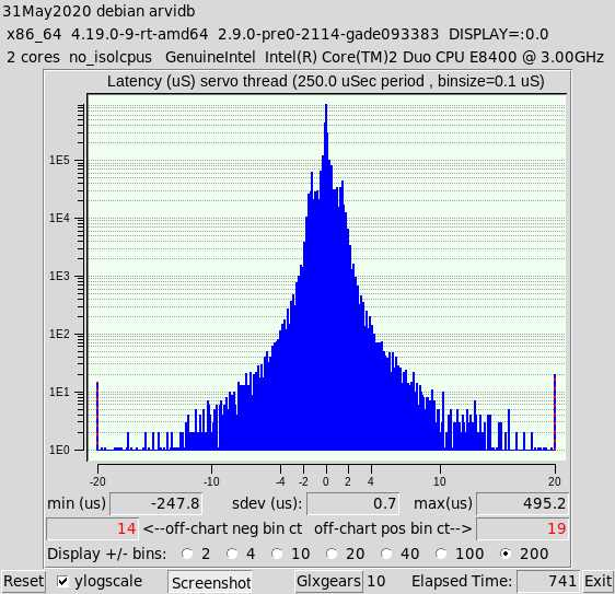

I have a newly installed system following the
Debian 10.4 Buster Linuxcnc quick and easy install
guide.
latency-histogram looks like this:
arvidb@debian:~$ latency-histogram --nobase --servo 250000 --show
I believe most of the outliers are about 2 ms, so it seems I get about 5-10 of these delays each second. If I reset the values I immediately get a max of thereabouts again.
Now I have used this computer to run linuxcnc back in 2014 or thereabouts and I know I managed to get very good latency figures then, with 250 µs base thread.
Any idea where to begin to look? I don't have any of the rt* files under /dev mentioned in the Wiki Troubleshooting section - are these needed for RT_PREEMPT as well as for RTAPI?
Is the rtapi_app supposed to run with realtime scheduling? It seems it doesn't:
Anything else I should check?

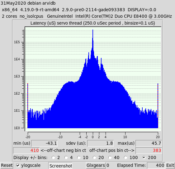

2 ms is huge, Do you have all power management disabled in the BIOS?

Some further testing shows that the culprit was the EIST function:
Enhanced Intel SpeedStep
. With that turned off, but C4, C2 and C1E enabled and a few glxgears running, latency stays below 20 µs. Using Firefox to watch YouTube however still brings some spikes up to about 500-700 µs (but *much* rarer than the continuous 2 ms spikes I got with EIST enabled):
Last edit: 31 May 2020 15:59 by arvidb.

Yes, I think Speed-step basically stalls the processor while it waits for the voltage
and clock speed to change so its a no-no for real-time

BeagleBrainz: Isolating two cores on a dual-core machine without hyperthreading doesn't really make sense to me...?
It seems the remaining outliers happen when I switch focus to the Firefox window (regardless of contents; it's not really YouTube related as I first thought). Not every time, just once in awhile. Turning off the xfce compositor helped a bit by approximately halving the latency of the outliers - but it didn't reduce the number of them. Maybe the occasional 300-350 µs delay is okay for a 1 ms servo thread (no base thread)? Or I might just have to leave Firefox alone while running an NC program...
Maybe I should try some other window environment? Anyone else running xfce successfully? This machine's got an Radeon HD 3870 graphics card, running the radeon driver.
Edit: I should add that this will be a mixed EtherCAT (Omron G5 for X, Y, and spindle) and Mesa (Z - Yaskawa SGDA, and IO) system.
