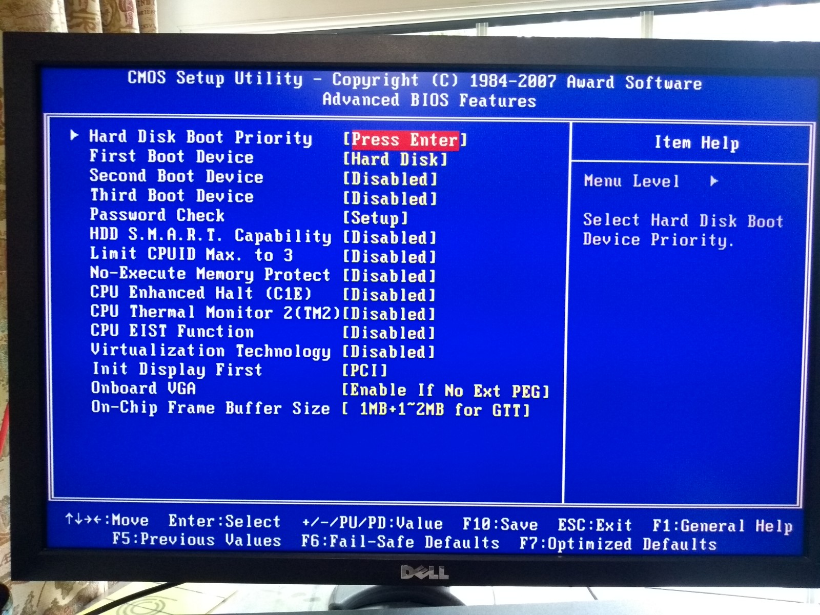

EIST/speedstep is disabled, and I see no options for hyperthreading.

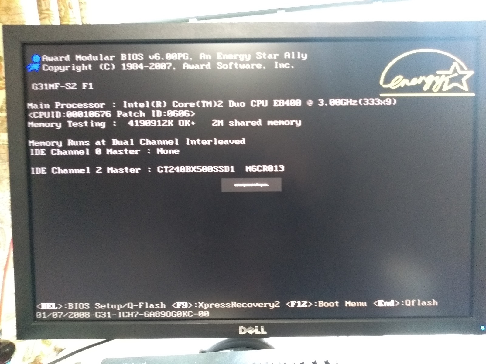

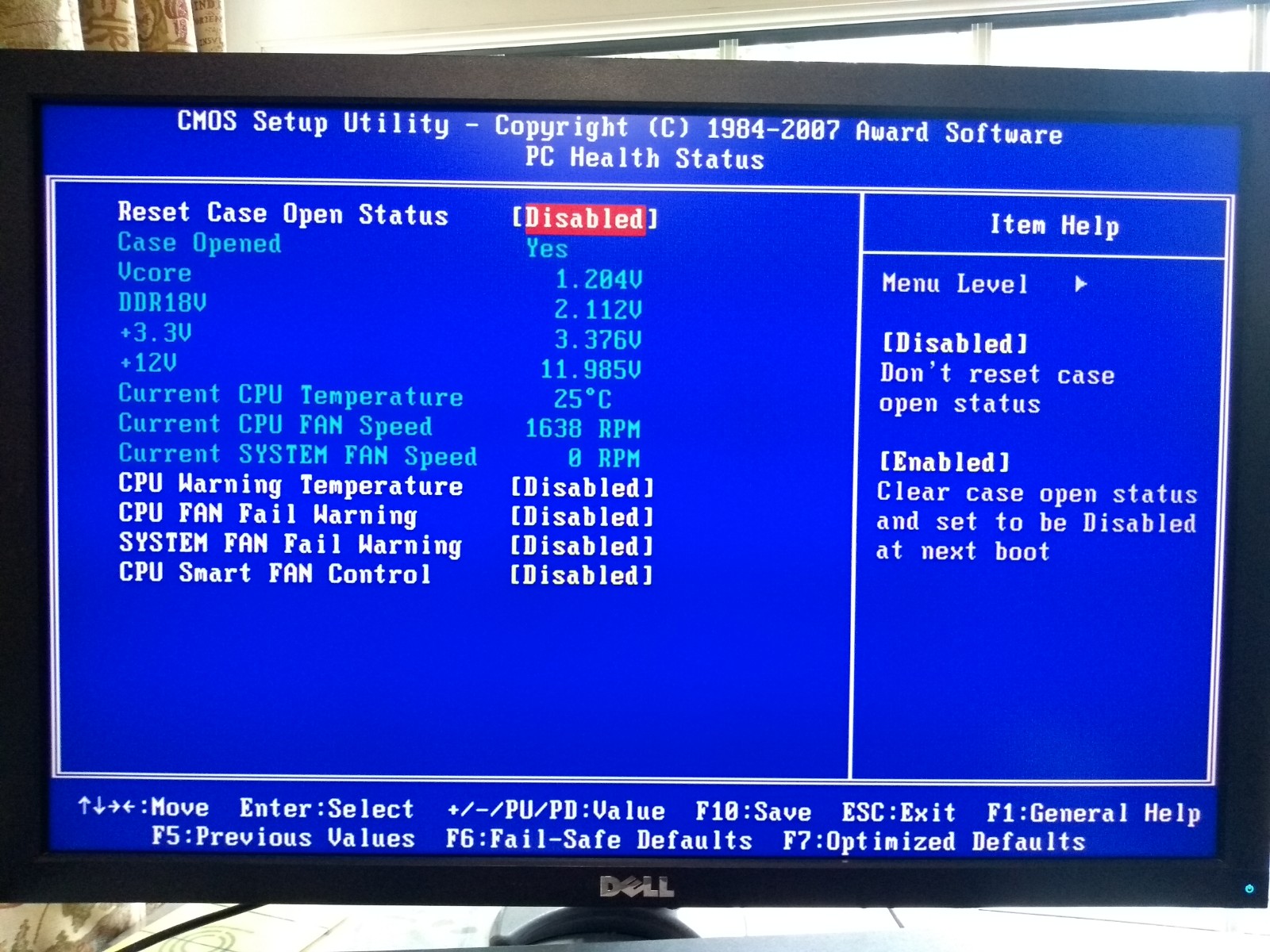

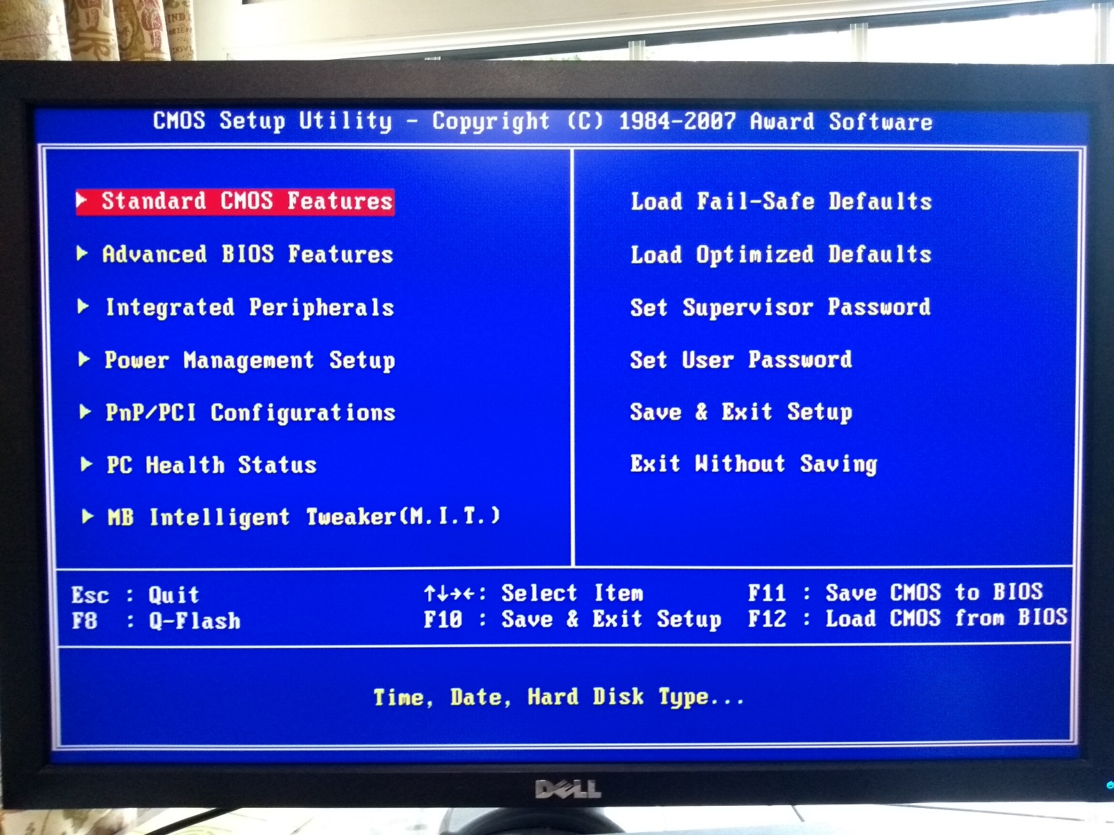

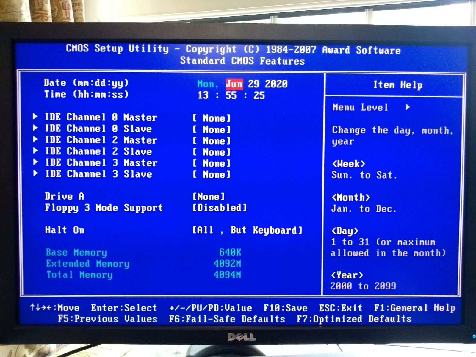

Can you take some pictures of the BIOS screens and post them here ?
- Mud
- Posts: 142
- Thank you received: 25
29 Jun 2020 09:05 #173091
by Mud
Replied by Mud on topic [SOLVED] Huge latency with PREEMPT_RT
First lot of photos.
- Mud
- Posts: 142

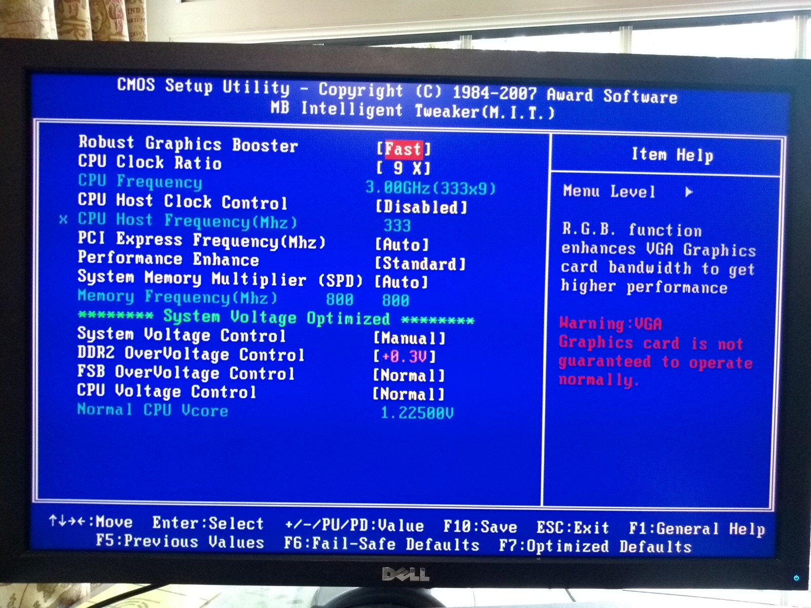

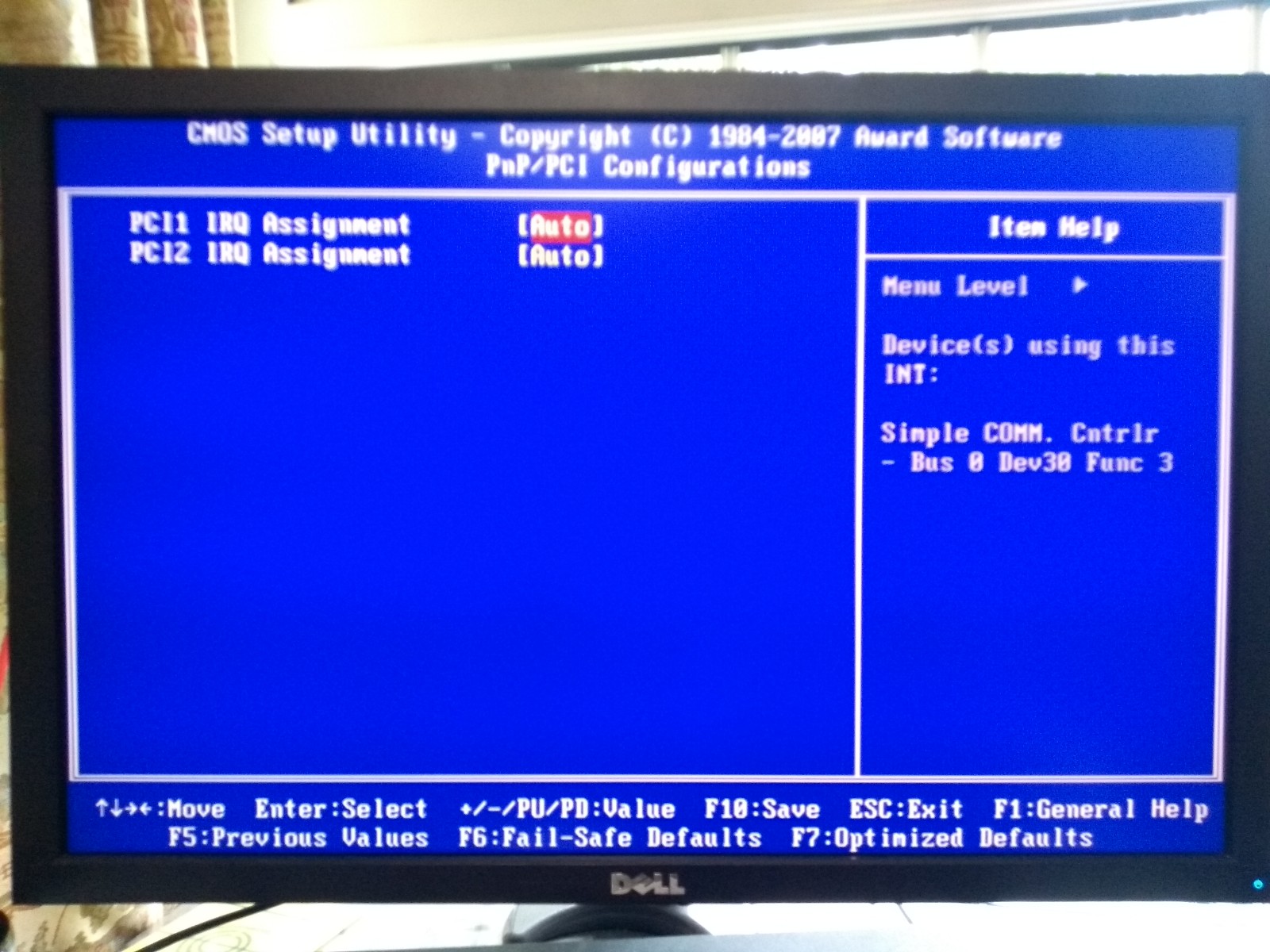

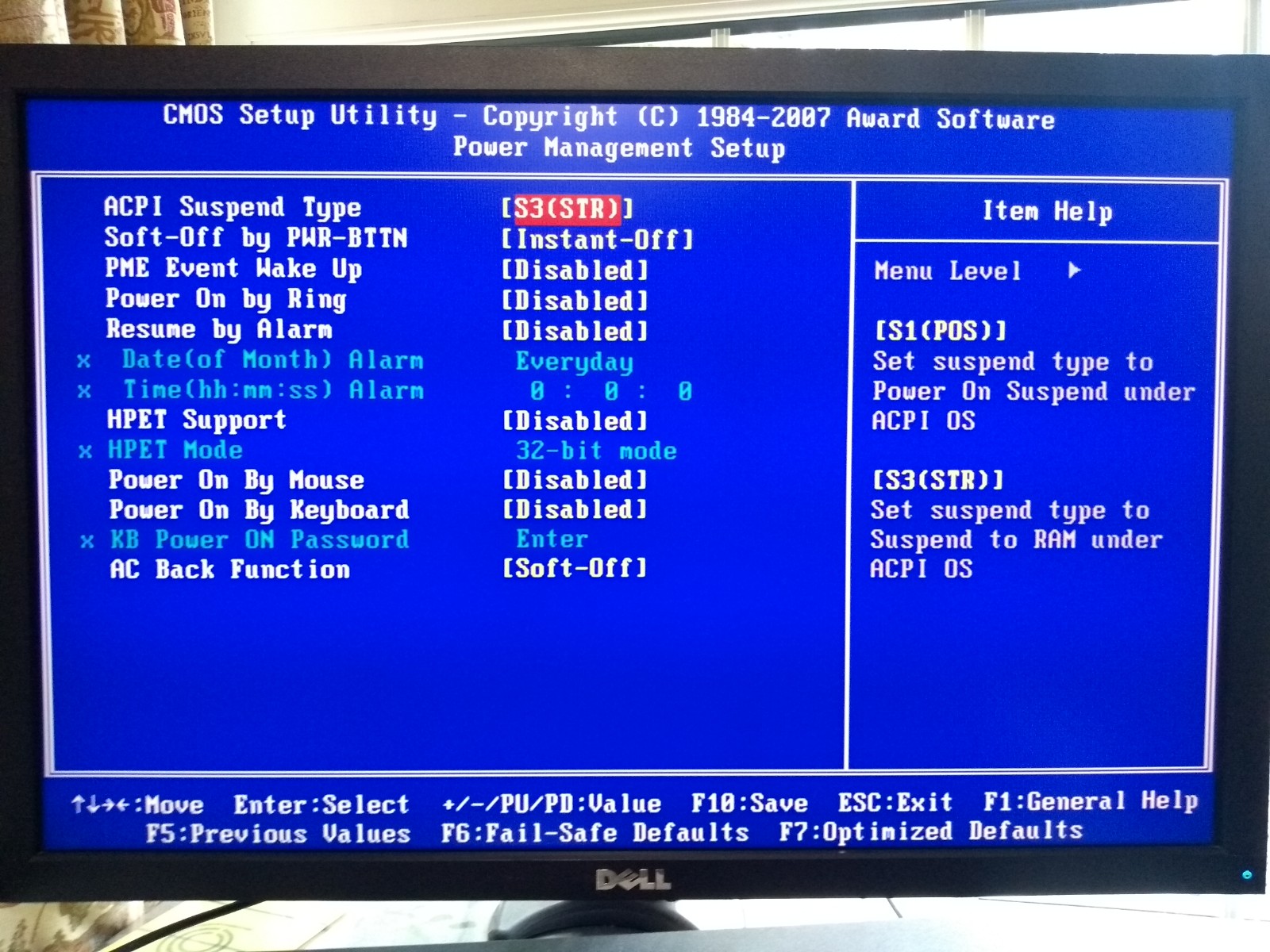

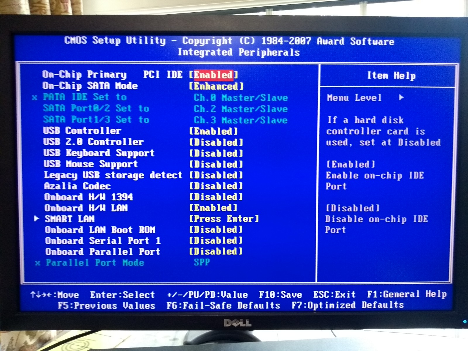

29 Jun 2020 09:06 - 29 Jun 2020 09:22 #173092
by Mud
Second lot of photos.
edit: I did previously have the PCI frequency set to 100MHz and SPD ratio set to 2.4...not sure why they reverted. I've just corrected those and still get massive latency (1000us+).
'Robust Graphics Booster' only has options: Auto (default), Fast, Turbo - I was afraid of 'Auto', hence setting Fast. Same for SATA mode 'Enhanced' - that should be vanilla SATA I believe.
Here is the manual.
Here is the manual.
Last edit: 29 Jun 2020 09:22 by Mud.
- Online
- Posts: 22049
- Thank you received: 7509
29 Jun 2020 09:18 #173097
Replied by tommylight on topic [SOLVED] Huge latency with PREEMPT_RT
That all looks OK. Check if there is a setting for "Gate A20", that has to be set at "fast".
