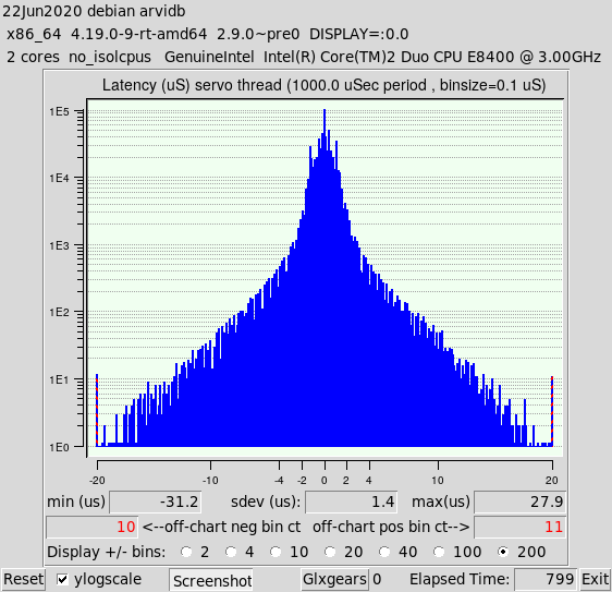

22 Jun 2020 04:03 #172307
by arvidb
I don't know if it was the radeon driver or the fact that the card was failing that caused the spikes.
Replied by arvidb on topic Huge latency with PREEMPT_RT
The graphics card I used, an old radeon one, has been more and more shaky, with display corruption and now no longer even showing anything at boot. So I replaced it with a newer one using the amdgpu driver and the spikes are gone - same usage as before gives a maximum 27.9 µs deviation:Using Firefox to watch YouTube however still brings some spikes up to about 500-700 µs (but *much* rarer than the continuous 2 ms spikes I got with EIST enabled)

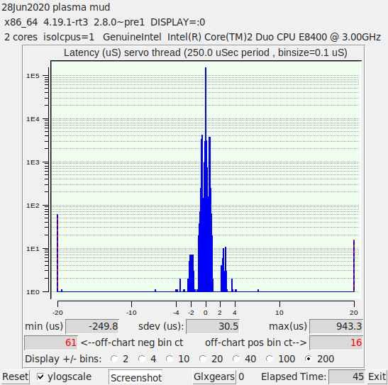

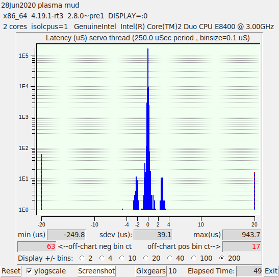

- Mud
- Posts: 142
- Thank you received: 25
28 Jun 2020 15:33 - 28 Jun 2020 15:36 #173030
by Mud
Replied by Mud on topic [SOLVED] Huge latency with PREEMPT_RT
I'm having issues similar to those described in this thread, but I'm not having any luck finding them. Key facts:
*Linux Mint 19.1 with preempt (readying for a 7i96, which I currently have communicating and moving a motor)
*I believe I have disabled everything optional in the BIOS
*isolcpus=1 has tightened the histogram, but still with the big periodic spikes of 1+ms
*using onboard graphics did not help (attached image with no glxgears running)
*I'm running the onboard NIC and a PCI NIC (Realtek RTL8111/8164/8411 onboard connected to 7i96 and RTL8196/8110 PCI card for internet)
I'm new to this level of fiddling with Linux, so don't assume anything! One thing I am confused about from the process of jumping between different guides in setting up the OS, was I correct in making the changes to the /etc/network/interfaces file ( here ) - I did this before installing the second card, and wasn't sure if I had created a bad situation there (especially since reading here makes the network connection manager seem a bit flaky. I was not sure if tommylight's instructions implied the network manager was being used for everything and the gnipsel changes should not be done. I didn't copy the text I changed in the interfaces file, so it would take me a long time to go back to check! I set 'managed=true' under [ifupdown] in NetworkManager.conf because initially the network connection wasn't present in the network manager, but my memory is getting hazy at this point (and not sure if this network stuff is a red herring anyway!).
The motherboard I'm using (Gigabyte ga-g31mf-s2) isn't full size, and I wonder if it is just not a great candidate.
Apologies for the wall of text! Thanks in advance.

29 Jun 2020 07:07 #173077
by Mud
I've run the latency script to help with my hardware spec.
LinuxCNC pc tests, version 20200624, started 29.06.2020 13:02:43
General info:
Gigabyte Technology Co., Ltd., G31MF-S2
Bios version F1, dated 01/07/2008
Chipset: Harddisk is non-rotational, ie. SSD
The amount of swap currently used is 0
CPU related data:
model name : Intel(R) Core(TM)2 Duo CPU E8400 @ 3.00GHz
cpu cores : 2
stepping : 6
cache size : 6144 KB
RAM related data:
Maximum Memory Module Size: 1024 MB
Maximum Total Memory Size: 4096 MB
Maximum Capacity: 4 GB
Installed Size: 2048 MB (Single-bank Connection)
Enabled Size: 2048 MB (Single-bank Connection)
Installed Size: Not Installed
Enabled Size: Not Installed
Size: No Module Installed
GPU related data:
product: 82G33/G31 Express Integrated Graphics Controller
configuration: driver=i915 latency=0
Os related data:
PRETTY_NAME="Linux Mint 19.1"
Desktop: , Session:
Kernel related data:
Kernel 4.19.1-rt3
GRUB_CMDLINE_LINUX_DEFAULT="isolcpus=1"
Cpu idle driver: none
Kernel modules data:
Check if pcspkr is loaded: No, good!
Yes, may cause bigger latency.
Check if snd modules are loaded: No, good!
Keyboard & Mouse related data:
Number of mice: 1
Mouse 0 : Logitech USB Laser Mouse
Mice attached to USB:
Logitech, Inc. M-U0007 [Corded Mouse M500]
Keyboards attached to USB:
Chicony Electronics Co., Ltd KU-2971/KU-0325 Keyboard
LinuxCNC related data:
LinuxCNC version is: 2.8.0~pre1
Preparing for latency test:
Started glxgears No. 1
Started glxgears No. 2
Started glxgears No. 3
Started glxgears No. 4
Started glxgears No. 5
Started firefox with 'https://vimeo.com/150574260'
Command for latency test is:
su mud -c "latency-histogram --bbinsize 1000 --base 25000 --sbinsize 1000 --nox 2>&1 | tee 1593432134.lat &"
Latency testing loop started Mon 29 Jun 13:02:59 BST 2020,
should end after Mon 29 Jun 15:02:59 BST 2020
Unexpected realtime delay on task 0 with period 25000
Swap useage: prerun: 0, running: 0
last latency data is as follows:.
12 secs base min: -24.900 uS max:1017.400 uS sdev: 0.400 uS
12 secs servo min:-955.100 uS max: 955.000 uS sdev: 0.600 uSPlease Log in or Create an account to join the conversation.

29 Jun 2020 07:31 #173079
Replied by tommylight on topic [SOLVED] Huge latency with PREEMPT_RT
Are you sure you have hyperthreading and speedstep disabled in BIOS ?
