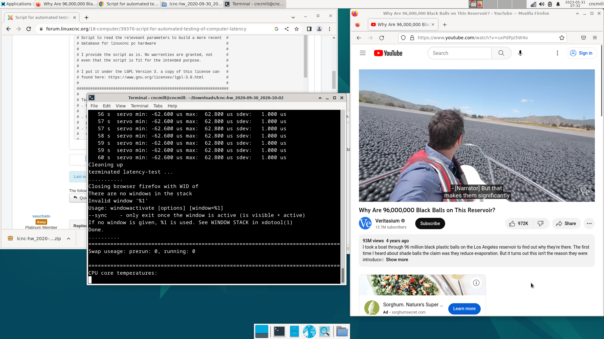

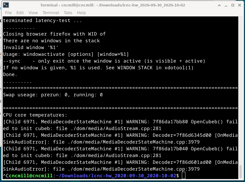

- mattdom142
- Posts: 20
31 May 2023 14:41 #272570
by mattdom142
Replied by mattdom142 on topic Script for automated testing of computer latency.
Hello, thank you for the script.
I'm having a few issues.
The script is getting stuck at the end. See the attached picture.
My machine is the HP M01-F3006 with Ryzen 5 5600 Chip, 6 core with 12 threads.
Is there something wrong with more cores and the script is getting stuck because of that or did I do something wrong?
If I Ctrl C I get a few warnings. See the picture with all the warnings.

- Posts: 18074
- Thank you received: 5314
01 Jun 2023 18:07 #272648
Replied by PCW on topic Script for automated testing of computer latency.
I don't know if its done elsewhere in your script but if you are testing ping times,
you need to do it with RT priority and a close to servo thread rate, like:
sudo chrt 99 ping -i .001 -q 10.10.10.10
Also the first ping should be dropped as it includes ARP lookup.
The following user(s) said Thank You: seuchato
