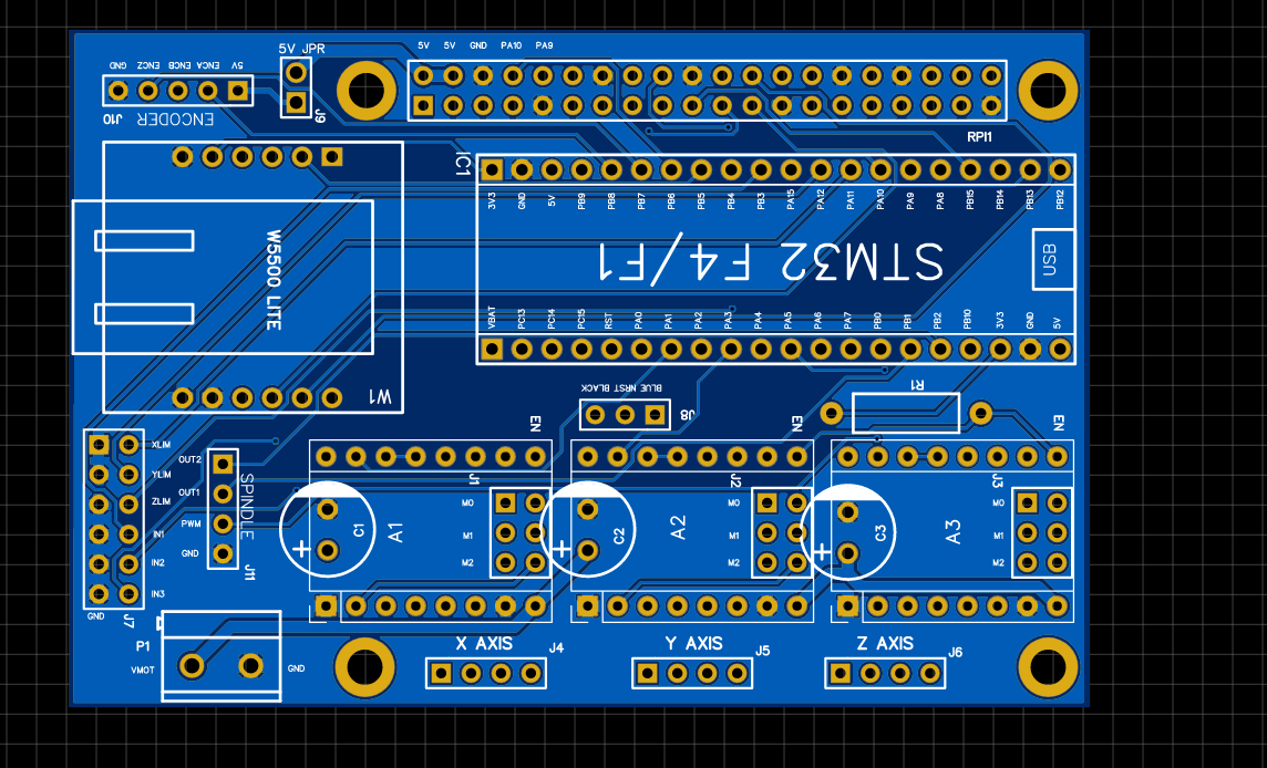

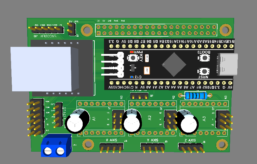

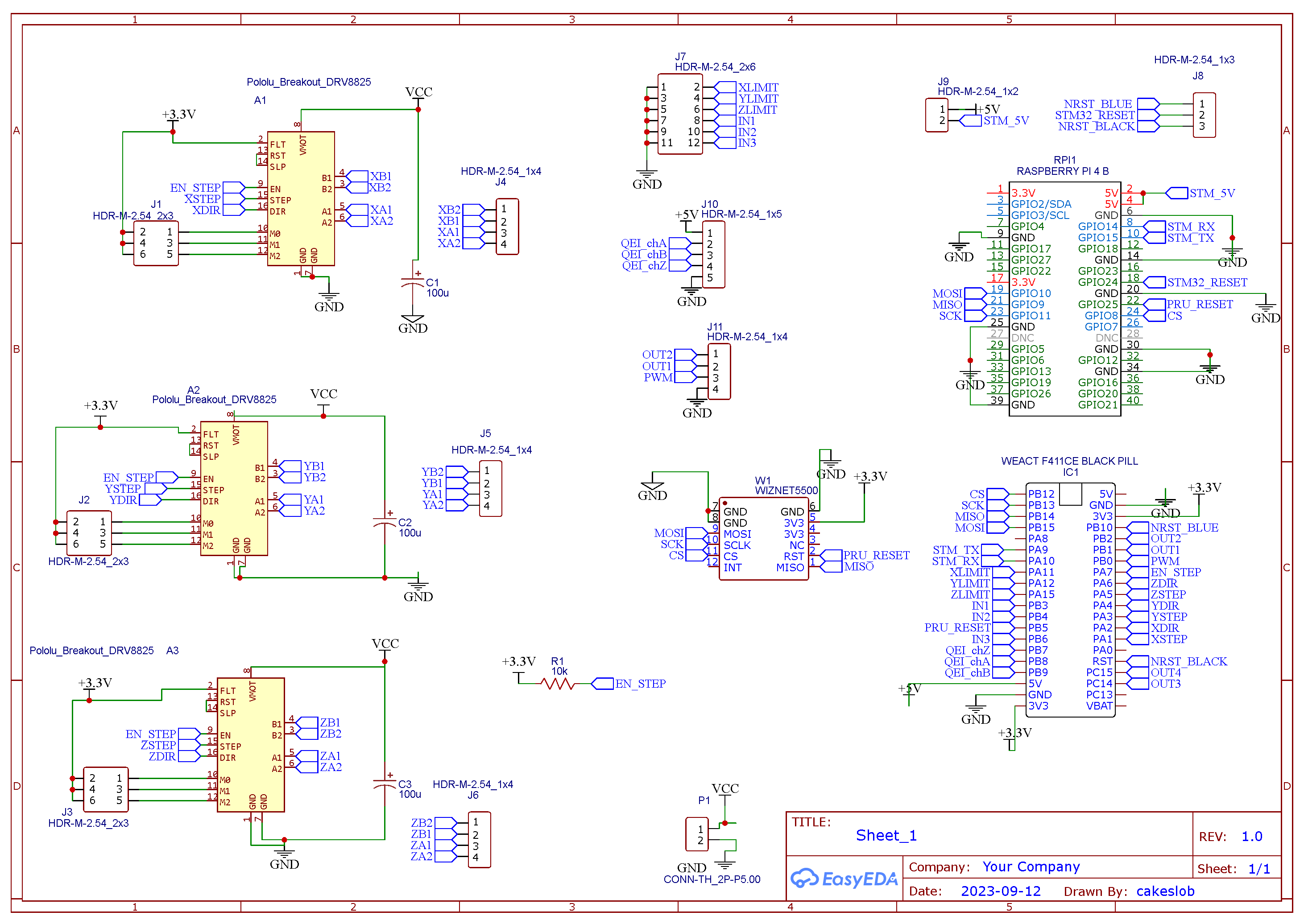

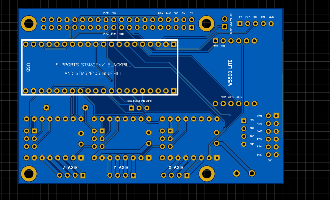

i hope this thing works
my super cheap shit board with the following buzzwords
linuxcnc remora raspberrypi stm32 blackpill w5500 ethernet ........ shield
looks promissing, will wait for the real, i will build those to change my old chinese bob, can we add axis to multiple z axis?i have plant to add my machine with diode laser and plasma cut

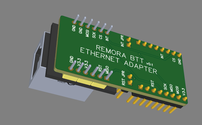

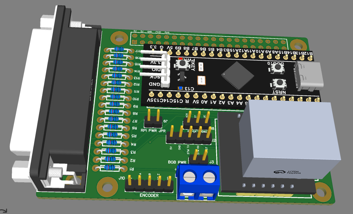

for that board specifically I ran out of room for a 4th, but it is more for small desk stuff. made to be cheap , easy and accessible. But yeah I would wait until they arrive and I can test them. Im not an electrical engineer and Im not too good with computers, so I expect several revisions.
I do have 2 other boards should arrive here by next week, you might be more interested in the other one. It is a DB25 RPi/Ethernet board, similar to the other one.
I also made an ethernet adapter for BTT/3d printer boards. They almost have a standard wifi socket that can be used for ethernet

the one with db25 port looks good, just need plug and play..greath wait for real testfor that board specifically I ran out of room for a 4th, but it is more for small desk stuff. made to be cheap , easy and accessible. But yeah I would wait until they arrive and I can test them. Im not an electrical engineer and Im not too good with computers, so I expect several revisions.
