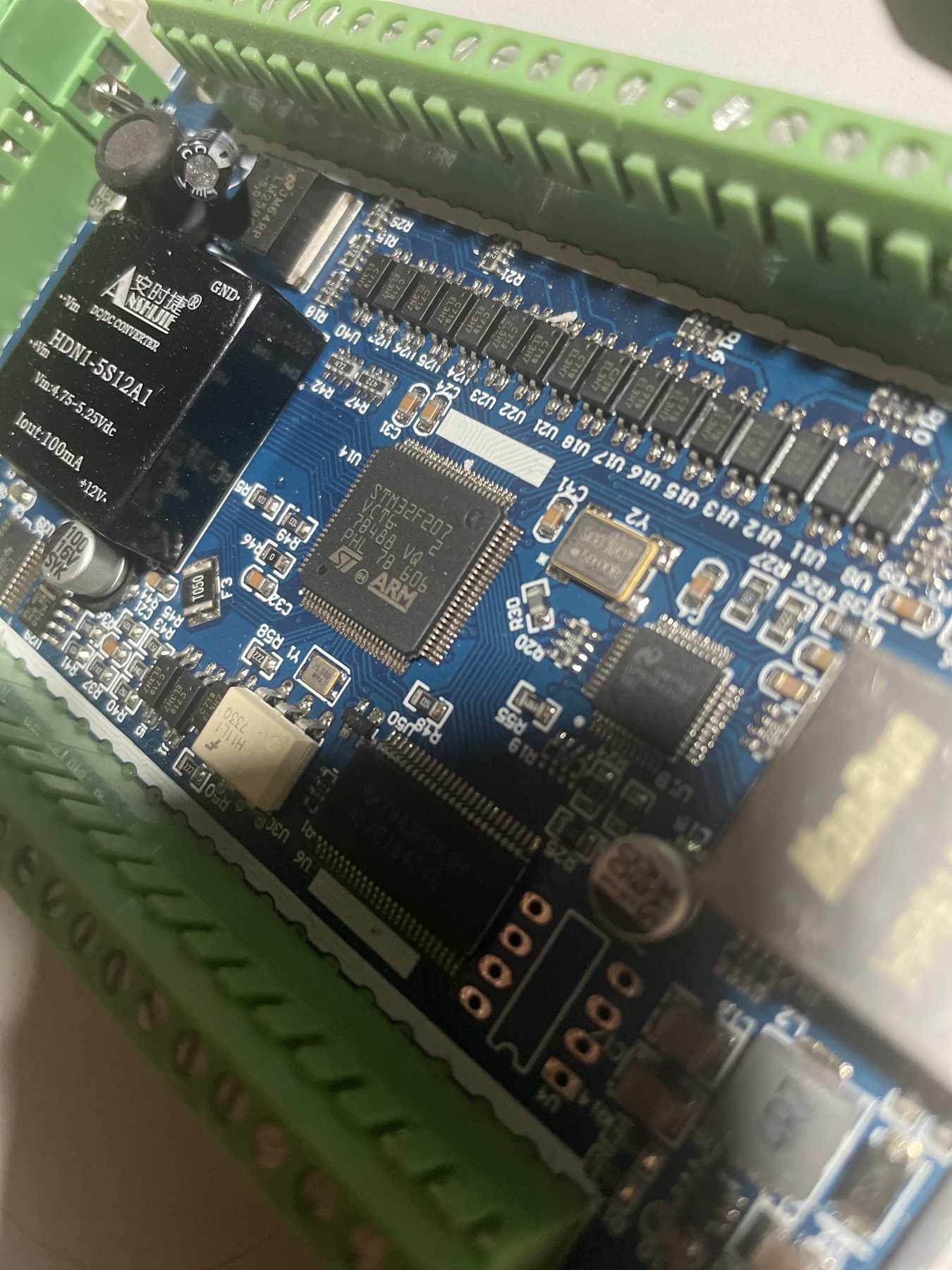

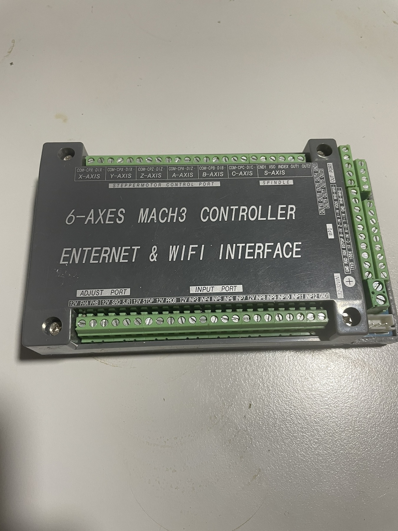

I have two nvem cards, I can't read all 80 pages of the post related to the implementation on linuxcnc, can you explain step by step the procedures of a short way to implement them on linuxcnc, in the shortest possible terms for those of us who have very little knowledge about programming. thank you
- scotta
- Posts: 959
- Thank you received: 489
01 Nov 2024 21:34 #313630
by scotta
Replied by scotta on topic Remora - Rpi Software Stepping Using External Microcontroller via SPI
Best to start with
www.forum.linuxcnc.org/18-computer/44828...c300-ec500-cnc-board
The board you have is an STM based board, which was the first Ethernet board to be supported. So the early part of the above thread covers the development and firmware installation stuff.
