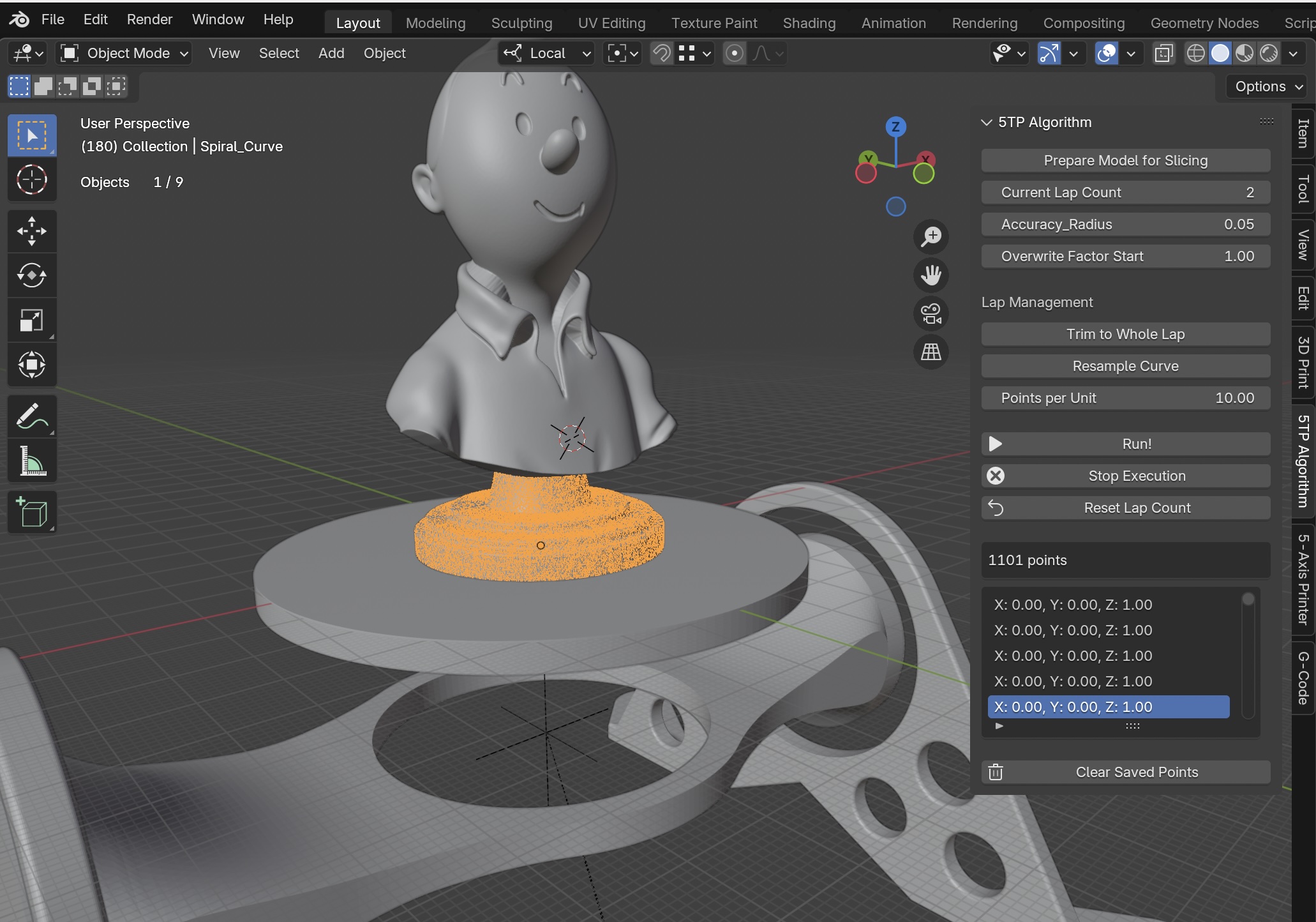

25 Feb 2025 00:55 - 25 Feb 2025 02:39 #322560 by jairobbo
Hi all,First of all I wanted to express my grattitute for the assistance on getting the octopus board to run Remora LinuxCNC.Since I actually want to print cool stuff on the 5 axis modified Ender3 3d printer, I am writing 2 addons for Blender. The first is an indexed slicer that let's the user chop off overhanging parts of the model, so they're printed in a more gravity friendly orientation. The second is a "magic spiral toolpath generator". I love to print miniatures and have this TINtIN buste taht is perfect to test out this strategy. The idea is that the entire model is printed in one spiral motion, while the machine orients itself to pe perpenticular to the path and flush with the mesh direction.To save myself the challenge of writing a toolpath postprocessor I wanted to ask here about if anyone knows if there exists something already to achieve this. I was thinking to bring my blender curve to another app and modify the machine geometry and that finally have that amazing 5 axis gcode :)btw both addons can be found on my github: bbo-gitI'm attaching a small screen shot for your entertainment ;)See you!Jairo
