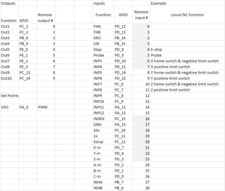

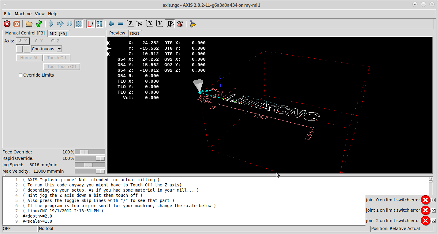

Hi cakeslob: I tried the limit switches according to my instructions. I see them but it shows them on and when I attach the metal so off. All input pins on NVEM are FALSE without connection. I read and tried a lot. But I can't reverse it. I use PNP NC and it looks like the signal is the opposite. I exchanged arrows. He tried data in and out and other different things according to the instructions. I also read the forum but nothing helped. Won't it be that NVEM has Unconnected pins like FALSE? I also tried to use the procedure for realtime but without point. Well thank you.

Ok, thats good domi, if you can see the pins changing state that is progress. If you want to use the new sample config posted by scott, you will need to load the new firmware bin file to the nvem with st link like you did before. the new firmware changes the pin layout , so the new firmware matches the new hal. With the new firmware, you need to change the remo-eth.hal, but to keep things simple , just download the whole folder and keep them both in separate config folders.
The upload config .py file is something new that I am excited for, dont know how it works yet.
Back to the limit switch. if your limit switches change state, that is good. Now we just need to invert the state. Try adding this to the hal part
net X-neg-limit remora.input.2 => joint.0.neg-lim-sw-in-notPlease Log in or Create an account to join the conversation.

I've tried that before : does not exist
- Domi
- Posts: 64
09 Apr 2022 21:23 - 09 Apr 2022 21:26 #239774
by Domi
Replied by Domi on topic Remora - ethernet NVEM / EC300 / EC500 cnc board
So I run the new firmware bin and hal. I didn't move on. Sensors do the same.I can't turn their signal to true / false
