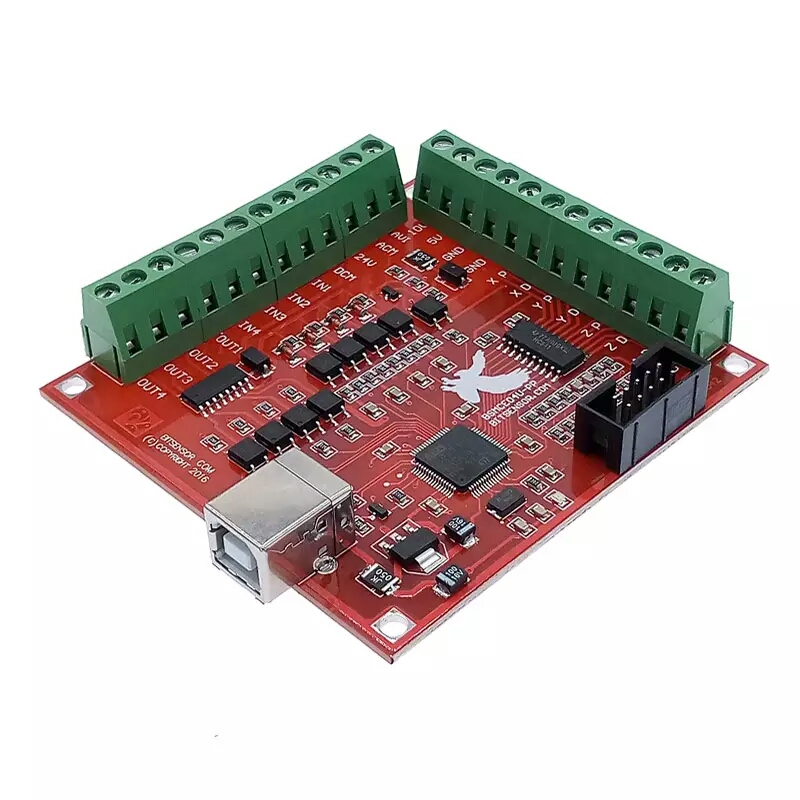

- Anton_RF
- Posts: 1
11 Apr 2022 19:05 #239958
by Anton_RF
Replied by Anton_RF on topic Remora - ethernet NVEM / EC300 / EC500 cnc board
- scotta
- Posts: 959
- Thank you received: 489
11 Apr 2022 21:06 #239973
by scotta
Hi, unfortunately no. The board you show is a USB board, not the Ethernet version which the Remora firmware supports.Are this board is same with NVEM board??
