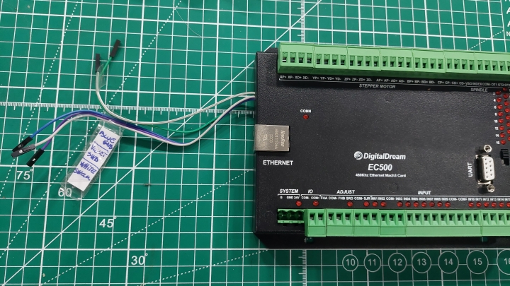

Sorry to bother but in this repo github.com/scottalford75/Remora-RT1052-c...e/feature/DMAstepgen the source has been updated 3 hours ago but the Firmware directory has been updated a week ago. Does this mean that the compiled firmware is not yet up to date?

GeremyL has been doing some great physical testing of the DMA stepgen. Chasing down missing steps, with one theory being the lack of a direction setup time.
The ability to set the direction setup time is now available.
{ "Thread": "DMA", "Type": "DMAstepgen", "Comment": "X - Joint 0 step generator", "Joint Number": 0, "Step Pin": "P1_22", "Direction Pin": "P1_17", "Step Length": 2, "Step Space": 3, "Dir Setup": 2 }, Latest source has been pushed to the repo and a testing bin file as well.

Sorry, my bad. Firmware just pushed to the repo.

Thank you so much scotta. You are really a godsend.
Given the pace of development i figured out I'll need a faster way of updating the firmware so I voided the waranty of my card by punching a hole through it's case lol.
Is there somewhere a diagram of the functioning IO of the ec500 dma for the current firmware?

Nice, mine sits on the bench naked.
No diagram as such, but the configuration file has the details. No changes with the DMA version. There is un-mapped inputs on the MPG header which I've had no luck tracing.
github.com/scottalford75/Remora-RT1052-c...CNC/ec500-rt1052.txt
